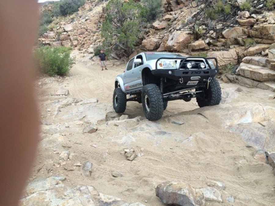

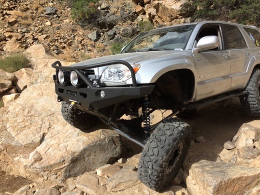

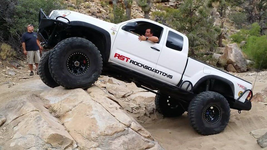

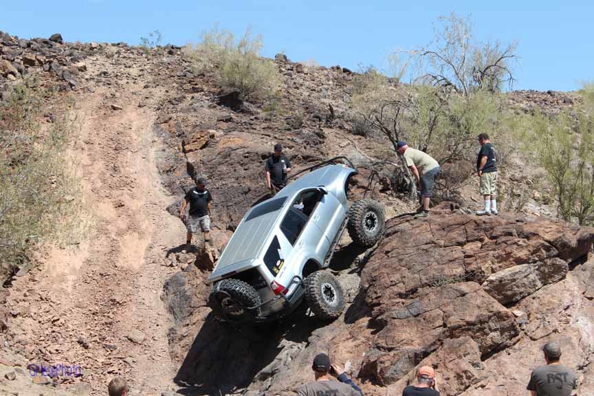

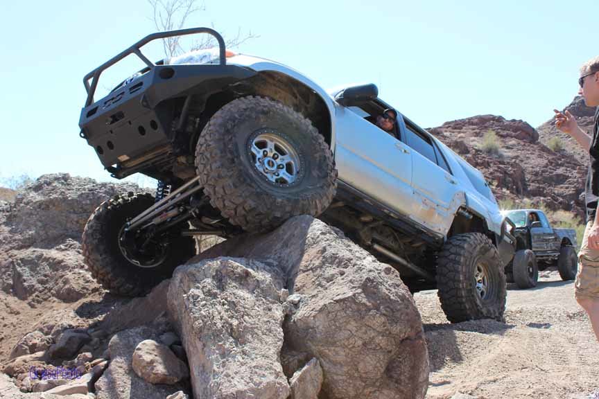

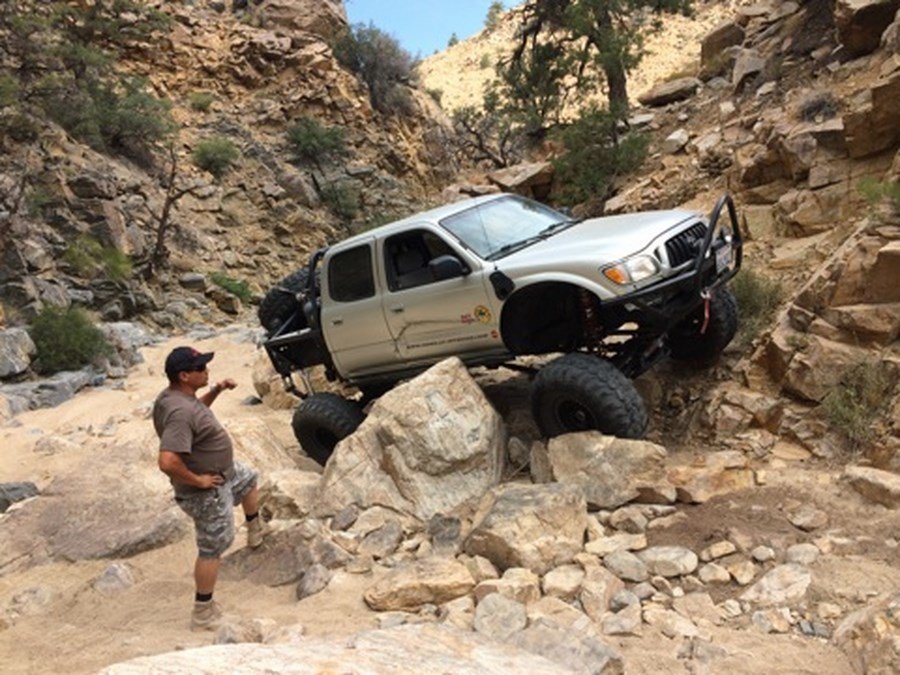

    The rear kit will fit any axle that has a three inch tube with the exception of a Rockwell which has square tubes anyway. I'm not a fan of the Dana 44 in the 2nd gen Taco's. It's just not strong enough when you go with tires larger than 36's in these trucks. Now I know there are a few people who have them but they aren't running huge tires and their trucks aren't as heavy as these 2nd gens are. Almost all of those that did have them under their 2nd gen Taco's have either gone to or are in the process of going to Dana 60's in them.
    A 9" is not a bad choice for a rear axle as long as it's a high 9. The low pinion 9's are really low and would have your drive shaft in a pretzel in no time.
    These kits are designed to work best with a full width axle so that you can have as stable a platform as possible.

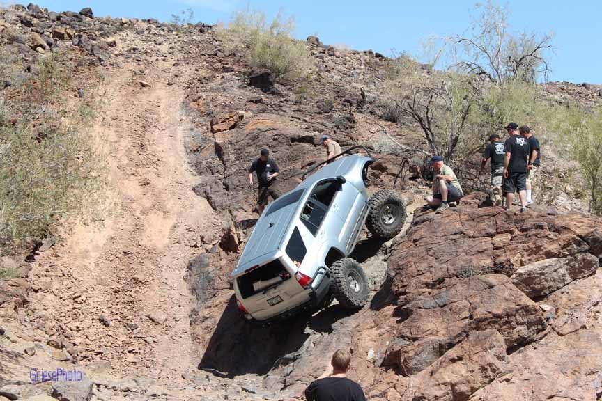

    These are some of the trucks that are using the system that these kits were derived from.
    10389466_579290498858794_288100911208942_c9a86fdebe459d9041bc6c1bbf7a40b706c5f997.jpg
    The twins. See if you can see the difference.
    These climbs were made without the aid of a winch.
    https://www.youtube.com/watch?feature=player_embedded&v=iT0wPMK9C2Q
    All of these trucks are using the same geometry as that of the RST Three Link Kit. And they all do very well on the roads as well. ;)
