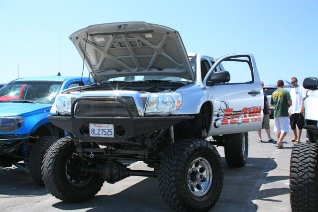

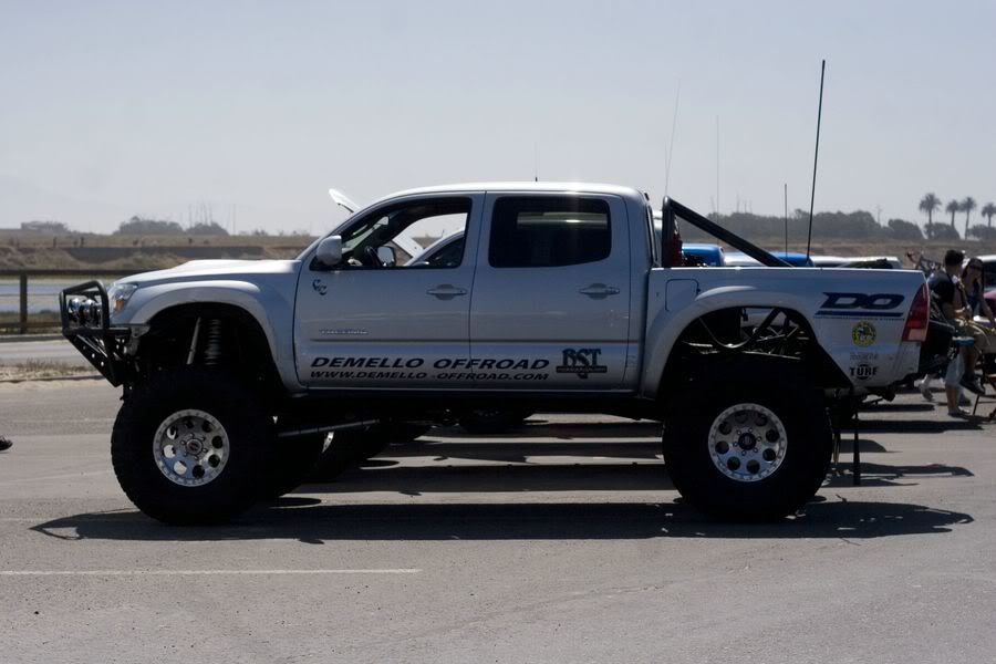

    OK. Lets get you some info you can use. First off, swapping these new trucks from prerunner to 4wd without doing a sas is the biggest pain in the ass.
    You need the list that was put together above, plus the engine cpu's and the tranny cpu's or your going to have codes everywhere. Not only that, you will most likely need to get the instrument cluster as well for the information it contains about speed going back to the engine control unit.
    Your best bet is to sell the truck and get a 4wd OR, you can do a solid axle swap on it and you can use what ever transfer case you want. It's been done already on RockSolidToys.
    http://www.rocksolidtoys.com/forum/showthread.php?t=168
    This big beast used to be a prerunner. Now it's one hell of a 4wd.
    If this is your daily driver I would just get a 4wd truck that you can take to medium trails and not worry about all the headaches associated with doing a swap. And this is coming from someone who does them. If you really want a swap and daily drive your truck it can be done if it's done right. I daily drive this truck 120 miles every day.
