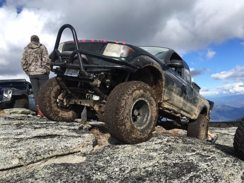

    I'm running a flipped 85 axle, sleeved with 3/8" wall tubing plus the usual trussing and knuckle gussets. I used the ifs style hubs and taco brakes. With the 15x10s and 3.75" back spacing my tires still stick past the bushwacker flares without wheel spacers.

    Very nice truck.
    you might need some mud tires though :D

    Tell me about it haha, 37" Pit bull Rockers are in the mail and should have some weld on bead locks ready to go in the next few days!
    Looking at your build makes me wish I had known more at the time and gone with a 3-link!

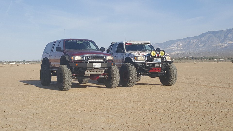

    Building an all toyota SAS truck is not a bad idea. You just need to know that if your going to hammer on the truck, your going to need to spend some money. I built this 1st gen for a friend of mine with Diamond front and rear axles. It's sitting on 39.5" Iroks with RST custom three link front and rear and sits low to the ground. It was a pain fitting that HUGE front diamond axle under there but it can be done.
    Setting up a three link isn't really that hard. It's all I've done in any of my builds and seems easier to me than doing a leaf sprung front. Plus I like the ride better. I know, you can make a leaf sprung truck flex just as well as a three link...... But I just like the ride and adjustability better with a three link suspension.
    13166021_935879389866568_803774147093800_1679cb1e76685d94201c8316d915964d0d48a0a1.jpg
    Here it is sitting next to another Tacoma on Toyota axle's but it's on 37's and is using the 8" front diff instead of the 9.5" front and rear diff on the truck I built.

    Wyatt do you have a writeup on that build? whats the frame height?

    I don't have a build thread for it yet but I will post one up in the next couple of weeks.

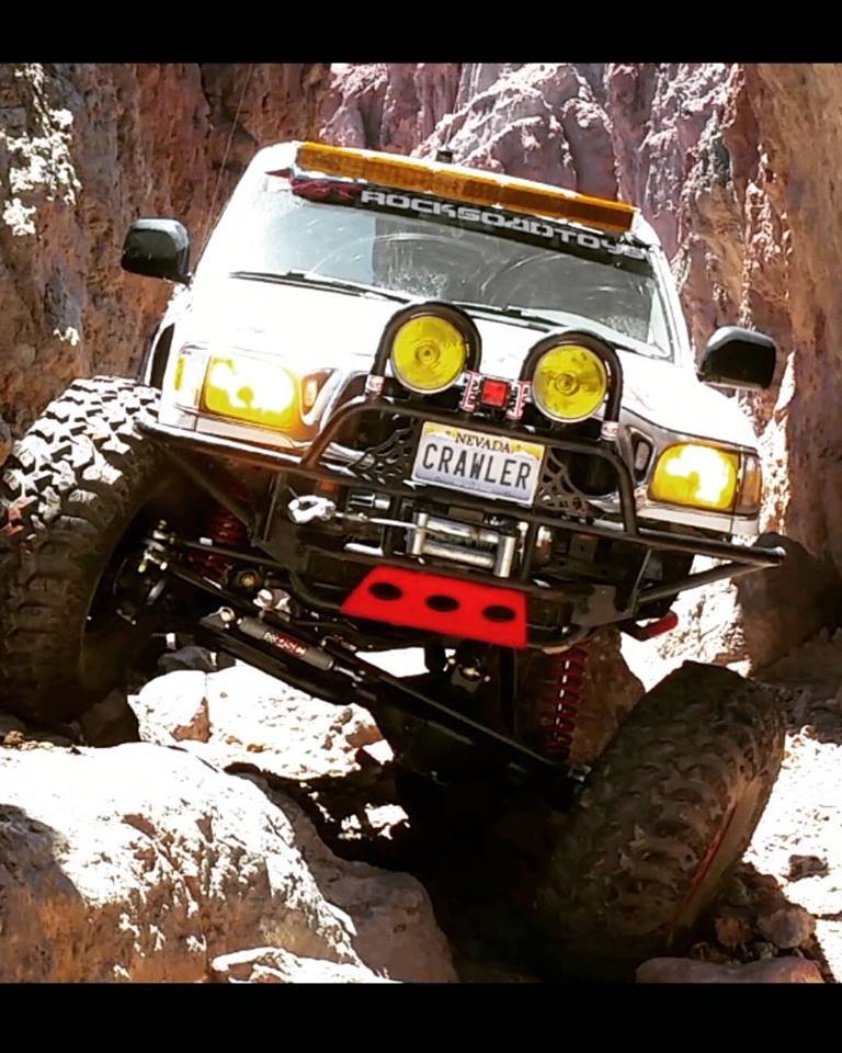

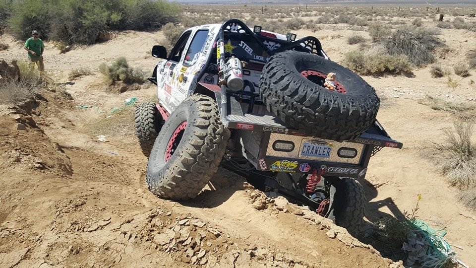

    I'm not sure your entirely correct there. I've daily driven my Toyota on tons and 40's for years not to mention my tons have better clearance than a stock toyota rear does and they are both high pinion. Then, I still have my FJ Cruiser T case with the Marlin Crawler Taco box neither of which have ever broken in my 6,184 lb truck on 41" tires.
    They 1st gen in the picture above is also daily driven as well as this one here.
    I drove 70 miles in one direction for two years with my beast 5 days a week, then wheeled it on the weekends and drove back home. It's been driven to tahoe to run the rubicon trail three times from Huntington Beach california and back and has been driven to Phoenix Arizona so many times I can't remember the count and driven back home to Huntington Beach. It was taken from the show room floor in 2005, built and driven from then on. It now has 67,000 miles on it and still climbs like a mountain goat and takes my wife to the grocery store.
    https://www.youtube.com/watch?v=dqcFHFY2TNg
    Plus if you gear it correctly, like we have with these trucks, you'll still shock the folks in the other lane as you keep up with them. And I'm on 41's now.
    https://www.youtube.com/watch?v=7B6rJ5eXQfo
    So not only can I drive it on the freeway and my wife takes it to the grocery store it also can go just about anywhere I want it to.
    https://www.youtube.com/watch?v=jgHeMpkLNZU
    You can have your cake and eat it to if you know what your doing.
