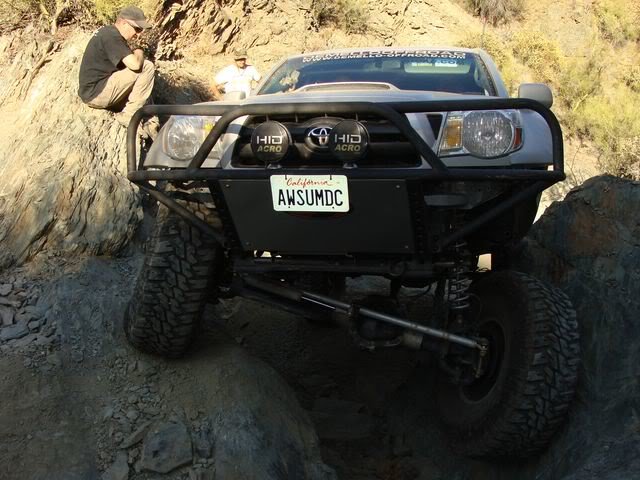

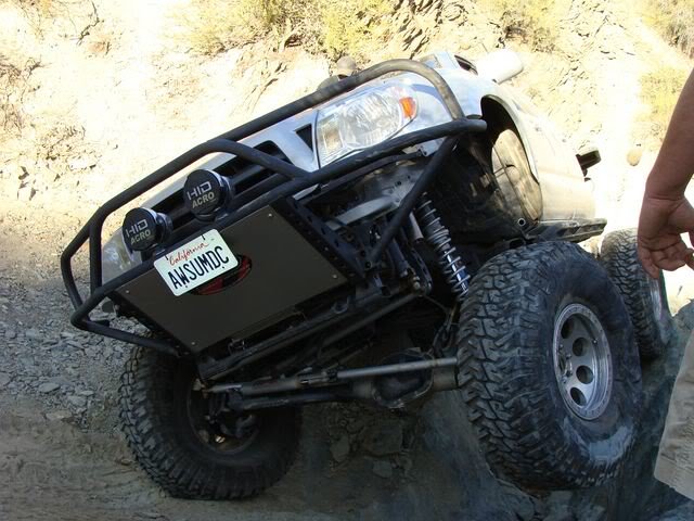

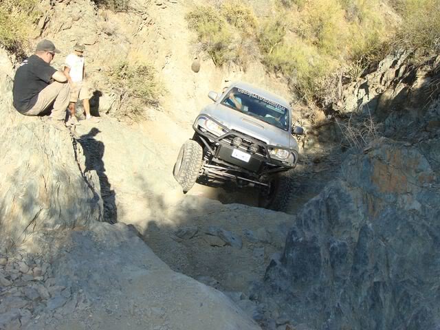

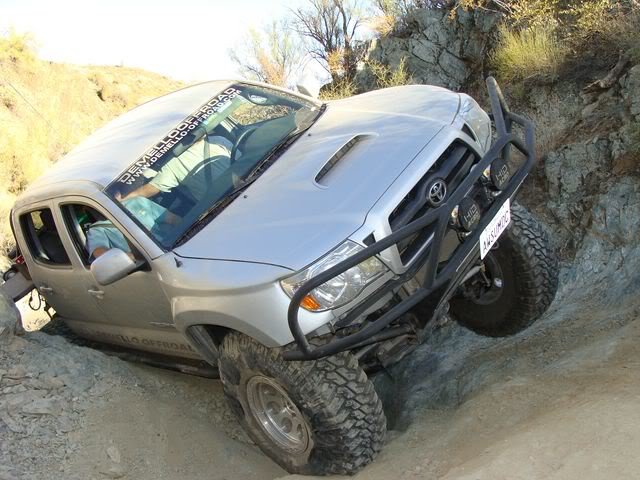

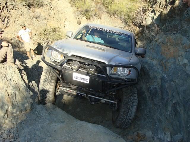

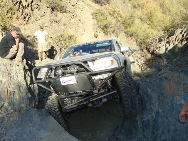

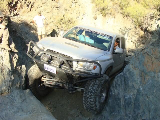

    awsumdc
    awsumdc Well-Known Member
    Jan 3, 2009
    #12156
    1,674
    O.C. Cali
    SASED '05 Taco

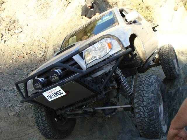

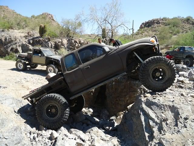

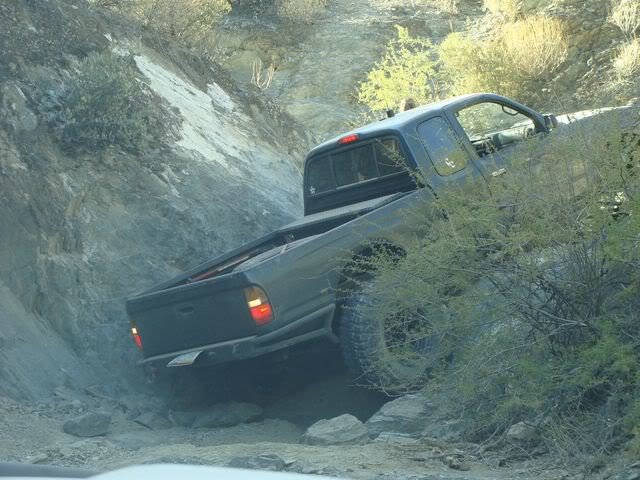

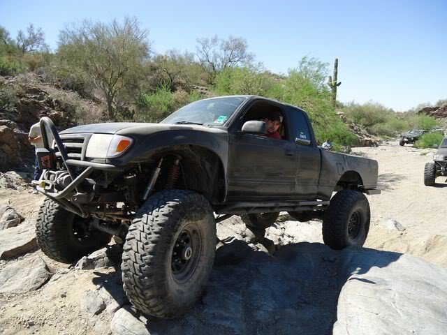

    SAS, crawler box, 14" coilover shocks, 39.5 tires,dual batteries, and a bunch of other stuff
    This truck is a daily driver and these axles are toyota based but bigger than my Dana 60 derived axles. The Ring and pinion are 1/2" smaller than mine but the overall axle is not only bigger but heavier as well.
    This was a daily driver on Tons and 40's. But not only tons. It has a 14 bolt in the rear.
    Another 1st gen on Dana 60 front and 14 bolt in the rear on 40's that was daily driven.
    And one more 1st gen on dana 60 front and 14 bolt rear always driven to and from the trails and daily driven sitting on 40's. And this one is the 4cyl.
    I'm just saying that if you build them right you can get it to function the way you want it too both on and off the road with some compromise. Oh, and mine is just as nimble as any 1st gen out there.
    1st gen in front of me.
    Me coming up after the 1st gen.
    tacomgee, Nickel and malburg114 like this.

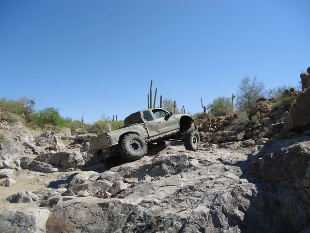

    1999RegCab
    1999RegCab Well-Known Member
    Apr 4, 2014
    #127007
    1,522
    Cacti Land, AZ
    1999 Reg Cab, 2.7, 5 speed
    3-link SAS
    That 1st gen with Diamond axles front/rear is not a fair example of an "all toyota parts" project. First of all, that thing is totally custom; far from your typical budget toyota parts build. I bet it has over 10 grand in axles alone. Add suspension parts, tires, duals, coilovers, suspension, etc. and I bit it gets closer to $20,000 in parts alone.
    I put that out because some guys get carried away with pics of trucks like that thinking they can build their truck similarly with "all toyota parts"; not realizing that the truck in those pics is an expensive an expensive custom build. Long gone are the TTORA days when guys where really building awesome rigs out of junk yard parts with small budgets relatively speaking. Then everything changed and people really started building custom-over-the-top rigs like that white tacoma.
    Good point about building a rig with tons and big tires. Yes, you can have your cake and eat it too :D I have a 4 cyl with big axles/tires. You just have to adapt to the fact that it is a heavier and slower vehicle. Personally, I think tons is the way to go. Those are the last axles you will ever build.
    This obsession with lighter axles is out of proportion. Many guys don't even know what they are talking about LOL. Most people change their opinions immediately after wheeling a rig with full-width 1ton axles with big tires for the first time. It's a whole different experience.

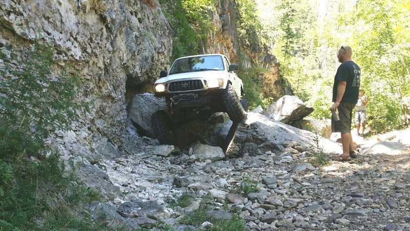

    slander
    slander Honorary Crawl Boi
    May 10, 2013
    #103909
    8,964
    Hickory, NC
    02 Tacoma, fixed with curse words.

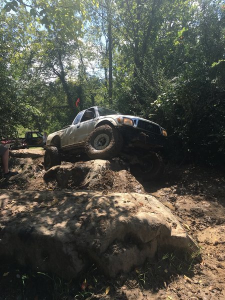

    ^^Here hacked together out of junkyard parts, free front leaf springs, all built with a flux core welder and will do 80mph all day on 9.5" cruiser axles. Driven to and from the trails and i have less into the whole sas than the white truck has in the front axle.

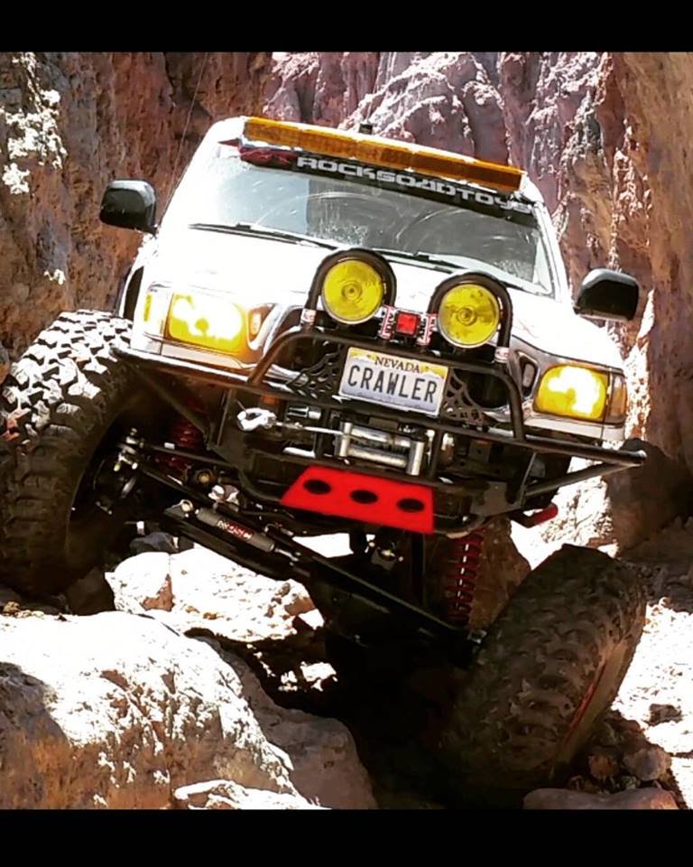

    malburg114
    malburg114 Well-Known Member
    Dec 26, 2012
    #93766
    3,774
    Las Vegas, NV
    2001 Toyota Tacoma TRD

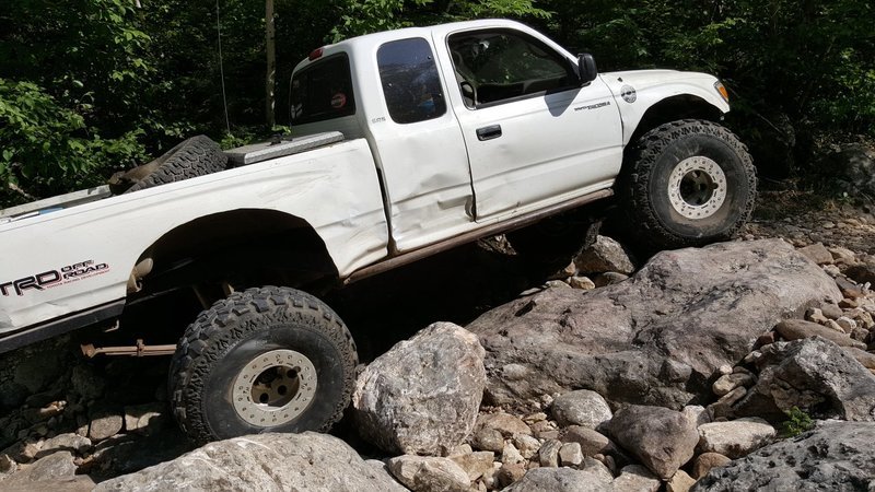

    Im happy with my Tacoma on all toyota parts and 35s :notsure: Do I want 37s? Yes but there not real pratical for daily driving and 40s are even worse in my head just because of how much they are and the wear the street puts on them. Can you daily drive on 40s? Sure, you can daily drive anything but you have to think about how pratical it will be and the wear and tear of driving that truck everyday. Im all for driving my truck to and from trails but I did trailer it from vegas to tahoe for the rubicon and am happy I did because I ended up breaking a major part and wouldnt have been able to drive it home safely. So trailer queens have their place.
    But the real lesson I learned after I finished my truck and did some local trails, was that I was so caught up in the internet and what others had that I was already shopping around for tons to start building until I went and did Marlin Round up on the Rubicon. Just about every toyota there had: toyota axles, 35s, old worn out leaf springs front and cheby 63s in the rear, no hydro assist, and for the most part all looked the same. Why did they all look the same? Because it simply works and after that I just learned to love my truck how it is and enjoy it and beat on it till I find a reason to upgrade. The few rigs that did not look like the others where some of the big builds you would read on here or pirate (Like breynolds or bayareastaco) and they were far and few. For now this has turned into any other thread on tw and where just :deadhorse: here. But its different than the regular one so Im okay with it haha. And this is all my 2 cents for the guys wanting to do this reading. Probably doesnt make any sense.
    And a picture cause SAS Tacomas are cool. And dont get me wrong Wyatt. Those trucks are awesome but are way over built for the average joe toyota owner. Cool non the less.
    [​IMG]DSC_1000.JPG by Harrison M, on Flickr
    One thing I would do differnt was get an atlas. Having to much trouble with the auto tranny leaking into the tcase... Tired of changing the seal. Anyone want 2.28 crawlbox with 4.7 tcase? Passenger drop? :anonymous: Haha just kidding.

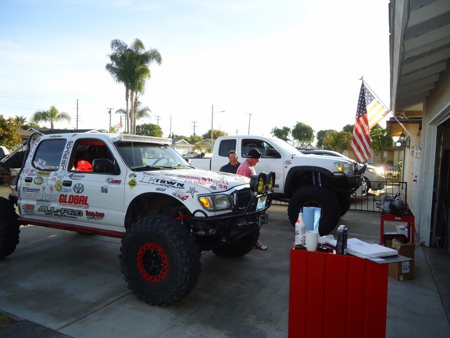

    awsumdc
    Jan 3, 2009
    #12156
    1,674
    O.C. Cali
    SASED '05 Taco
    You are correct on all points with the white rig. I changed the front geomerty on it three times before I was happy with it and gave it back to the customer because he wanted to keep it low but run 40's. Building that truck was like trying to stuff the workings of a simi truck into a pinto. Putting those huge tires and monster axles under that think and keeping it low was a MAJOR pain.
    I do miss the days of TTORA when folks just cobble together stuff in a weekend and then went wheeling. But times do change....
    The other two trucks are just that. Former TTORA guys that built their own trucks from junk yard parts. And they still wheel them.

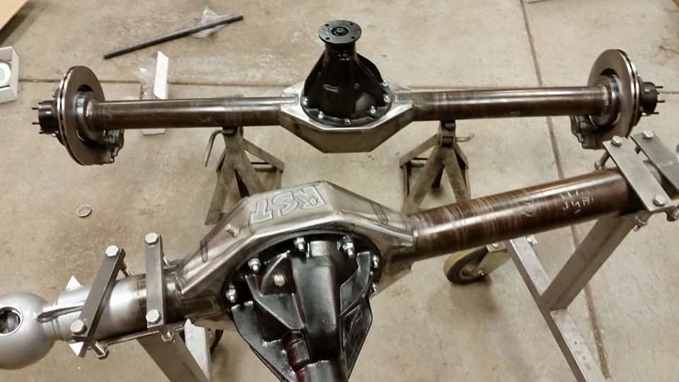

    Front Range Off Road
    Front Range Off Road Well-Known Member
    May 4, 2015
    #154513
    83
    Brian
    Formula Toyota
    Not sure where you are getting you numbers Wyatt.
    -9.5" is only 1/4" smaller than than the 9.75" d60 ring gear
    -9.5" front, complete, with steering is under 400 pounds, where a Currie rockjock, WITHOUT steering is 500, so over 100 pounds less on the Diamond
    -the 3.5" tube of a Diamond may be larger than what currie uses, however, the clearance at the diff is better with a 9.5" center than the tightest shaved d60.
    For overall weight comparison. My Tacoma was 3800 pounds, dual case, 37s, with 8" Toyota based front axle. When it went to 42's, steel beadlocks, 9"/d60 hybrids, and full cage, it hit 4700.[/QUOTE]
    allenfab, Ritchie and malburg114 like this.
