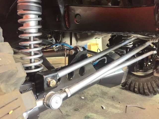

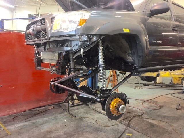

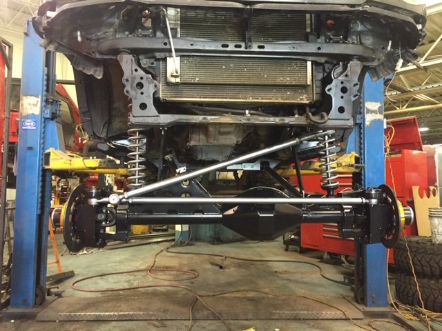

    a couple things
    Everything painted up and re installed , still need to modify front bumper , bit of wiring , add fluids , set coilovers for ride height , and some test driving ..

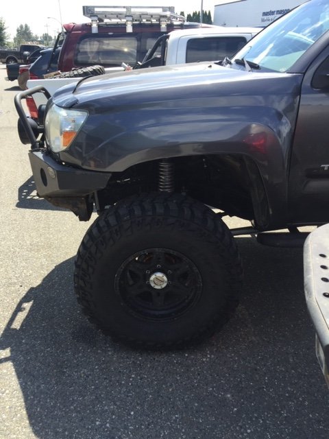

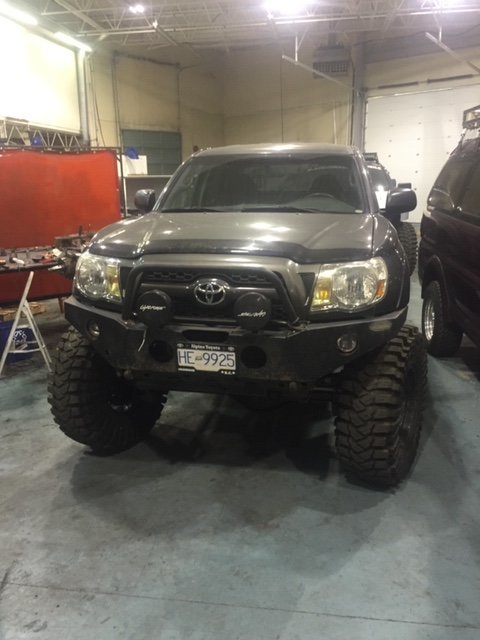

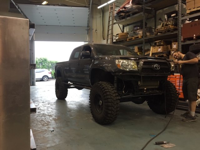

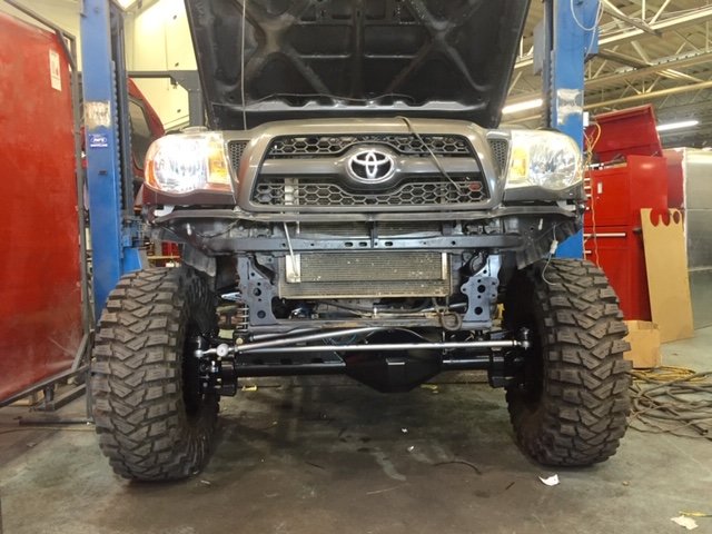

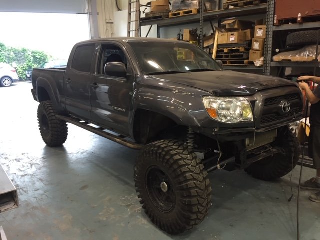

    IMG_3440.jpg IMG_3441.jpg IMG_3426.jpg IMG_3488.jpg IMG_3601.jpg IMG_3603.jpg
    Finally its allowed to see some sunshine ! we deleted the 37" treps they rode like square tires and installed some cooper stt pros 100% better , on a few since this sas we have built up a new brake system this rotor set up is not very good for street use but is what came with the roller kit . we made some custom brackets , used a 3/4 ton vented rotor and caliper much better ! next thing on the wish list im not stoked on the steering pump set up even with hydro assist its very lacking , its on the wish list of coming up with a high volume pump kit set up for it hopefully in the near future ...
