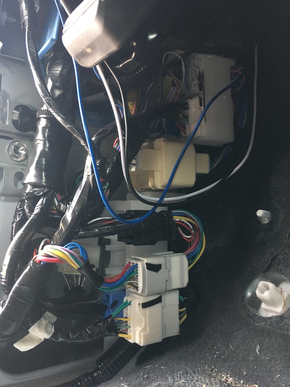

    Can anyone tell me what I’m looking for? thanks guys9D52C3C0-BEC0-4547-AEFB-0426C7B7027E.jpg

  9. Jan 27, 2018 at 10:38 AM

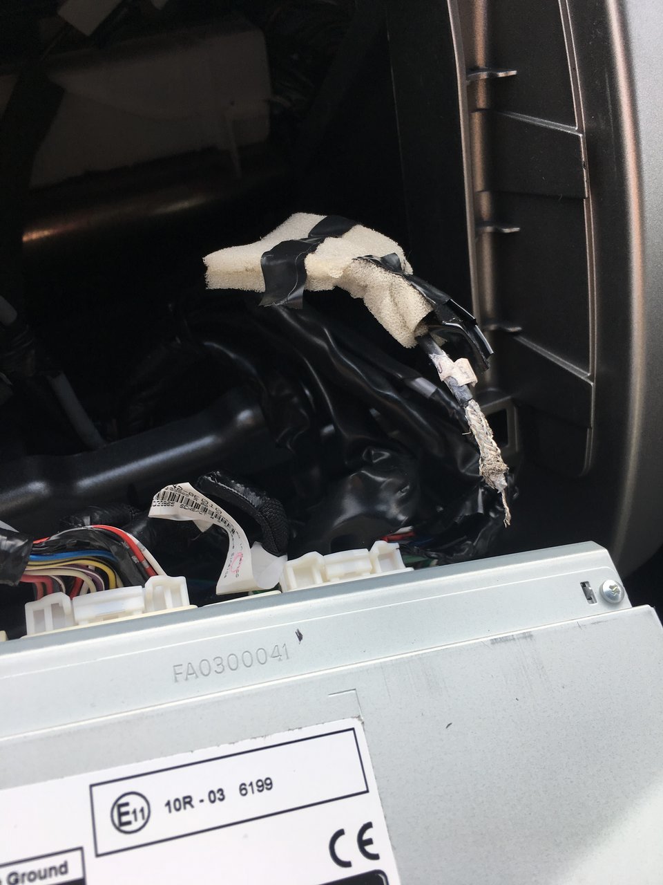

    Ok tearing apart now this is the wire behind head unitE3236F72-58DC-44F3-A49A-3F04CA653FB4.jpg

    Damn guys that wire behind head unit is tied into the whole harness of other wires and I can’t seem to find any plugs like that in links behind kick panel..I know the previous owner had a system and new head unit in here I hope more things arent misplaced that are already what a headache haha

    So no plug like that in the kick panel? And your truck does have the shark fin? Might be easier to just put sat antenna under the dash, top of the radio?

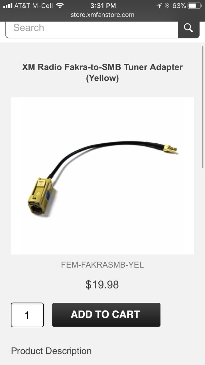

    I read the other thread you gave me..So you guys think this plug would work to connect into my radio and other end to Sirius antenna wire??AA544AC7-4CCF-4372-8259-DE318A52D7DE.jpg

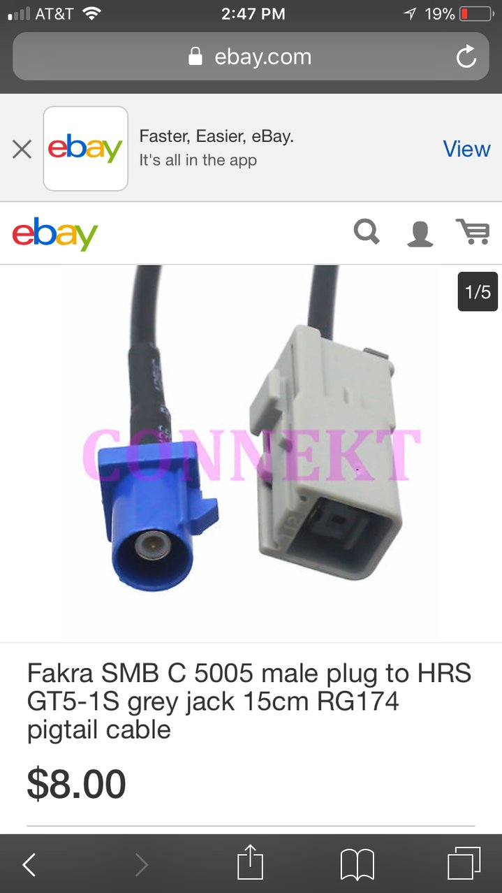

    Factory to factory, I don’t think so.
    Take a look at the connectors in these threads:
    https://www.tacomaworld.com/threads/2009-tacoma-satellite-antenna-location.11978/
    This is a square connector connecting to the sat antenna module. If you look at the TSS aftermarket deck to factory antenna adapted, the actual plug is square on the sat side.
    If you look at the pictures half way down in this thread:
    https://www.tacomaworld.com/threads/satellite-radio-antenna-adapter.184477/
    They show the back of the deck is also not round. The round connector is what aftermarket decks/antennas use.
    Seems unlikely to find a wire to connect both off the shelf except from Toyota, as there would be no market or purpose since the trucks already have them. What I could maybe see though is:
    -OEM antenna (square) to aftermarket deck deck (round) wire
    -OEM deck (square) to aftermarket antenna (round)
    Get a female/female adapter to plug the 2 above round wires together to make the connection.
    Other options would be soder a new connector onto your existing cut wire. Or there is a company that makes custom wires for this stuff, to-order. I’ll see if I can dig it up.
