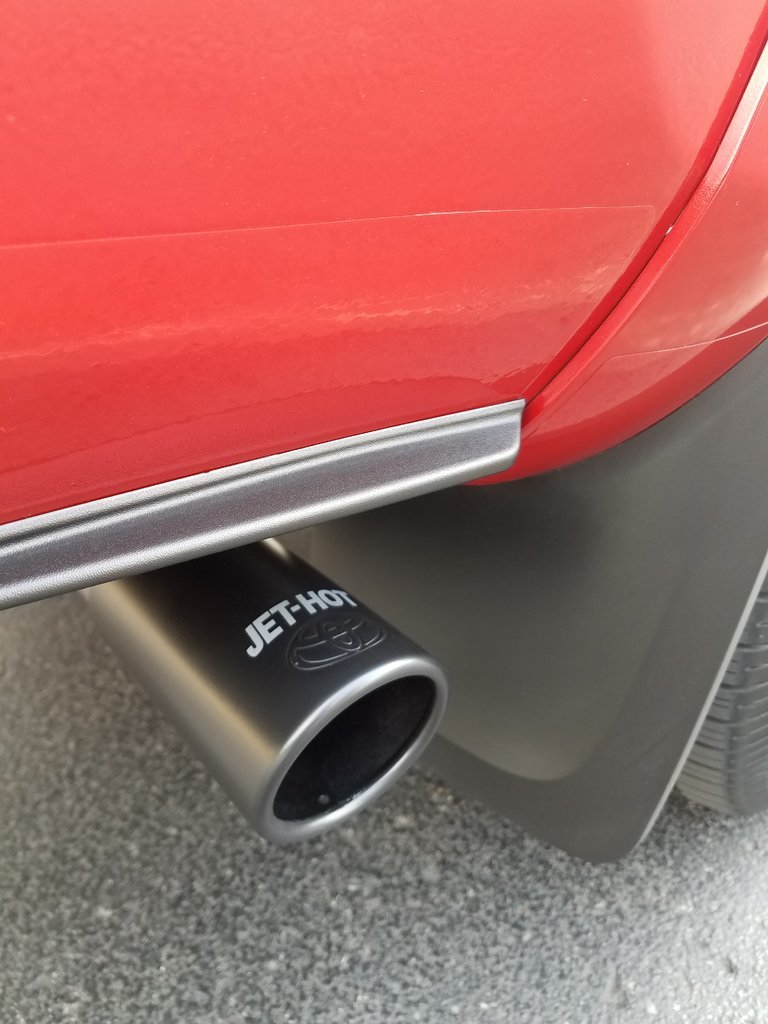

    I'd would personally like to see it without the the coating company logo and will the Toyota logo in white.

    Did you just paint over the chrome tip?

    What brand did you use?

    Duplicolor GM Low Gloss

    Rustoleum high heat ceramic black is the most dull I've seen I just repainted mine with it and I'm thinking of going satin , that or clear coat.. it's dark now but I can take a Pic tomorrow if anyone wants to see . It looks pretty good it was already black but I dunno what it was probably toyota but I honestly don't know it has no markings that I remember seeing. But the can does not say flat or satin if it does it's so small I can't read it but it the high heat ceramic 2000° from autozone it's like 15$ a can they had another that was 600 I believe it was the engine block black

    I did this to my chrome TRD Pro tip. I used the Rustoleum High Heat Satin black and it worked great. Just used some steel wool to rouch up the chrome a bit before you paint it. I ran it for 3 years and it still looked great.

    Turns out what I used was flat high heat rust oleum .. it look like black dust or powder the color is not very deep but it looks good I'm not sure if it came this way or was just painted but I scuffed it up with a real fine sandpaper. I will probably try satin next time it almost looks like a dull plastic almost not so much like metal.

    I've pasti dipped exhaust tips on 2 of my last cars, I'll fo it on this one eventually. The exhaust tip is so far from the engine it doesn't actually get that hot.

    I like mine gloss black like it came matches my gloss black overlays on my emblems.
    All though flat, satin or semi gloss all look good and I have had Jet-Hot coated headers which is a very good product.

    I've used the Rustoleum BBQ High Heat Satin Black paint and it lasts up until you take a long road trip. I took a 900 mile trip in 2 day and it burned the paint off. Done this twice now. Works fine for my normal commute.
