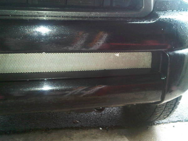

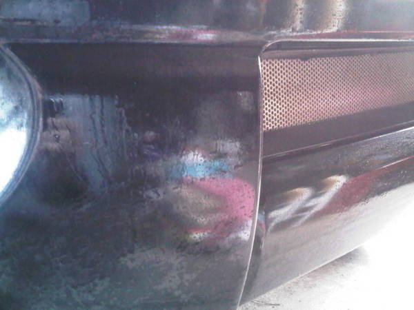

    Here is some better pics of the BUMPER piece for the Satoshi GB Mesh...
    My Truck:
    (obviously this pic is from before I put the triangle pieces in...)
    closer:
    Another:
    And Another:

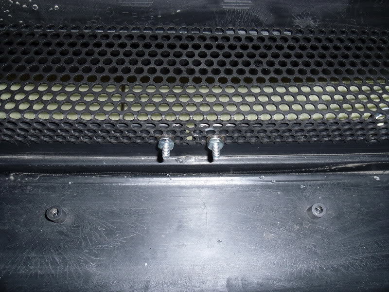

    From the inside...
    As you can see, this in NOT an insert...
    I removed all of the plastic cross pieces & formed the mesh to attach from the BACK of the bumper.
    The best method I could come up with to install this was zip ties on the ends and 4 screws into the top of the opening to hold it on.
    This post is for those of you who are interested in matching the bumper to the grille and/or scoop.
    It will probably take longer to do this then install the satoshi insert on the main grill...
    I wanted to get full disclosure on this so everyone that has committed to this knows EXACTLY what is involved.
    Read post #17 for great how-to info & pics by alanmeyer!
    Feel free to post any questions!

    To clarify, this is not reversible when done, correct?
  5. Mar 31, 2011 at 8:25 PM
    HomerTaco
    HomerTaco [OP] All up in your GRILL Vendor
    Mar 28, 2010
    #34129
    37,450
    Craig
    Bucks County Pa.
    four sticks, dual cases, zero fucks...
    Core-Hurst short throw shifter & T-handle / Carbon Fiber Interior / custom console light / De-badged / leather interior / Heated Front seats / Red Line Hood Struts / Painted speaker grills /one-off TRD Satoshi Grill with 12-15 front-end swap/ Pioneer AVIC-X920BT HU / Scangauge II / Black LED Tails / Dash Mount for iPad mini / Safari Snorkel / Auto-pilot mode / Leer 100XQ Cap / 4x Innovations sliders / Rear Diff Breather Mod / front windows tinted to 35% / Brute Force Fab Hybrid Front Bumper / BAMF Rear Diff Skid / Budbuilt Skids / CBI Trail Master 2.0 rear hybrid bumper / Fox rr coils/ TC UCA's/ TC spindle gussets/ TC Cam Tab gussets / Dakar leafs / Defined Engineering shackles / All pro U bolt flip / Timbren Rear Bumpstops / BAMF LCA skids / Exhaust re-route / Fog Light anytime Mod / LowRange Off Road extended rear brake lines / ATO Shackle Flip / sectioned Bushwhacker flares / re-geared to 4.56 / ARB Front & Rear Locking Diff / ARB CKMA12 compressor / PrInSu full rack system / 1" body lift / Inchworm 4.7 crawlbox / twin stick FJ t-case / Davez off-road triple-stick kit/
    You could remove the mesh, then there would just be an open space in the bumper...
    The bumper "grill" can't be separated like the upper grill can.
    I know this because I disassembled the entire front end when I first completed the Mod.
    Why would you want to reverse it anyway?

    As far as "removing" the bumper pieces, i havent looked at it yet but how exactly did you remove them?

    The handy dandy Dremmel Tool! :cool:

    Can you provide more details about this? Specifically:
    (1) Do you have to remove the bumper or did you make all your mods in place?
    (2) Once you dremmeled the old insert out, did you need to fill any gaps or touch up any paint?

    Once you cut out the bumper insert do you need to fill any gaps or touch up any paint?

    Yes, there will be two slots to fill in on either side... There are some small slots left on the top, but I used them to fasten the mesh with a few screws...
    I took the damn thing off the truck to do it...:rolleyes:

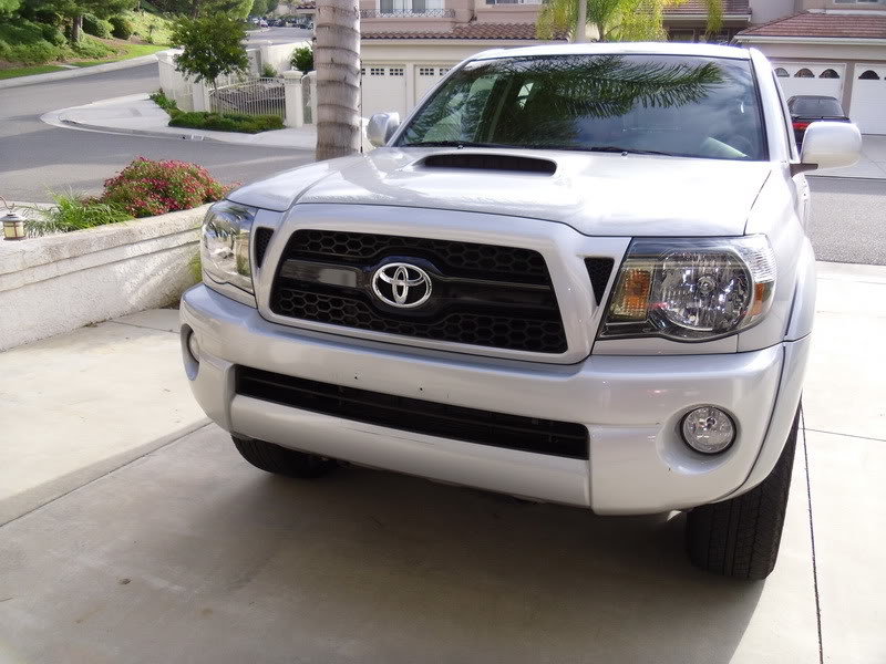

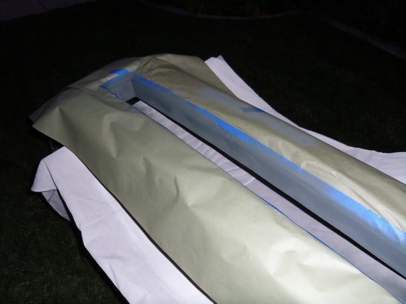

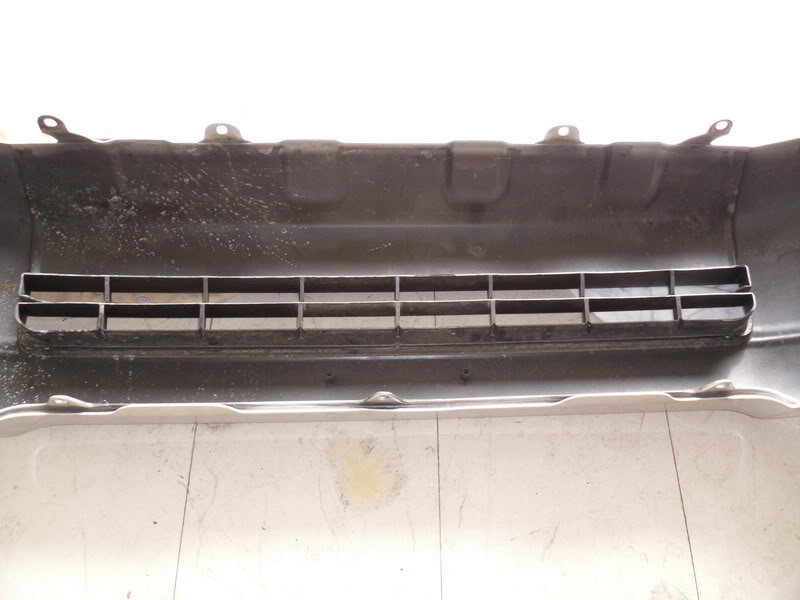

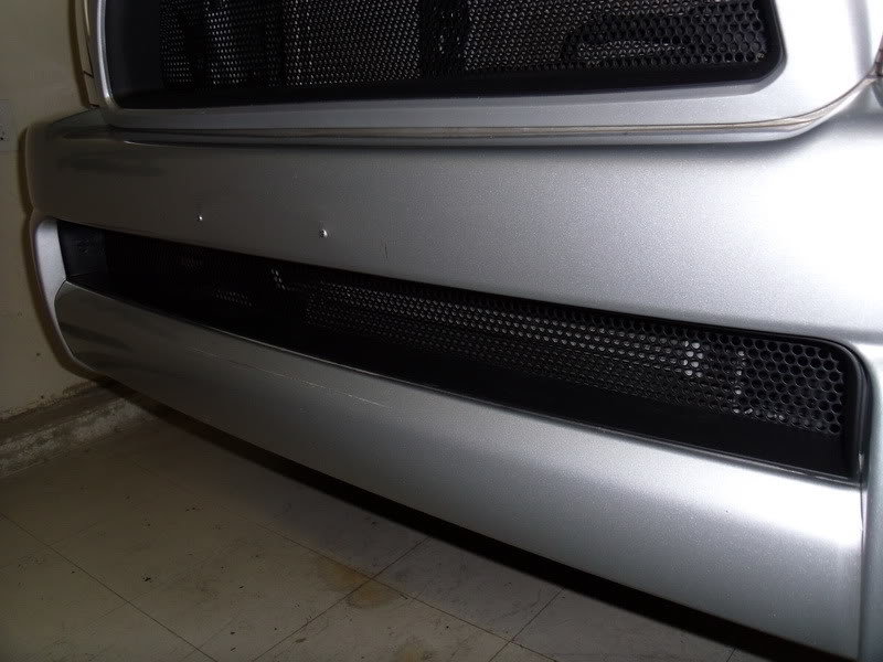

    Ok, I finally took the plunge and did the mod/install on Saturday. I got the mesh from homertaco (thanks, Craig!). It wasn't too hard, but it took me most of the day due to having to look at the pieces and figure out what I wanted to do, not to mention things like epoxy/glue and paint drying time.
    Here was my starting point:
    Below is the result:
    -- Apologies for the poor lighting. It was dark when I finally finished!

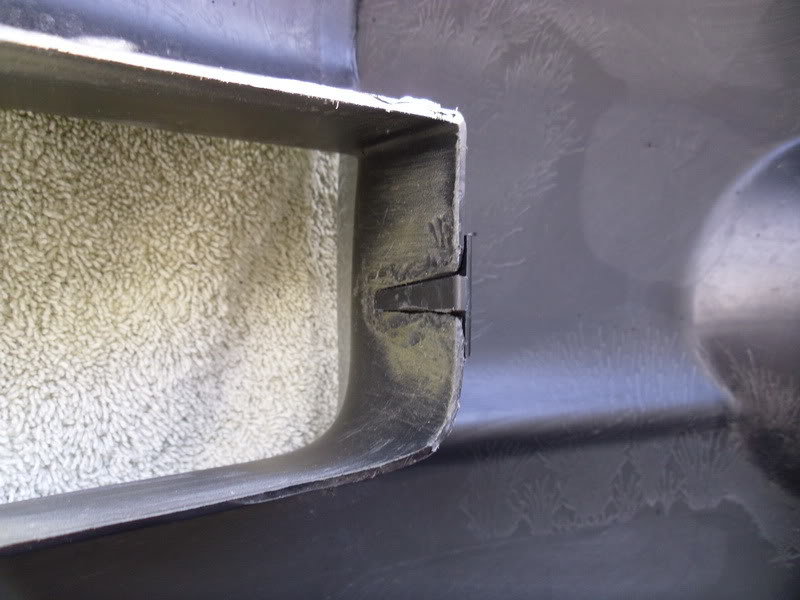

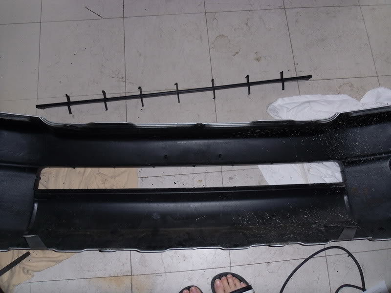

    Below is the backside of the bumper. As you can see, the 'insert' isn't an insert at all. It's just a part of the bumper that goes unpainted.

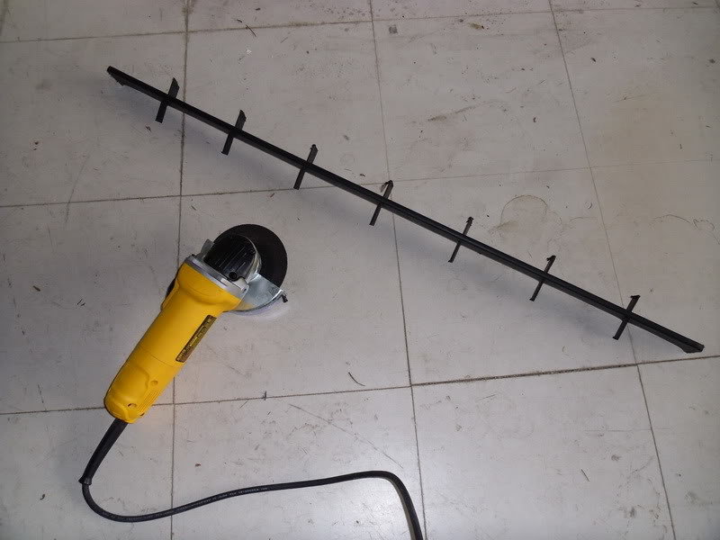

    Below is the bumper immediately following the removal of the inner piece:

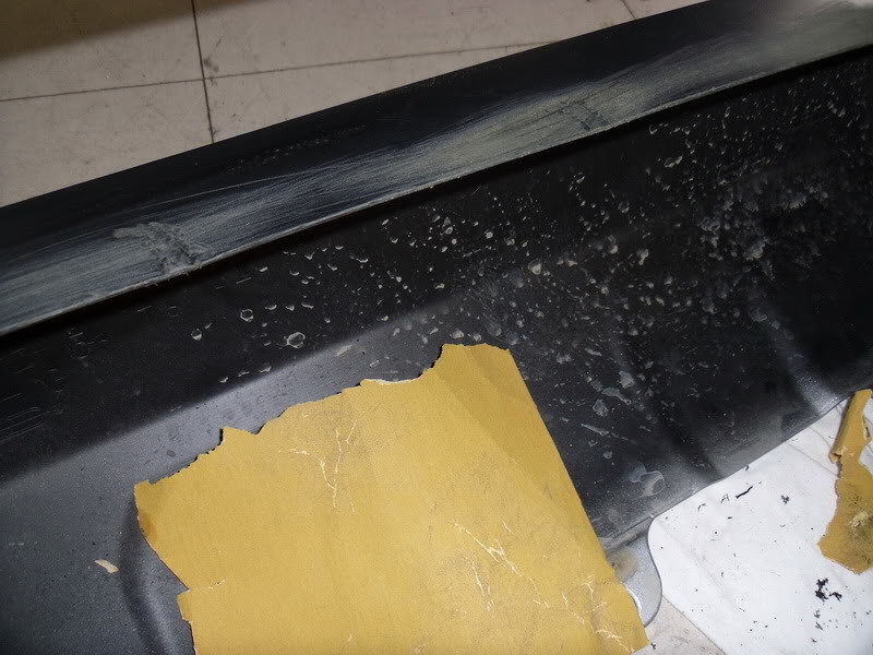

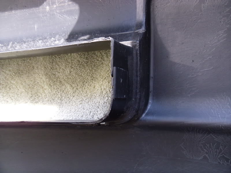

    Also, a dremel works OK, but not at these angles. Instead, I used my angle grinder with a cut off wheel. It went thru the plastic like butter... just need to have a steady hand!
    It took a bit of sanding to get the surface flat:
    Here's the side, where there is a pretty large hole left over. I recycled some of the inner plastic to 'fill' the hole since the thickness was pretty close. It's actually 2 pieces - 1 to roughly match the size of the hole, and a backing piece to give it better structure/support. The pictures below shows it just after I glued the pieces together. I filled the remaining gap with some gorilla glue. After letting it dry I was able to sand it down relatively flat.
    The next step was paint. The image below is the etch primer I used. The only color my local home depot had was 'green' etch :(, making my painting a 2 step process

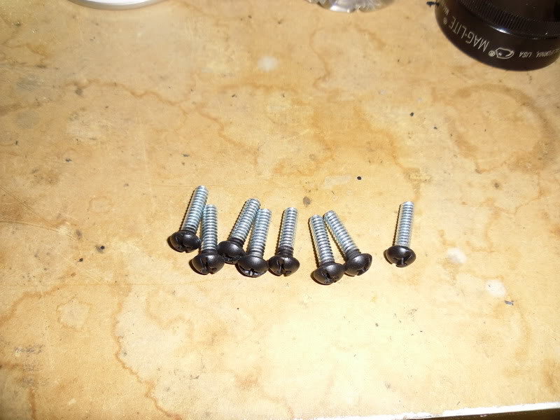

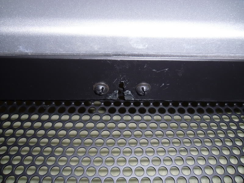

    While I was waiting, painted some screws black too. I used these screws to fasten the top part of the mesh to the bumper. I ended up drilling new holes to match the locations on the mesh.
    Another comment is that since the bumper is curved, that you also need to curve the mesh. It's not too hard to do, but it's tricky because the top half of the bumper is not as deep as the bottom half. That makes it harder to get the screws to mount into the bumper and mesh.
