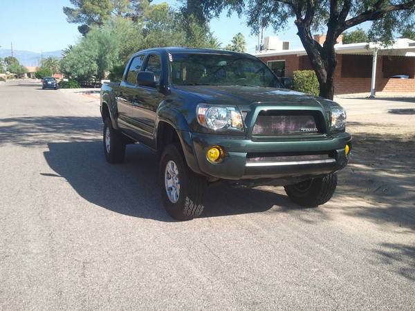

    How sturdy is the mesh from custom car grilles?

    Its holding up great so far.. The tape that came with the fasteners didnt hold so well so I ended up using Gorilla glue and now that things going nowhere!
