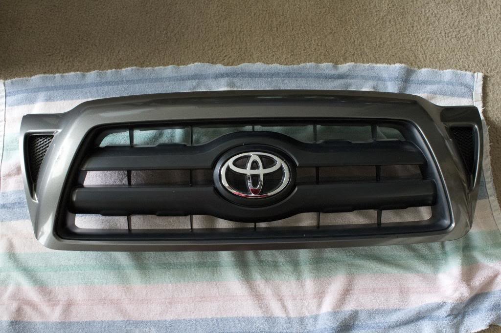

    WOW! Finally done with this monster of a project! Just want to start out by saying that, I had ZERO experience with the Bondo, Resin, and fiberglass... To anybody attempting this project with little to no experience, BE WARNED! It will take a week or so, depending how good you are and how much time you have... What I did, so I wouldn't be driving around for a week without a grill, Is order a paint to match replacement grill online. Got it for around $50.00 on ebay... Which was much lighter than the truck...

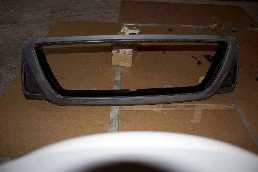

    Got the Replacement Grill in the mail... Broken of course...

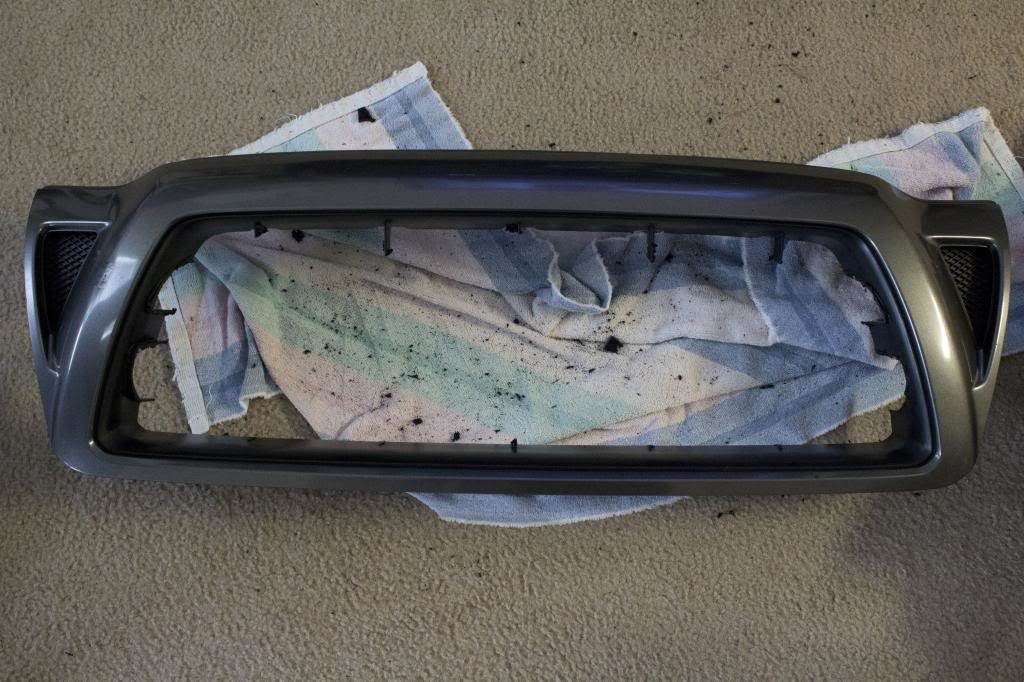

    About an hour of dremeling
    Dremel got a bit hot...
    Cleaned it up with sand paper and dremel

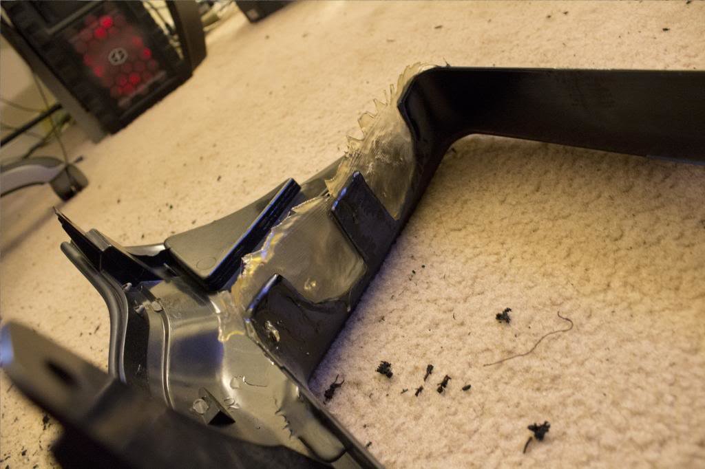

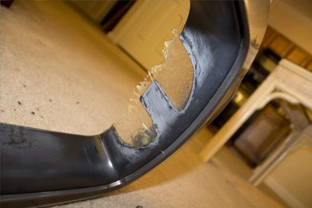

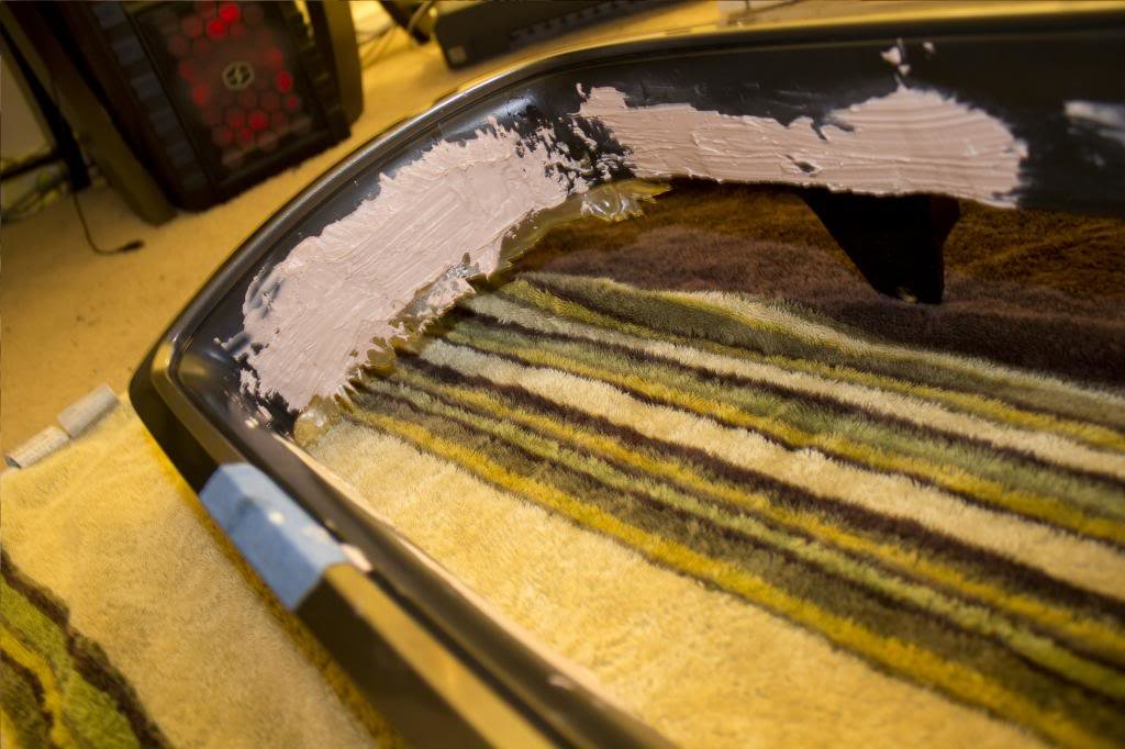

    Next, I used the fiberglass repair kit to fill in the gaps left by the old grill

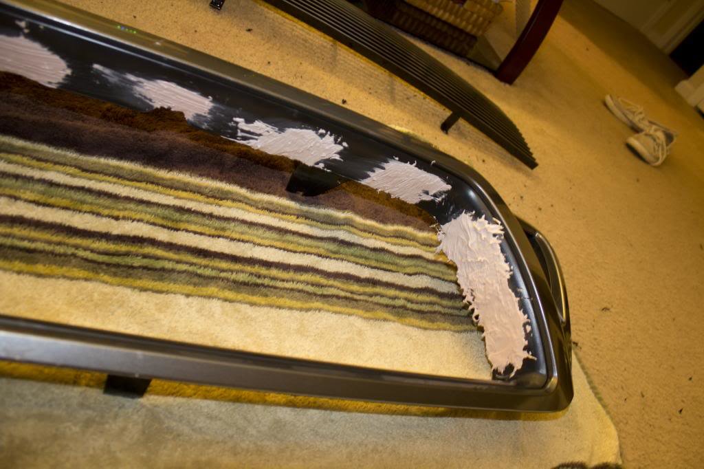

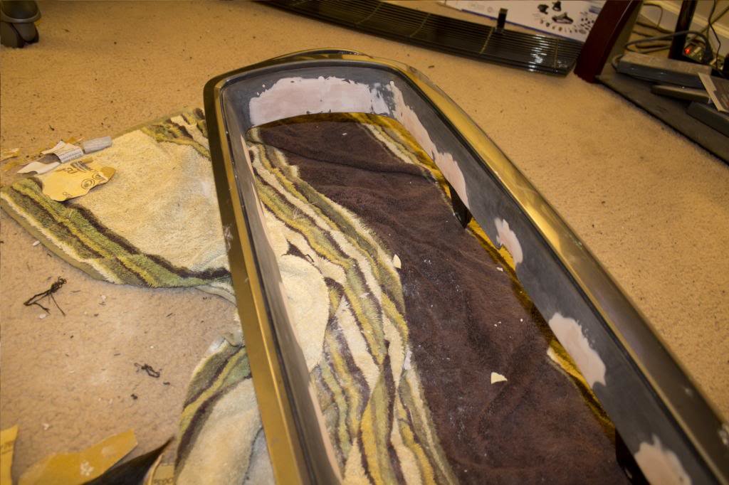

    Next, I applyed the bondo in the areas that needed it... I applyed it very Generously. Here is a tip: Don't go over board with the bondo right away. Be patient and use several layers... The smoother it is before you sand, the less you have to sand...

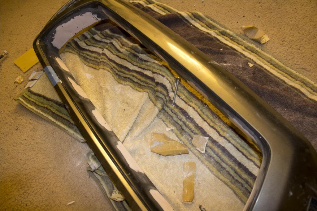

    Sand... Bondo... Sand... Bondo... OVER AND OVER AGAIN!!!
    There we go! Silky smooth!

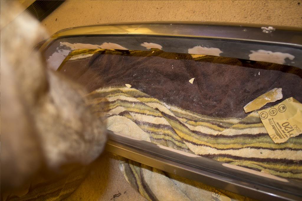

    Damn Dog...
    But he is a helper...

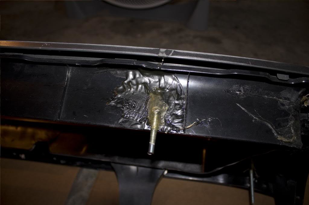

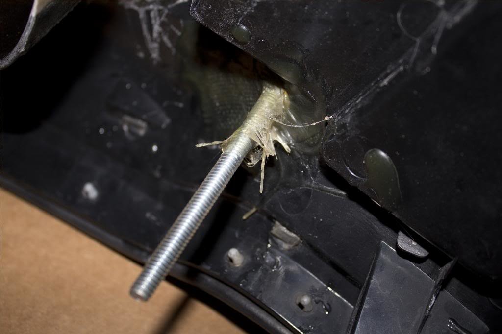

    Also, This is how I attached my screws. I held them on using the resin and fiberglass repair mesh. It could probably be cleaner, but I dont really care since nobody will be able to see it.

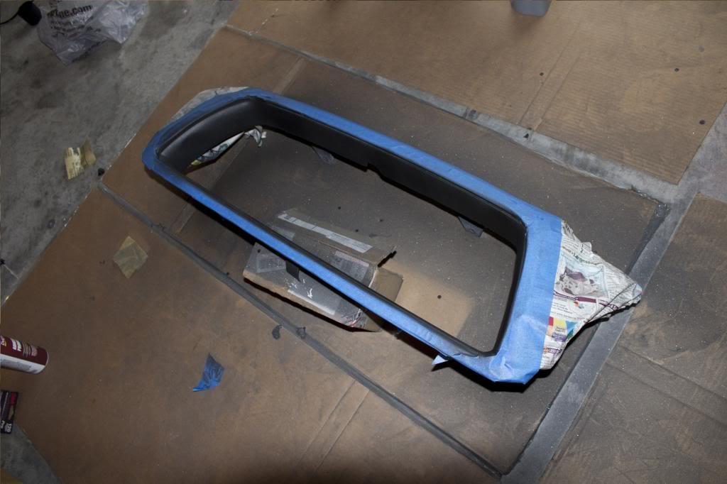

    Plasti Dip the inside to clean up the rough spots, and uneven areas.

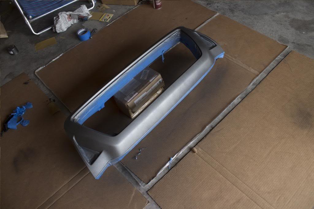

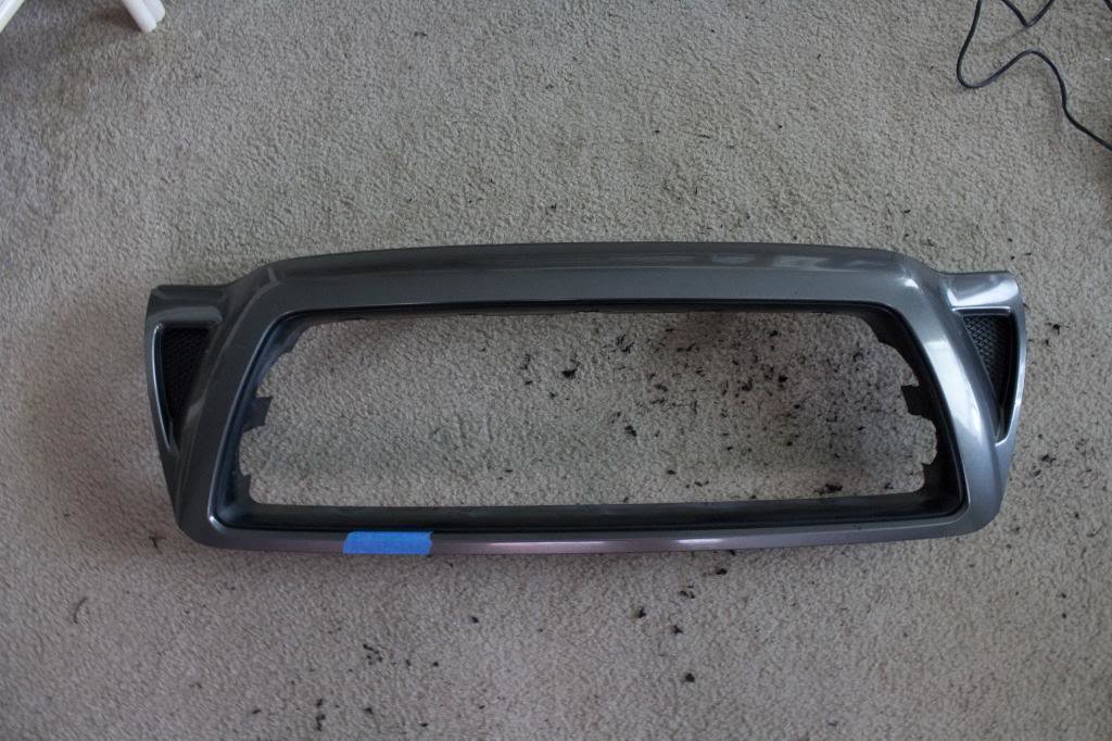

    Sanded and ready to paint match

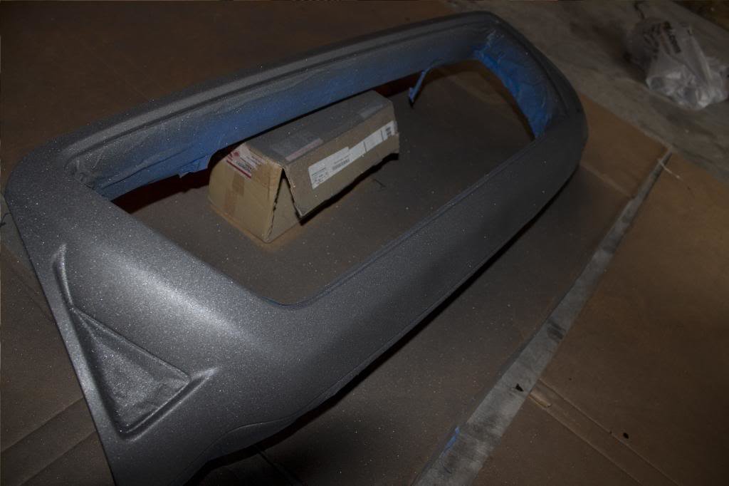

    I added one LIGHT layer of clear coat. First time, it turned white and I had to start over.

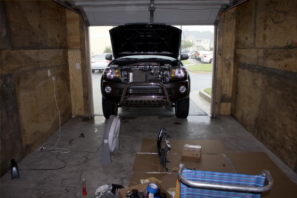

    My workspace

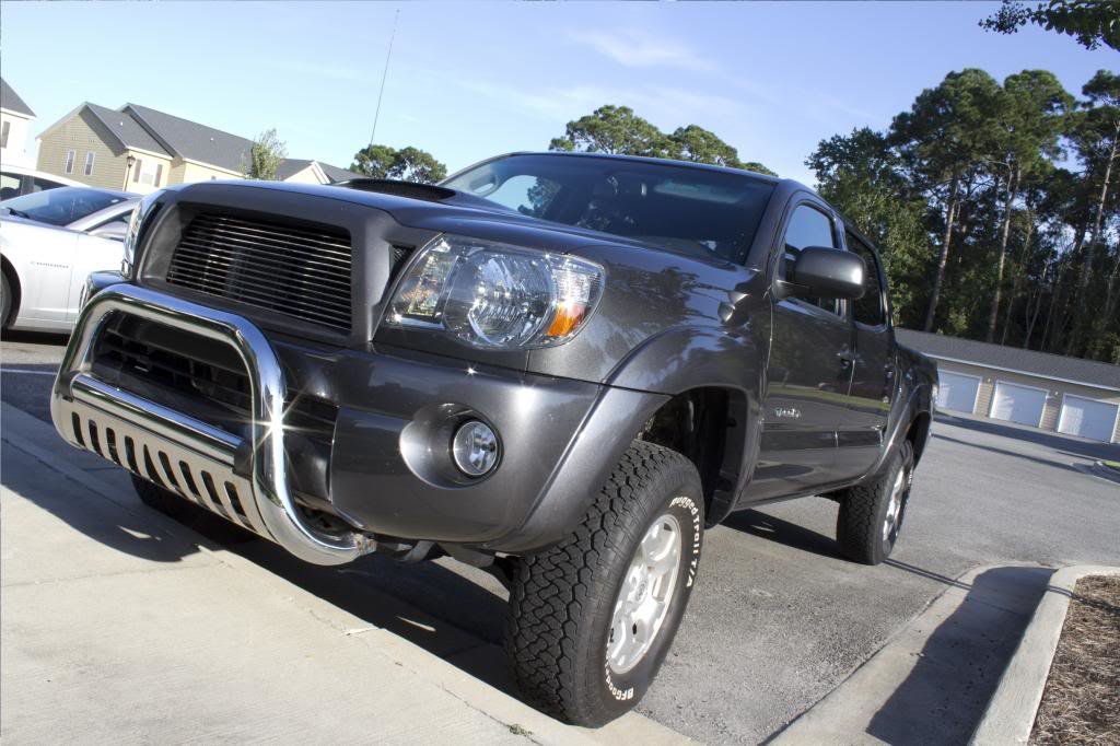

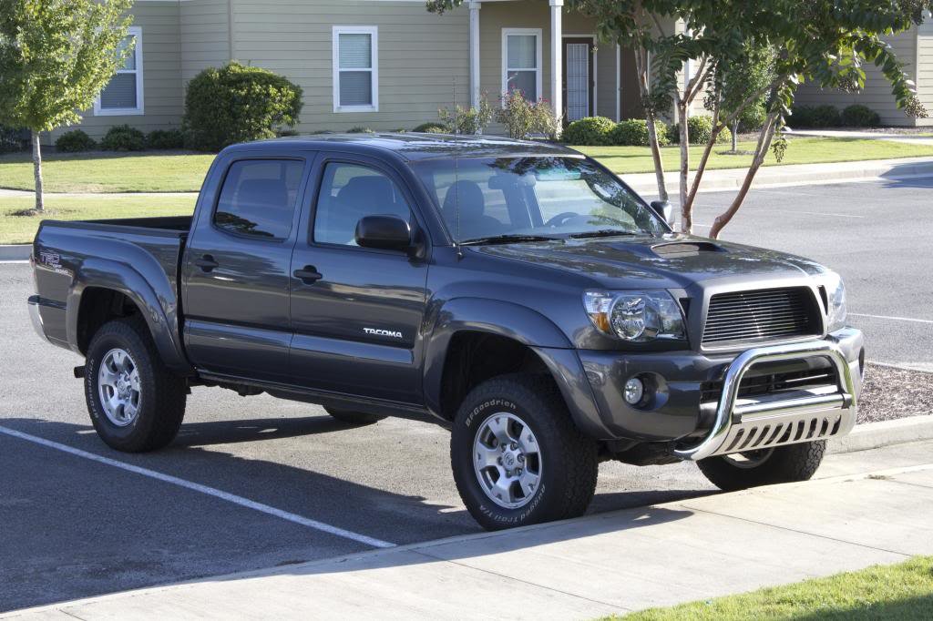

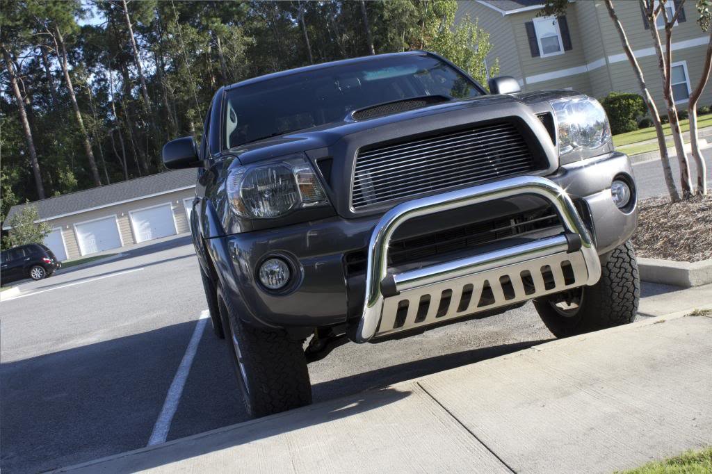

    Finished after two weeks of stress and paint
    If you have any questions please post them below. I'll answer asap! Total cost? Roughly around $400.00, which is $200.00 more than what I should have spent.
    But I had several setbacks and had to start over a few times. Difficuly level 7 out of 10. But for those who have more experience, and more room, and a power sander... It probably wont be as hard.
