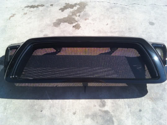

    Decided on doing another recessed grille. This time I went ahead and did the triangular vent sides as well. Those were sorta a pain but I wanted it to be a little different. Everything went perfect this time around, can't really even tell that it was bondo/fiberglassed on the sides. However, I go to throw it on and the damn hood release was catching/rubbing where I had one of the posts to attach the grille.
    So as a heads up for those doing this mod make sure you leave enough space right there. Now I have to go back and cut it off and move it over. Not that big of a deal, just more time consuming on an already time consuming mod. End of Rant:cool:

    Did you use a grill craft mesh?

    Yep.
    Nice work looks good, like the original tri's. starting on mine this weekend, hope it all goes well, it'll be a first bondo experience for me. thanks for the heads up on the latch rub! :thumbsup:

    I used a perforated metal and opted for the smaller holes since I didn't want to see much behind the grille. Can't afford the grillcraft so I went cheap!
