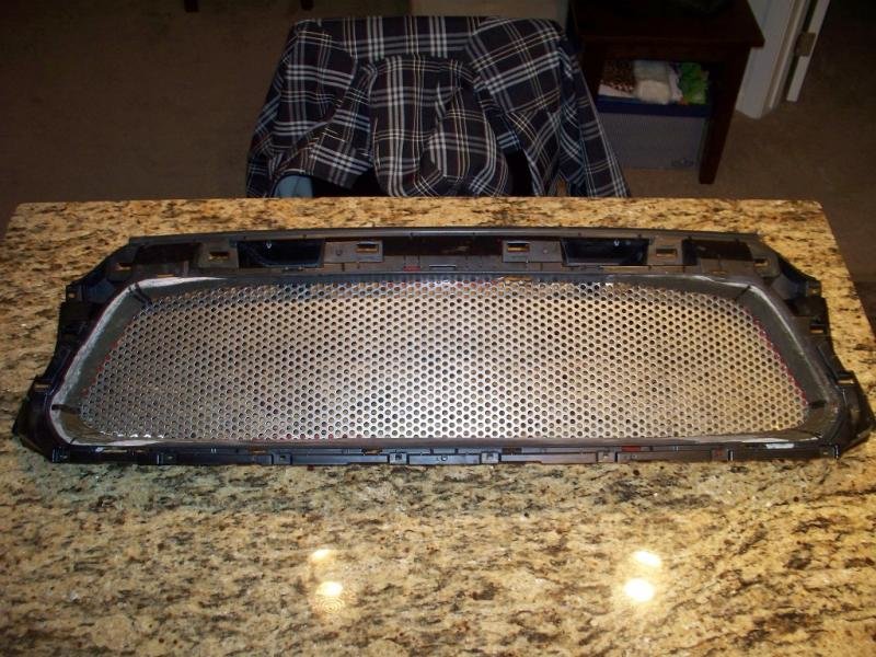

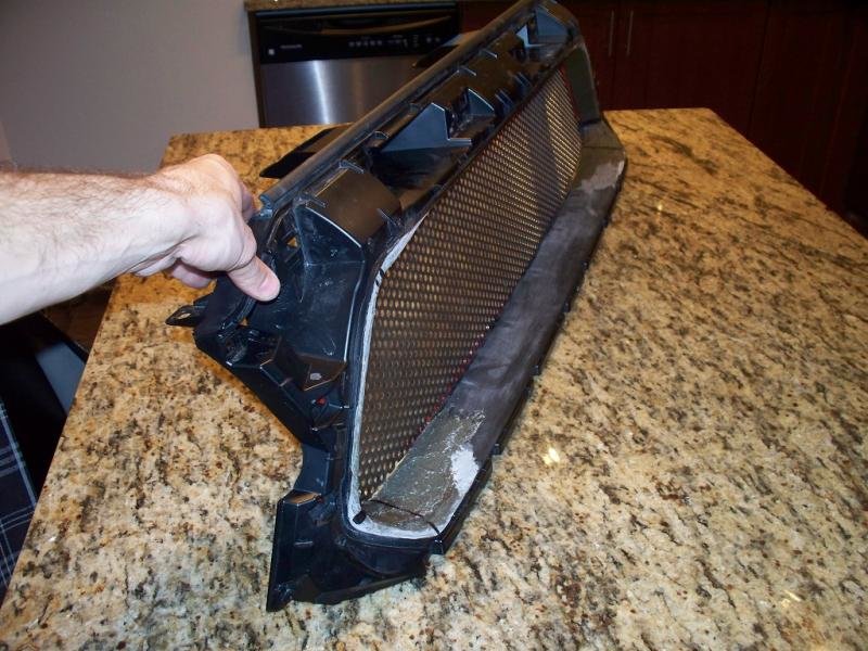

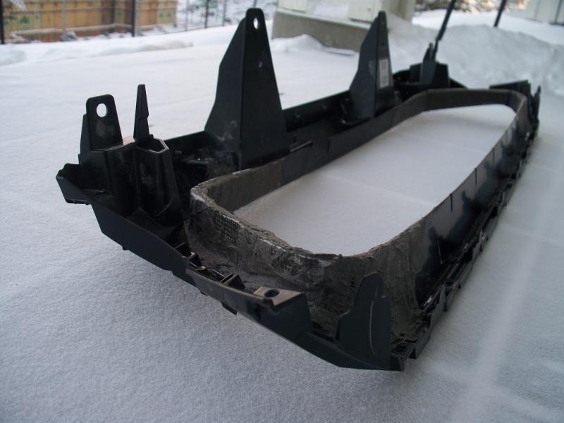

    Used the plastic-repair-kit & short-strand F/G... Everything bonded together just fine, it's solid/hefty and has endured repeated flexing/handling of the piece.
    I'm gonna start doing the finish-work on the visible side, & get a piece of mesh today to mock-up the mounting points.
    * the F/G "lip" is about 5/8" thick in pic # 2...

    You've got some work into that sir. :thumbsup:
    Have you tried to test fit it yet?

    No test-fit yet, gotta remove some material from the backside of the "lip" (on the sides)...
    Got me some mesh though... :D

    Side view, shows there's some depth to it...
