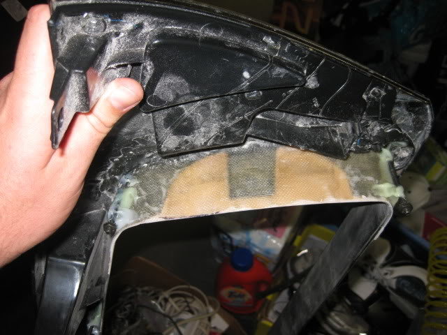

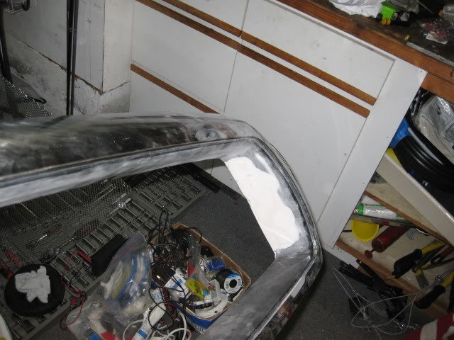

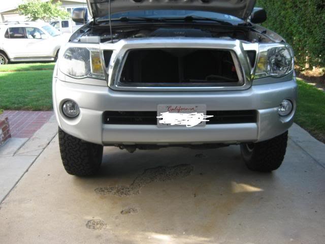

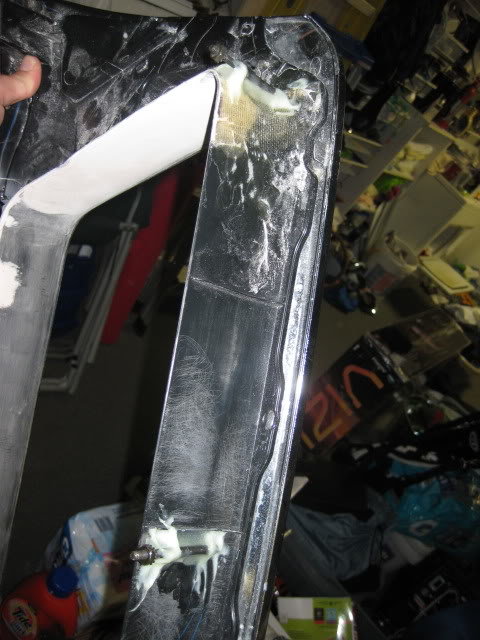

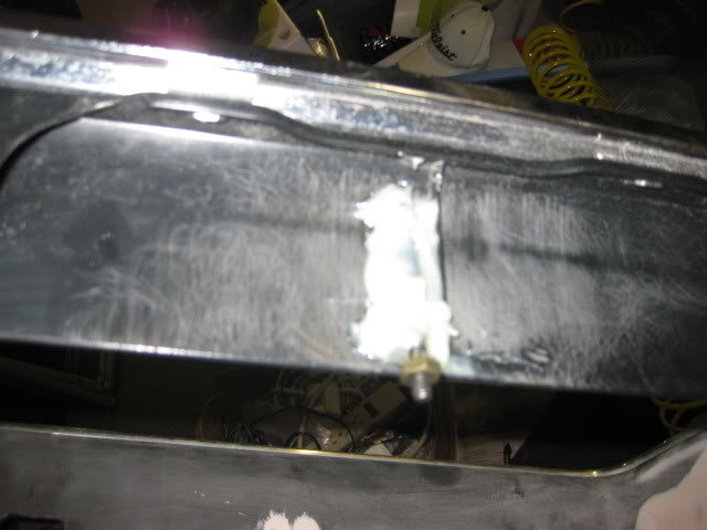

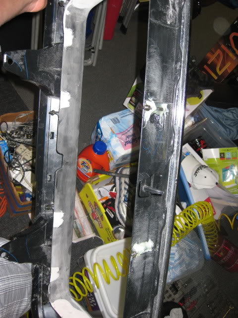

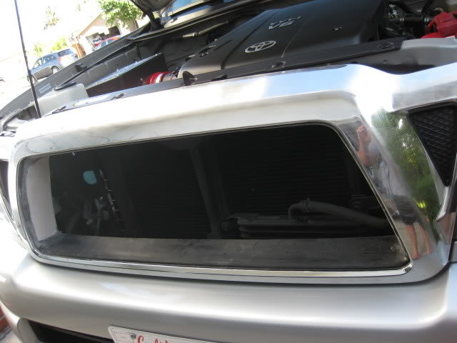

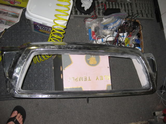

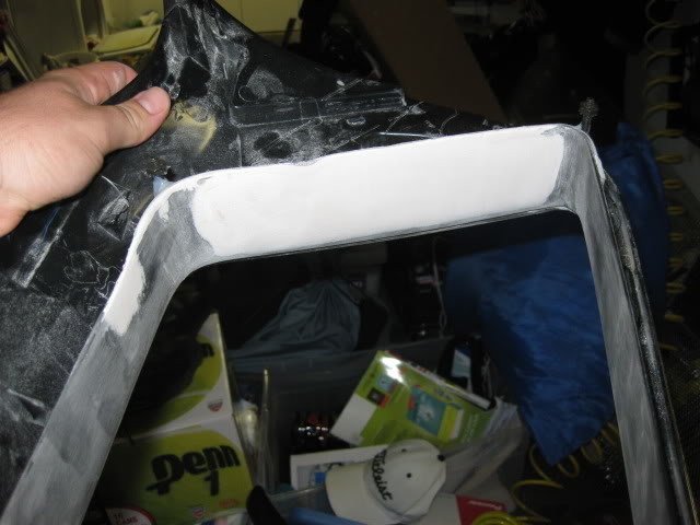

    I was dead set on getting a new grill, and decided that instead of paying around 150 dollars for a new insert, I would spend the 150 dollars and make sometime a little more unique and custom, (aka Satoshi). The pics on how to start this process are all over and can be easily located. I think the only differences are how people decide to mount the mesh to the stock grill, so the pics below hopefully give a good idea on how i epoxied the bolts to the grill.

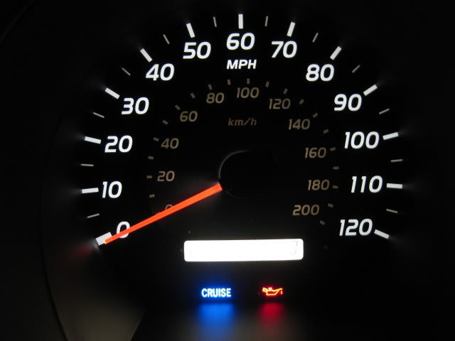

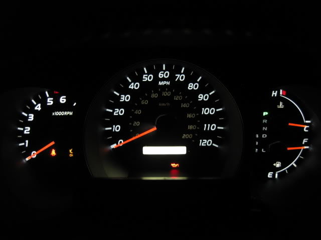

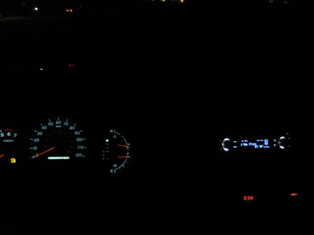

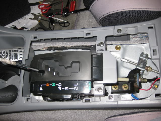

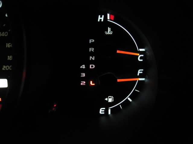

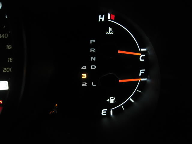

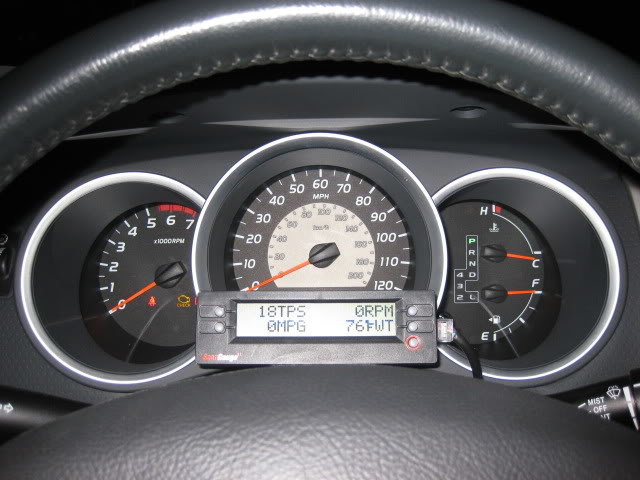

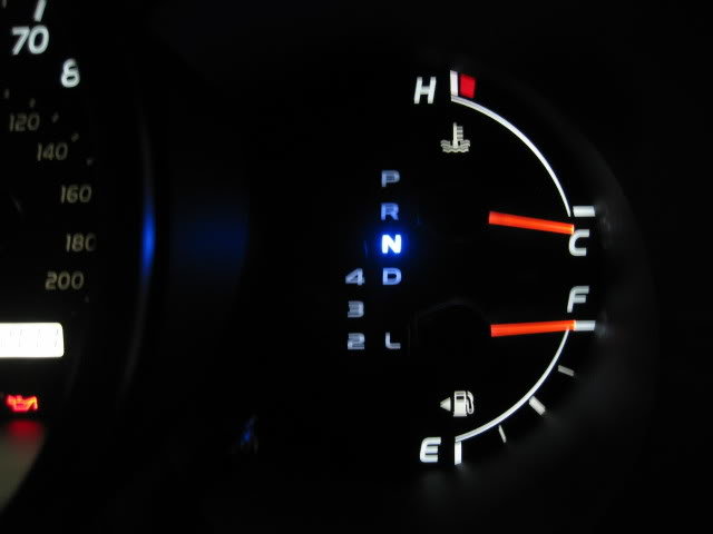

    As for the LED color change, I had a TN member, Yosh2000, help me out with them. We ran into a slight problem where my speedo needle lights would not come on, and 2 hours later of testing a re-soldering we found out my board was marked incorrectly from the factory, and the positive and negative were switched on one of the led perches. After that was sorted out, it all worked perfectly. So here are a few pictures showing what i had changed. The PRND4321 lights dont show up well on the camera, but in person they look so great. I have turned L into red, 2 is orange, 3 is yellow, 4 and D are green, N is blue, R is orange, P is green. I also was considering changing up all the lights to random colors, but figured since the check engine and airbag lights never show up, why even waste the time changing them. And I changed the cruise to blue, it sticks out a little more now than the stock green. It looks great with the white LED's on my Pioneer HU, and the Sirius radio is my next task. Hopefully I can break it apart and turn it white also to match the rest of my truck. The final picture is of today's simple modification, I made the inverter constantly stay 400W, and I also tapped into the wires so I can add a few sockets in the cab to charge anything I need to, mainly my camera batteries, and labtop.

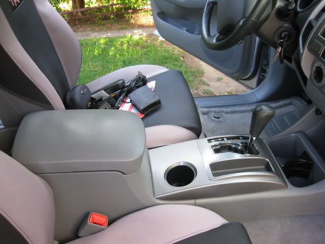

    How do you remove the center console?? It looks like you just unclip it, but i don't wanna do it without knowing.
    I want to change all the silver inside my truck to black.

    It pops up just like the rest of the clips in the truck. First, remove the shifter knob, then pull up and remove the trim around it. I grabbed in the cup holder and pulled the back up first, then it easily popped out. The actual center console is held in by 2 screws you uncover when you remove the trim that i just mentioned, and the other 2 bolts are under the carpet in the console. Just pull the carpet out (it is backed by a cardboard type material) using some pointed tool, i used a small dentist's pick to lift it up. It then just pulls right up, exposing the inverter, shift cable, and parking brake cable.
    Any other help, don't hesitate to ask.

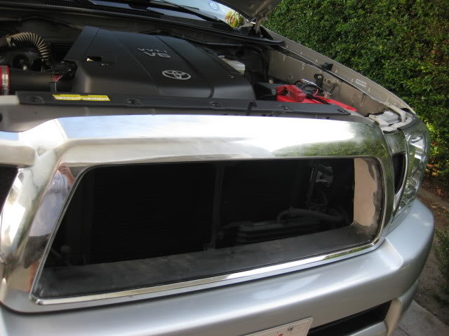

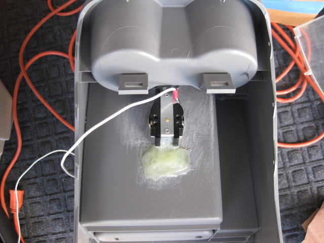

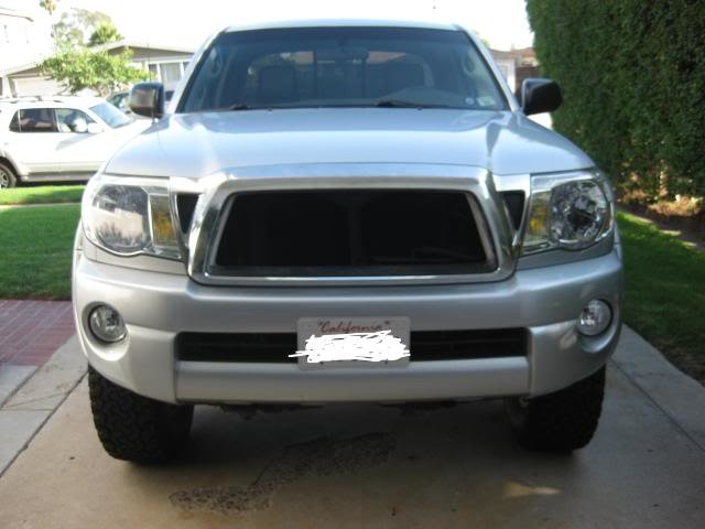

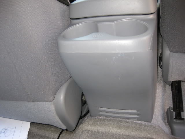

    Allright, A few progress updates. Test fit the satoshi on the car, and finished installing the 120V outlet in the center console.

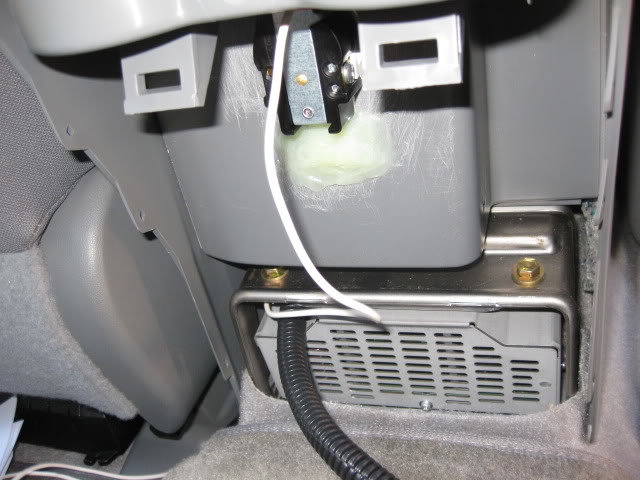

    Big thanks to the DIY section on here, all of the wiring connections were stolen from there, but I tried a new mounting location for the outlet, mainly because my sub box goes behind my center console, and I didn't want this to be visible at all. So I threw it inside the center console.
    Before picture after I washed my truck:

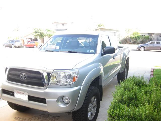

    Satoshi test fit:
    Pics of how I mounted the outlet in the console. I used a high strength gel epoxy, and roughed up the surface of the console. Its super solid and doesnt move at all.
    Looks totally stock from the outside:
    Until you open it up:

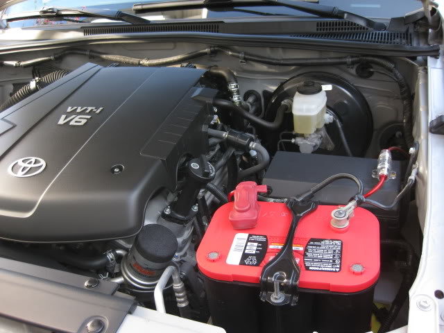

    More random pics of my engine bay and grill:

    that socket mod is very interesting, good work. do you have a complete write up of what you tapped into to set it up?

    what kind of mesh did you end using on your grille i finished mine a couple weeks ago and the mesh just dosent look tough enough didnt really want to spend 100 bucks on a mesh online got any suggestions?
    Ps. I used kitty hair on the sides look like you used a patch either way works good..
