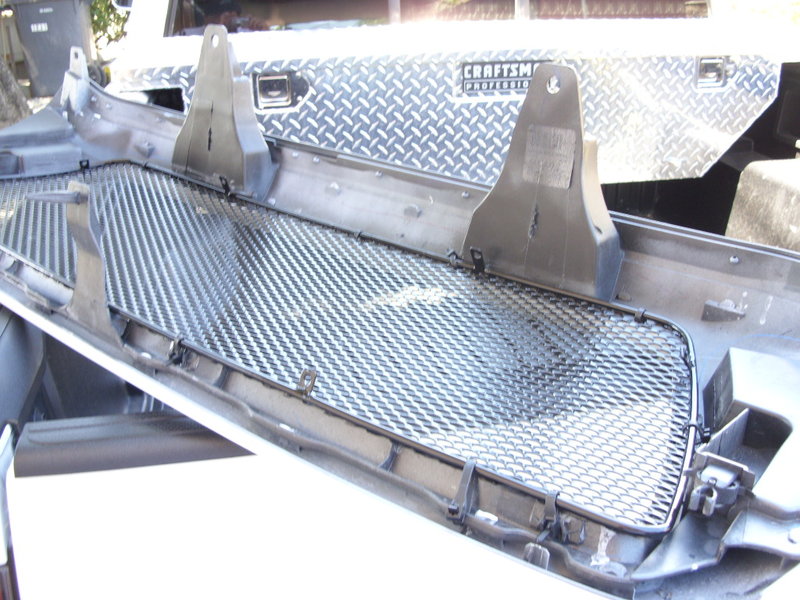

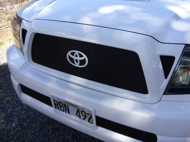

    When I cut mine I used a hack saw blade at each corner .To me was easier to join the cut in a straight line .As you cut from corner follow both lines you made top and side line. Just another option . That dremel looks nice but all I had was a jig saw and hack saw blade. :eek: Like Stealth Taco said just take your time.
    Jrozz[OP] likes this.

    that looks great man! I had to delay the project because the paint I ordered didn't arrive yet
