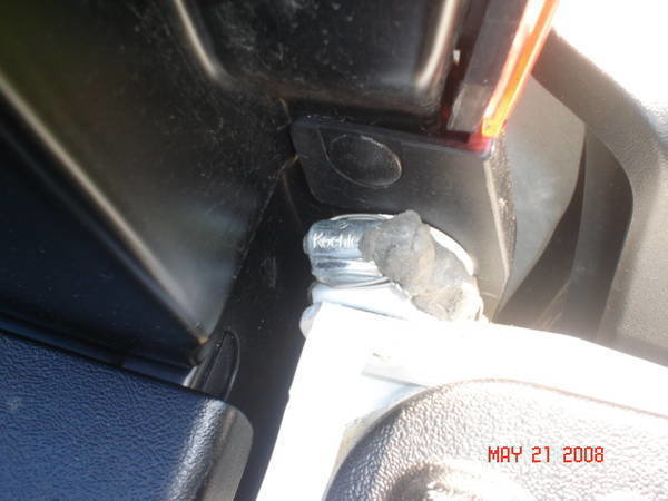

    If you have a long screwdriver one way to use just a regular hose clamp is to position the head so that you have to be under the truck to access it. Good job OP, great success story!!

    Yup thats what i did, You have to REALLY try to take the hose clamp off

    The steel ring I put on mine was a piece of tailpipe tubing from O-Reilly's..... cut to length with a hacksaw and painted. I like the idea of following up by filling the screw sockets after installation!

    Hose clamps are a great way to deter theft, I use them too attach most things to my roof/bed racks. Makes removing them something of a pain but not too bad if you have a power drill.
    Of course, any thief that really wants your tail gate just has to bring a power drill back to your truck and they can have it off pretty quick, but I doubt many would go to the trouble. Probably just move on down the street to the next Tacoma.
    edit: just saw that these are special key hose clamps, even cooler...I'll have to look into those
