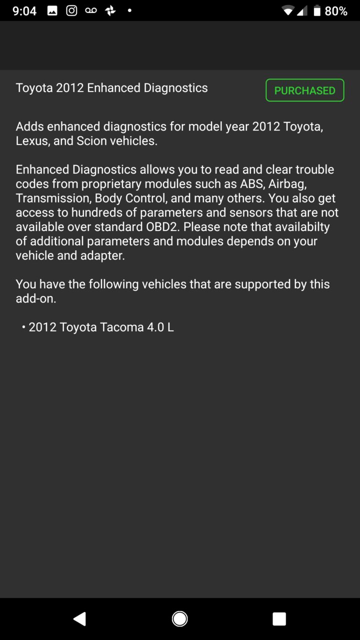

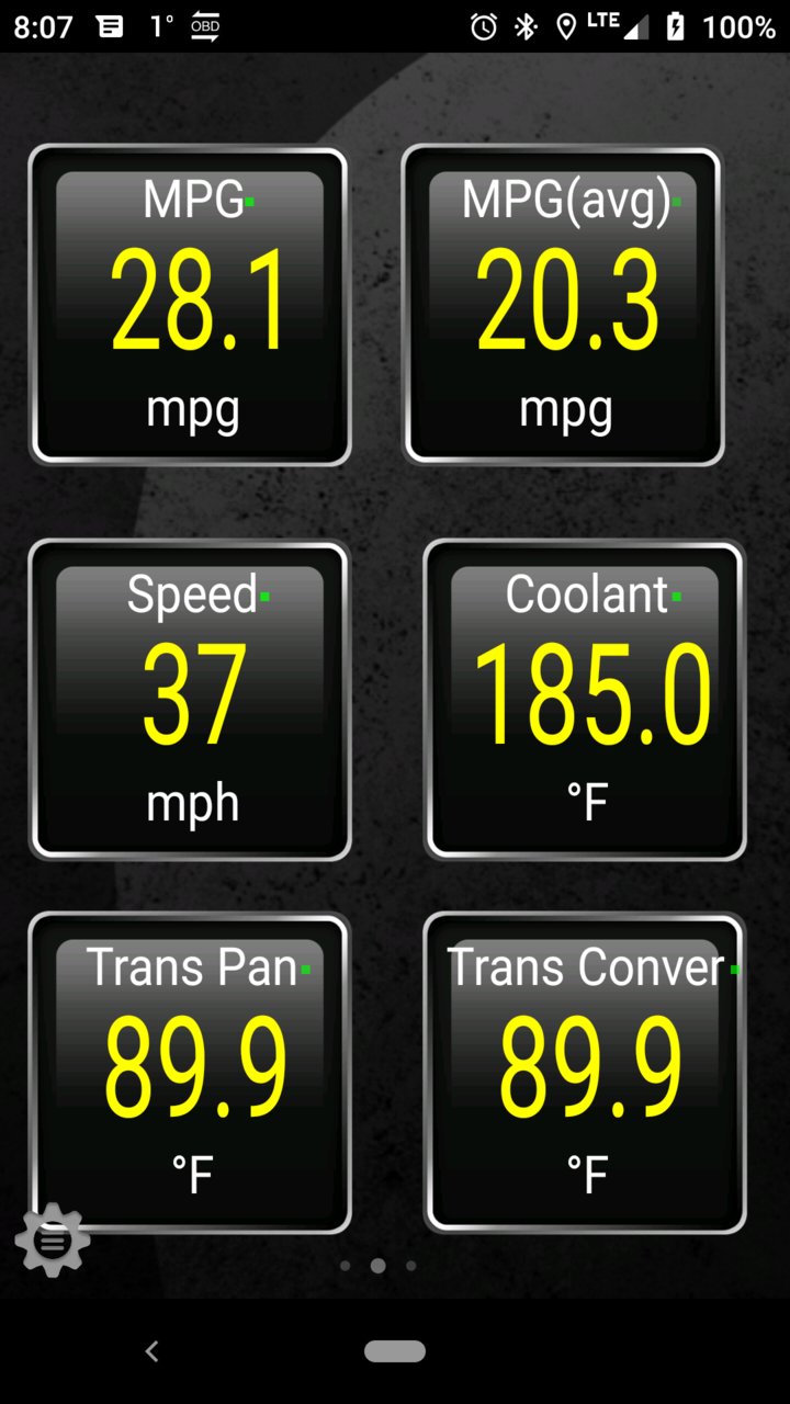

    What are you using? I ordered BAFX Products Bluetooth Diagnostic OBDII Reader/Scanner and downloaded Torque Pro app. No luck with getting readings even with the PID codes. I found the Fusion app and bought the Toyota extra diagnostics upload. I like the Fusion app much better then the Torque and the pan and converter temps can be displayed in real time.

    No argument that I didn't get the PIDs right in Torque Pro, but the OBD2 Fusion app doesn't require you to manually add the custom codes since you can upload Toyotas code for the specific year model you have. Couldn't seem to find this plugin for Torque Pro.
    Tried the Fusion app after reading a post on this forum that it worked for them so just passing it forward for anyone else.

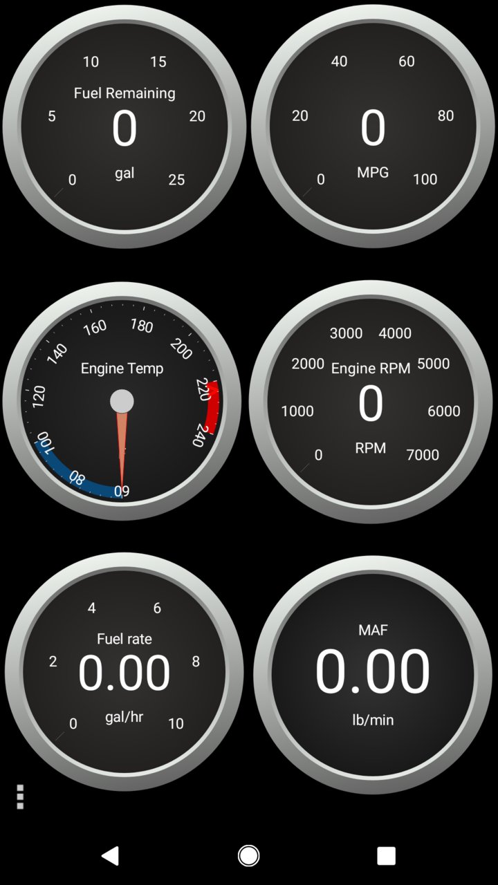

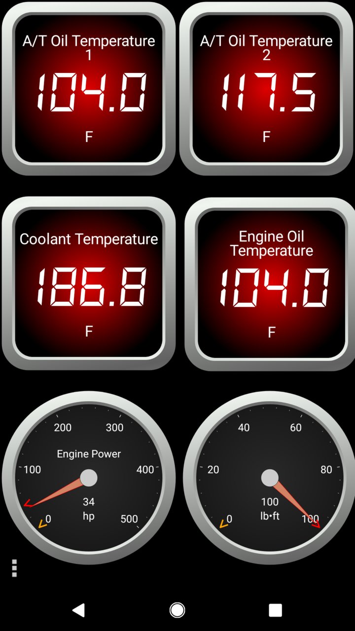

    Using ODB Fusion app. You can can purchase the enhanced diagnostics for your Toyota year model.
    You can add dash board boards and displays just like on the Torque Pro app, but Fusion app seems to offer more with the add in for Toyota.

    Is Fusion a free app and you buy the diagnostics or do you buy both?
  17. Mar 9, 2019 at 4:45 PM
    #17
    Tippycanoe
    Tippycanoe [OP] Member
    Mar 6, 2019
    #285577
    8
    Tyler
    2012 SR5 4x4
    4.99 for the Fusion app
    10.00 for the Toyota upload
