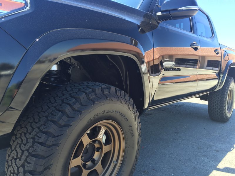

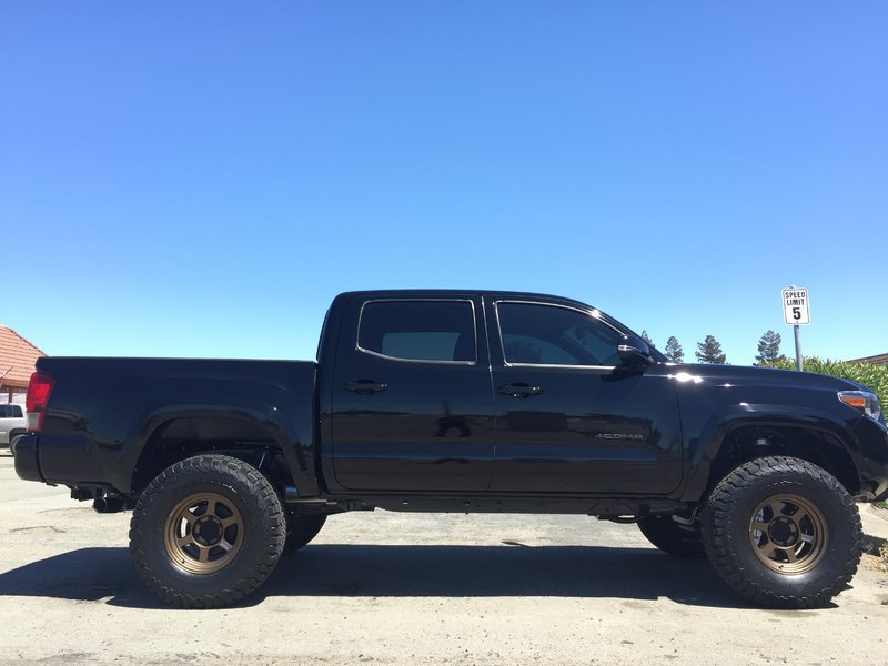

  4. Aug 5, 2016 at 4:13 PM
    #44
    iHoopAlot
    iHoopAlot [OP] Well-Known Member
    Jun 20, 2016
    #190079
    942
    Joey
    2017 QS Tan DCSB 4x4 Offroad
    Here's some pics

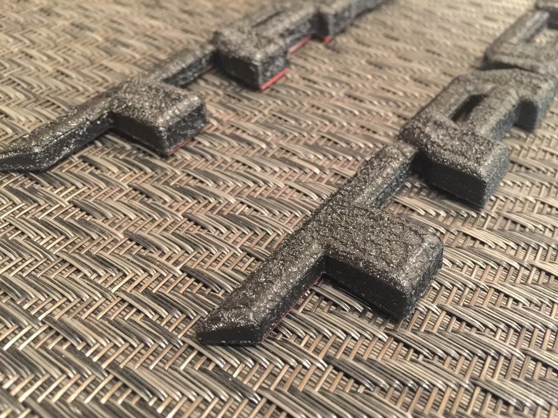

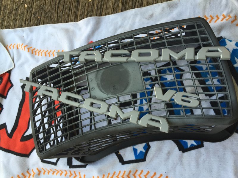

    Today I took off the door "Tacoma" and the rear "V6" emblems and I wrinkle blacked them.

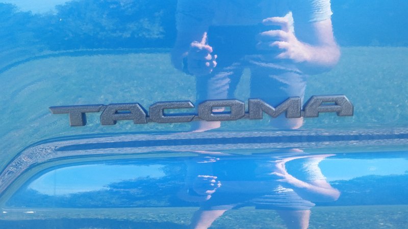

  7. Aug 8, 2016 at 2:28 PM
    #47
    iHoopAlot
    Jun 20, 2016
    #190079
    942
    Joey
    Emblems look way better blacked out IMO

    Hey man, I had to steal the wrinkle idea, did you have to take your logos off to do these? Or can you leave em on and do it like you would if you were regularly derping them? Does the over spray just peel off like regular plastidip?

    you have to remove the emblems off the truck.. The wrinkle paint is actual paint.. It won't peel off of you get over spray lol it's not not plastidip. When you gonto spray the emblems lay a coat of primer and then let it dry... When you go to spray the wrinkle paint.. Lay the paint on thick and then once your all done laying the paint down. Use a blow-dryer or a heat gun and dry the emblem until you see the wrinkle effect start to show... After that just let the paint dry like you would any other paint. :) let me know if have any other questions

    Ah cool, yeah I figured you would have to remove it to not make a mess haha...kinda dumb noob question but what did you use to remove and then reapply the emblems?

    Haha it's ok never hurts to ask... And I used fishing line and ran it down the back side of the emblems.. hold the fishing line the same way you would hold floss in your hand when your going to floss your teeth. Then after you paint the emblems just go to the store and get some 3m double sided enhesive tape and cut strips out to fit the emblem then re apply

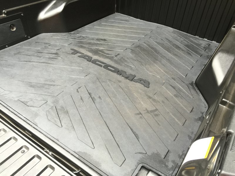

  16. Aug 21, 2016 at 10:17 AM
    #56
    iHoopAlot
    Jun 20, 2016
    #190079
    942
    Joey
    Today my gf dragged me around to a garage sale with her... Well I'm glad I went.. I found a Tacoma bed mat for sale for only 45$ I ended up buying it for 35$ lol I didn't know if it would fit in my truck but when I got it home I cleaned it and threw it in the truck and it fit perfectly haha! Guess I'll have to go to garage sales more often lol

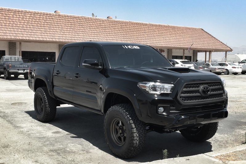

    So the other day I bought some OPT7 LED lights for my low bean head lights and foglights... Here's what they look like.

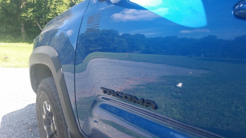

  18. Sep 2, 2016 at 1:22 PM
    #58
    Drifter16
    Drifter16 Well-Known Member
    Dec 9, 2015
    #171825
    174
    Eric
    Shenandoah Valley Area
    2016 Blazing Blue Pearl TRD O/R, DCSB 4x4,Prem Tech JBL
    Offensive stickers and stuff the wife doesn't know about.

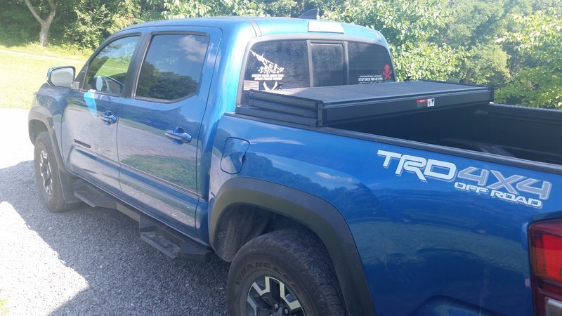

    Hey dude, so finally got the chance to get it all done haha. I ended up doing one piece a day lol, really dragged it out. Just been super busy, getting ready to re-deploy so been super busy doing family stuff. You were right it came out looking amazing! Also got my steps/sliders on and am loving those! Hoping to get my light bar on in the next day or two.

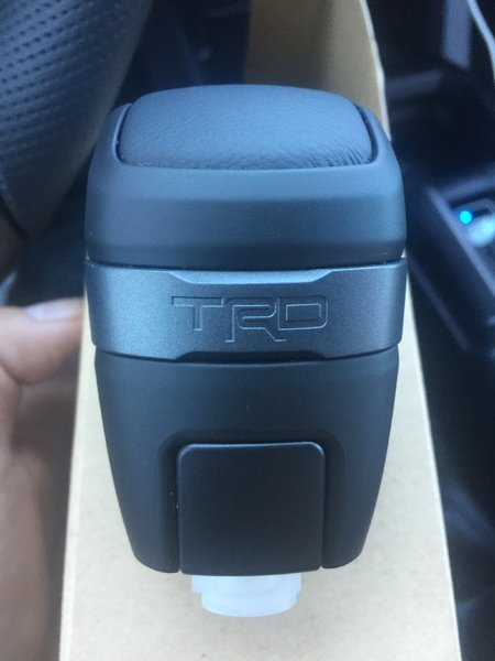

    #60
    iHoopAlot
    Jun 20, 2016
    #190079
    942
    Joey

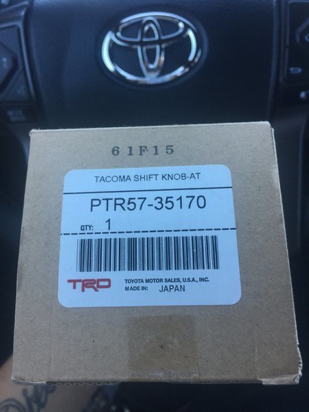

    So I have a good friend that owns a Toyota dealership and I had her order me. TRD Pro shift knob. Bought it for 95$ out the door and I picked it up today.. Here's some pics... And from personally looking at the shift knob in person the color is more of a orange than a red in my opinion. In the last picture you can see that it blends with the orange stitching on my seats perfectly..
