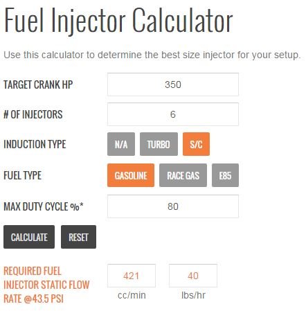

    Not sure what size your stock injectors are.
    Not sure how much crank hp that pulley will raise the engine to.
    Not sure what the what max IDC for crank hp your stock injectors can handle.
    Regardless of the cooling and timing benefits, having the properly sized primaries is a must.

    OEM Injectors from what i've read are like 280cc? I plan on upgrading to what i guess should be
    Torspd likes this.
