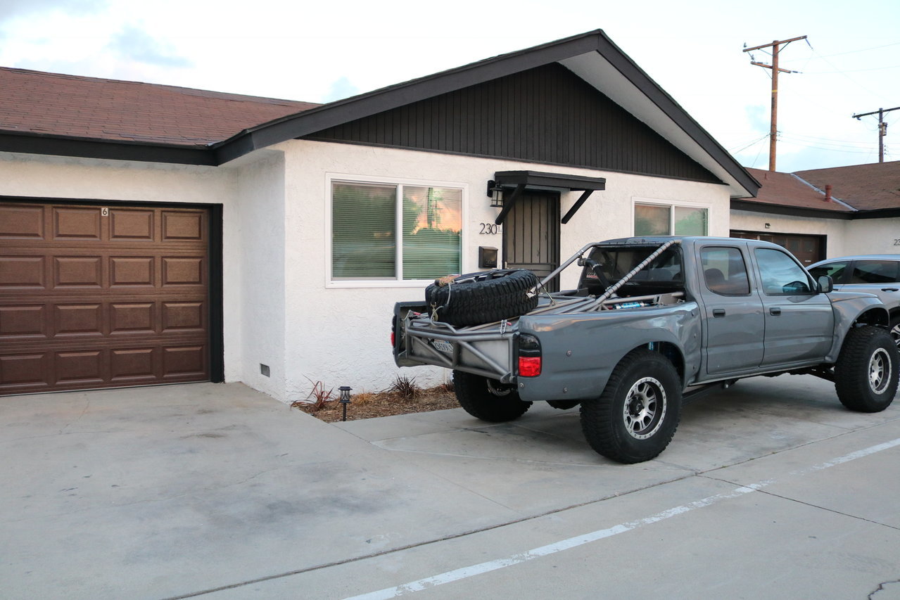

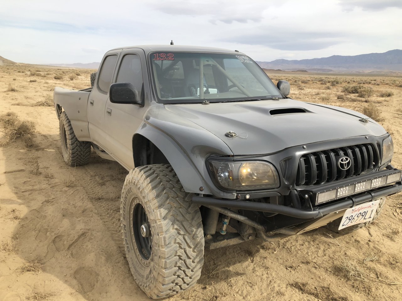

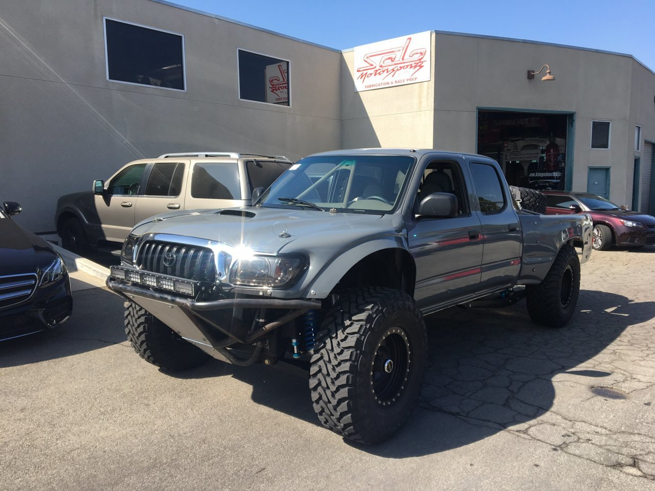

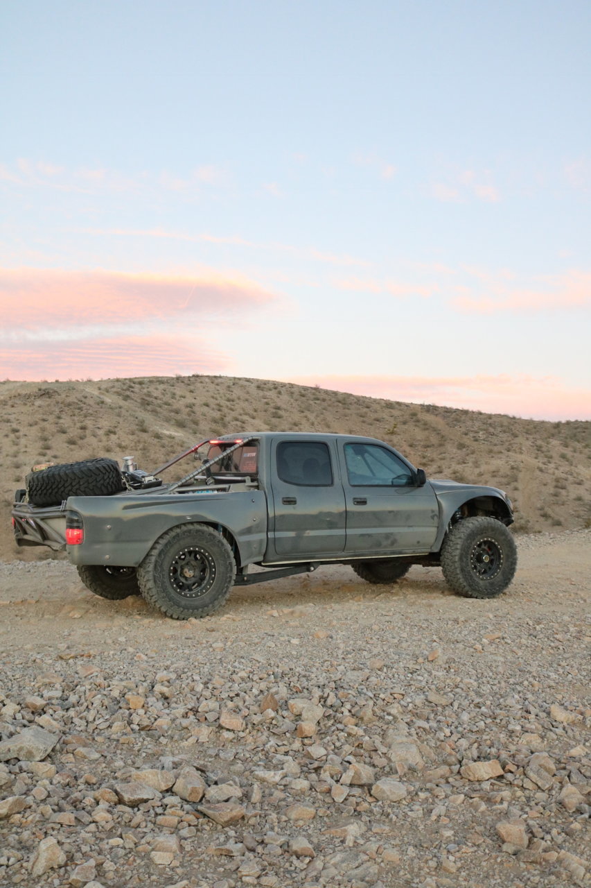

    New truck info back half full cage and going to be swapping supercharger putting solo XLT kit 4wd 3 seater. Truck is auto 58k miles overall super clean and fun truck
    New truck part list
    2003 Tacoma auto 4wd
    Front end
    -Solo 4WD XLT kit D44 hubs
    -King 2.0 2" bumps
    -King 2.5 12" coilovers
    -King 2.5 12" bypasses
    -Custom engine cage tied to cab cage
    Solo motorsports installed. Shock mounts to engine cage
    -tundra breaks.upgraded high performance pads.drilled/slotted rotors
    Cab

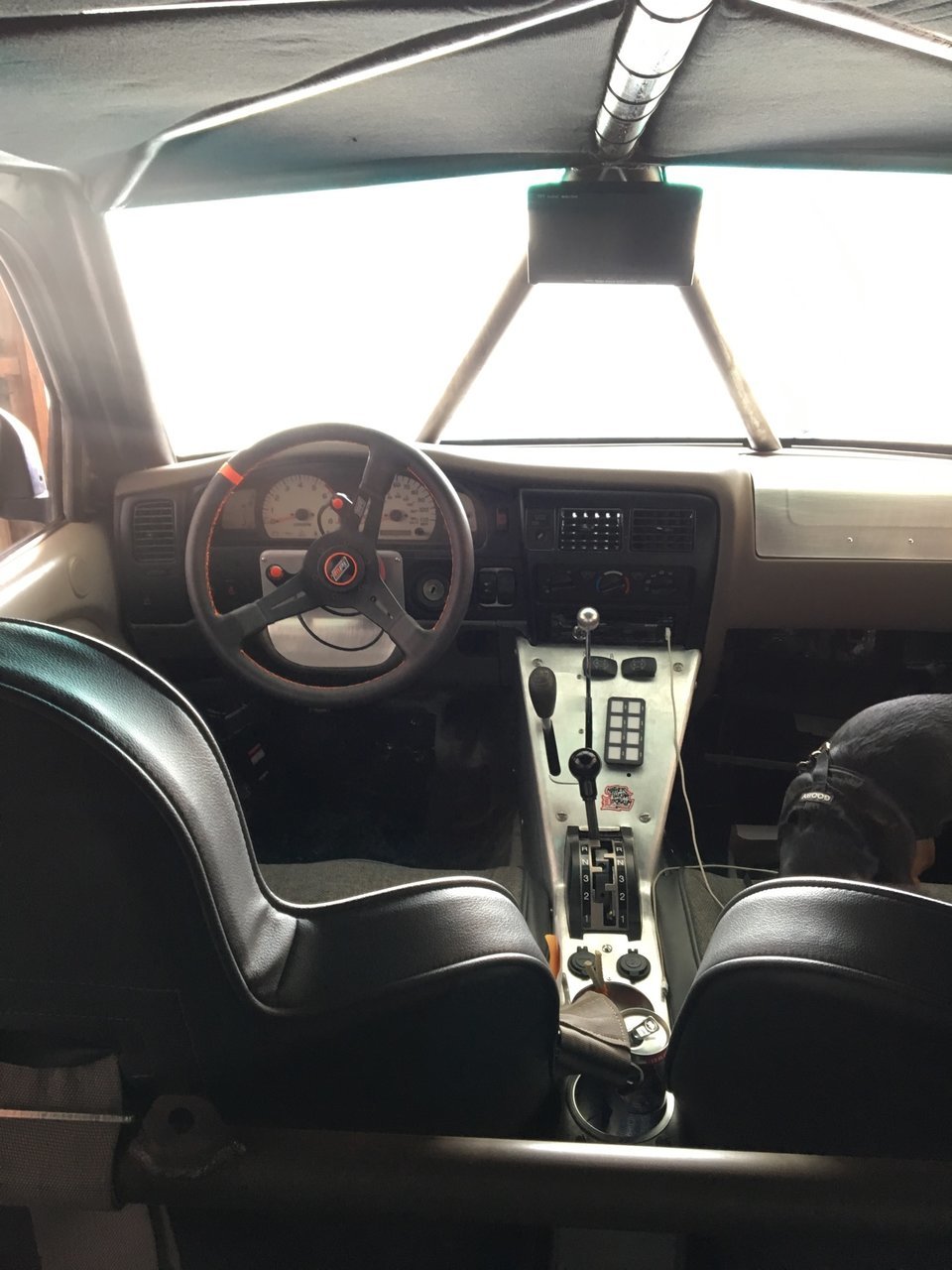

    -Full 1 3/4" cab cage
    -Momo steering wheel with sweet mfg quick disconnect
    -Lowrance trophy 5m gps
    -PCI intercom Bluetooth/DSP radio kit
    -Grey PRP competition pro seats(3)
    -silver PRP 5 point harnesses
    -Carpet kit(black) possible painting interior a new color(not 100%)
    -Switch pro switches
    -aftermarket gauges
    -Auto meter boost gauge
    -Innovate motorsports wide and gauge
    -Auto meter voltage digital gauge
    -Dirtskum interior pieces(more to come)

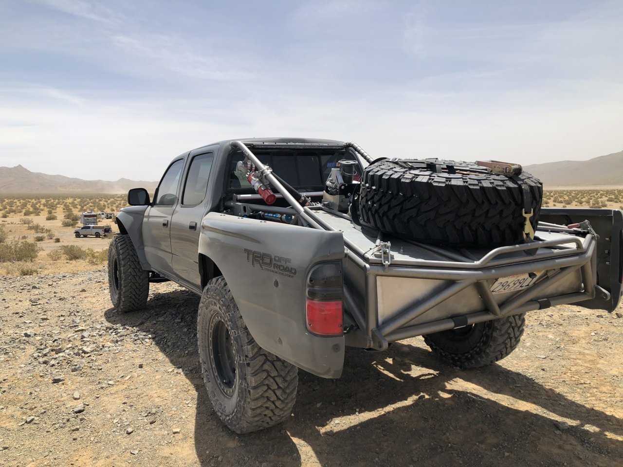

    Rear
    -Rear frame delete kit All work done by ttmotorsport
    -Possible sway bar addition soon
    -King 2.5 14" coilovers
    -King 3.0 16" bypasses
    -King 2.0 4" bumps
    -Custom 55" links
    -Custom rear trunk
    -One spare PRP Y strap
    -Pro eagle jack with solo jack mount
    Extras
    -5.29 gears
    -(5) 17x9 Ultra x103 beadlocks with 35" toyo tires
    -After market A/C installed
    -Windshield wiper custom installed
    -2 hella horns and a siren
    -Motor will have TRD S/C and new 7th injector kit all upgraded pulleys
    -Two fire extinguishers inside the cab,one out back
    -Tool box and spare part box behind passenger seat
    -30" gglighting and two pods up front
    -Baja design rear light(brakes,amber, and white)
    -Stock gauges for the most part.trying to get the stock fuel gauge to work with fuel cell and speedo stopped working first trip out(will fix to get going again)
    -Will be adding some way to load two pit bikes on the back above the fuel cell and trunk
    Will be buying helmets and fire suits for my wife and I soon.just for safety and for maybe a few races.dont plan to race it crazy or a lot just a couple at the most.
    Not sure but would like to see some 37s on the truck maybe in a few years.and maybe a toyota v8 with a s/c. But this is all dreams there

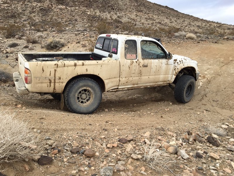

    So this build has been through two trucks of mine. First was a 2000 2wd Tacoma TRD. (NOW 3 TRUCKS)
    Someone ran a stop sign and I t-boned them. Total that truck
    Kit was still good.:dancingbacon:

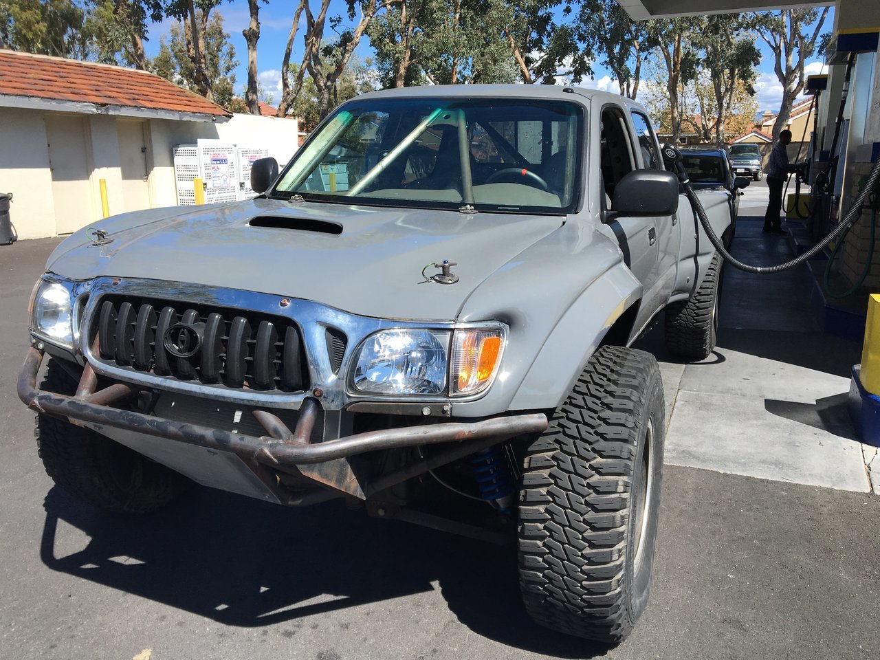

    Front
    Camburg 3.5" kit
    8" King coilovers
    2.0 2" King bumps(being installed)
    Total chaos spindle gussets
    Total chaos extended axles
    Total chaos upper control arm gussets(being installed)
    Drilled and slotted rotors
    Glassworks unlimited 4.5" flair
    New kit is a solo xlt kit with 10" king coilsoverswith solo custom valving
    With some crazy axles
    Rear
    2.5 King 14" coil overs(being installed)
    2.0 2" King bump stops(being installed)
    3/4 link kit(happening)
    Tundra axle(being installed)
    4.10s with Detroit locker
    1.25 " lift shackles. (Gone now)
    1.5" wheel adapters(gone)
    Glassworks unlimited 4" flair
    The rear idea might change to the DDL kit. Started out as keeping it smog legal but have decided to just link it with fuel cell but keep as much bed as possible.
    Wheels
    5 Ultra xtreme x102 15x8
    5 bfgoodrich all-terrains
    1 32" bfg on a unknown rim
    Extras
    Solid motor and transmission mounts
    Snyder one piece headlights
    Spray painted grill and chrome piece on bumper
    Put green LED lights in my cluster and two gauges on my pillar
    Have three pods going to be mounted to the cage. Boost,afr and egt
    Mastercraft 3G seats with pro armor 5 point special edition all black harnesses
    Going to have two fire extinguishers inside truck, will dyno mat the inner truck and put stock carpet and headliner back in most likely. Then try to panel back of truck where the plastic was
