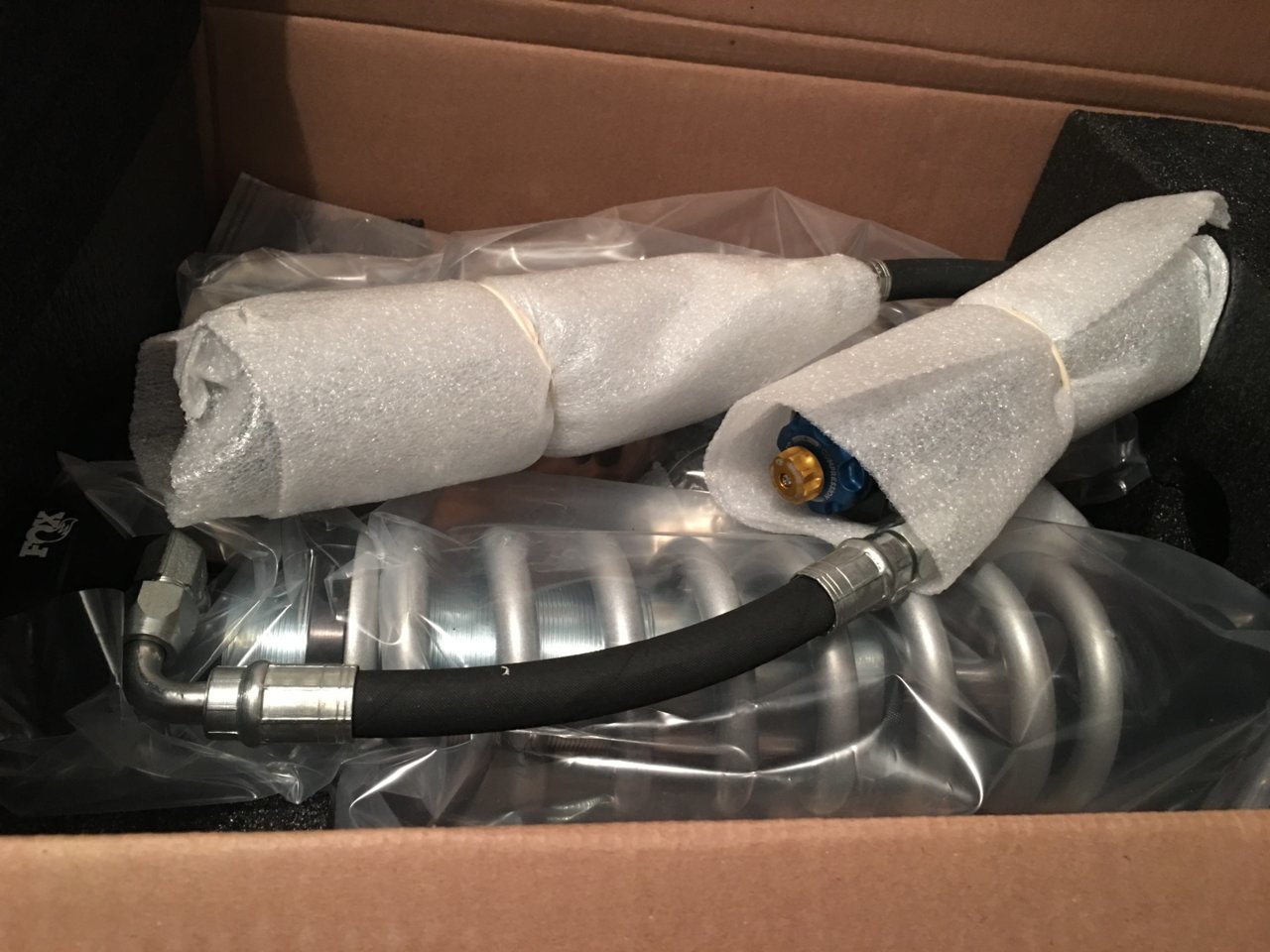

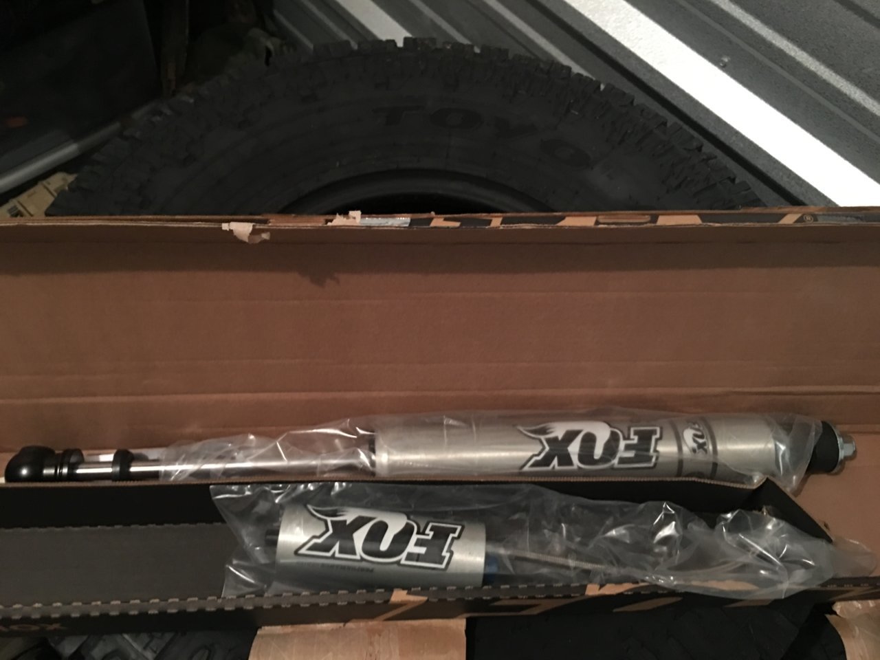

    Would you guys be able to help me install a suspension lift if I made it out? I’d be coming down from Ft. Bragg, NC so almost a four hour drive. I don’t know how long installing everything would be, if it could all be done in the one day. I’ve got preassembled front and rear shocks, an add-a-leaf, rear axle shims, UCA’s, and brake line extension.

    Pre-assembled certainly makes it an easier job! Rear shocks are a snap but UCA's, brake lines, and AAL can be a little tricky. If you can get some people to dedicate their time it should be able to be done.

    Pre assembled rear shocks?
    Is the aal already installed?
    Gonna be alot of big projects going on this time, that's for sure.

    EE624D95-5643-490B-BA51-F2AFE2ADB1CA.jpg E57EE52B-5160-4B59-81BE-0AEC9A3965A7.jpg
    AAL hasn’t been installed yet.

    The aal shouldn't be that bad.
    Couple C clamps.
    Do you have the longer centering pin and longer u bolts?
