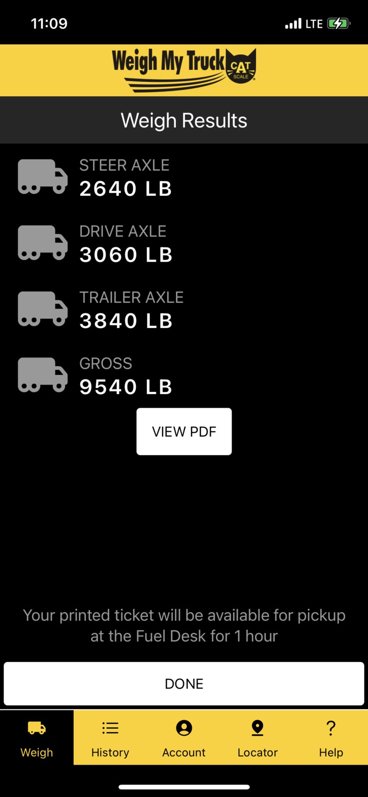

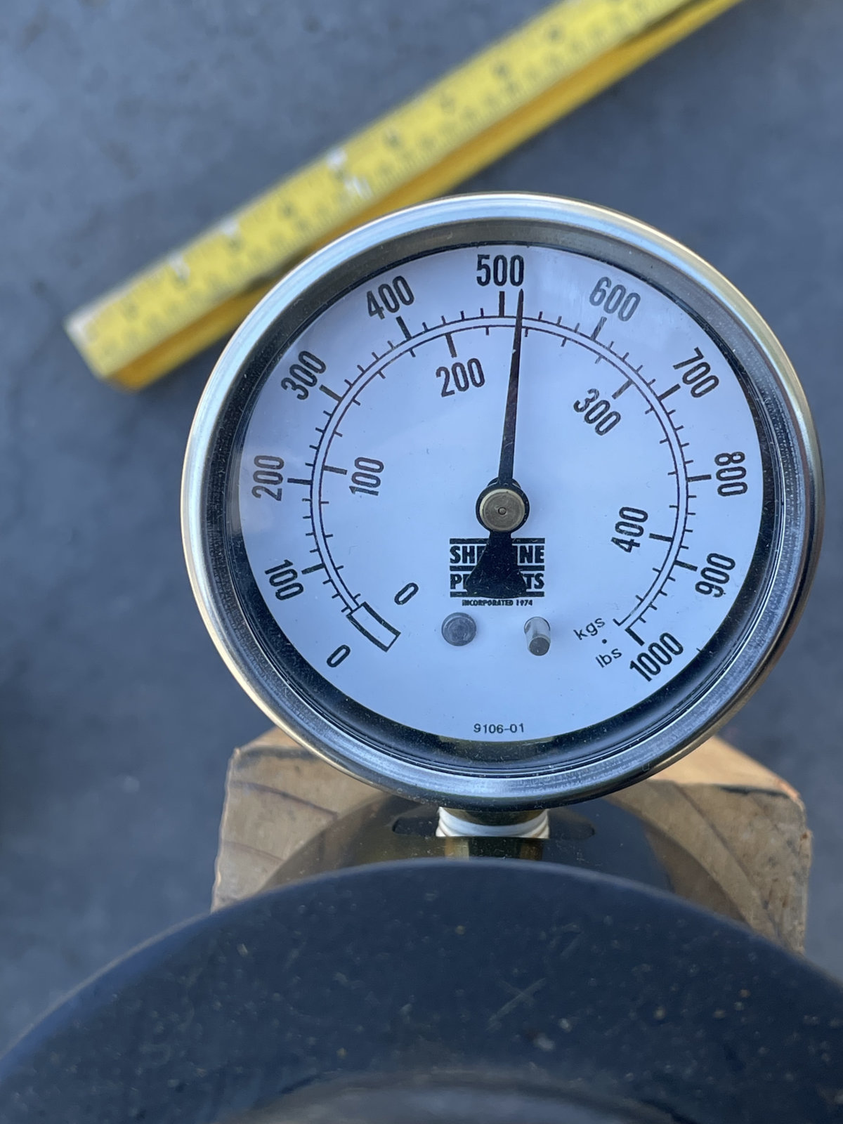

    IMG_1439.png IMG_0226.HEIC.jpg Small write up to help others see what weights I experienced at the CAT Scales and with my own personal tools.

    Sherline LM1000
    CAT
    The Weights
    CURT OBD2 Better Weights puts tounge weight between 450# (quick weekend away) to 525# (week long trips). The CURT says total weight is around 9000# with truck only just above 5000#.
    Sherline LM1000 can only measure tounge. Places tounge anywhwere between 500-525#. Once I filled the fresh tank just so I would know the impact, 36 gal. - 650#. Never travel like this.
    CAT placed truck at 5200#. Total with trailer at 9540#.
    Now here’s a question, does this mean my trailer weight is 4340#? I’m subtracting the truck weight from the total gross weight. GVWR is 4400#. Am I right on the edge then?
    Hope this helps others figure their weights.
    Doing the CAT was reassuring. Looking back I am impressed with the CURT OBD2 tool.

    @Gocamping23 , according to your CAT Scale ticket, the trailer weight is 3840# and the tow vehicle weight is 5700#. The 5700# truck weight (steer axle + drive axle) includes the tongue weight. So, if you weighed the truck alone and it scaled at 5200#, your tongue weight is 500#.

    Thanks @wiljayhi !
    That definitely explains things for me now.
