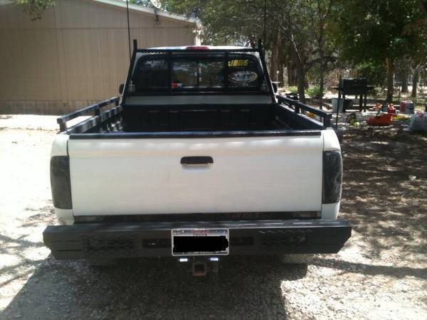

    This is one of my favorite first gen builds!! I love the bumpers! I also built mine and im in the process of building a new one with diamond plate. Im glad i saw yours to get ideas. :drool:
    Old pic but i just made the bumper in this one.
    This is my new bumper im building and im going to diamond plate it! Yours look freaken awesome!!

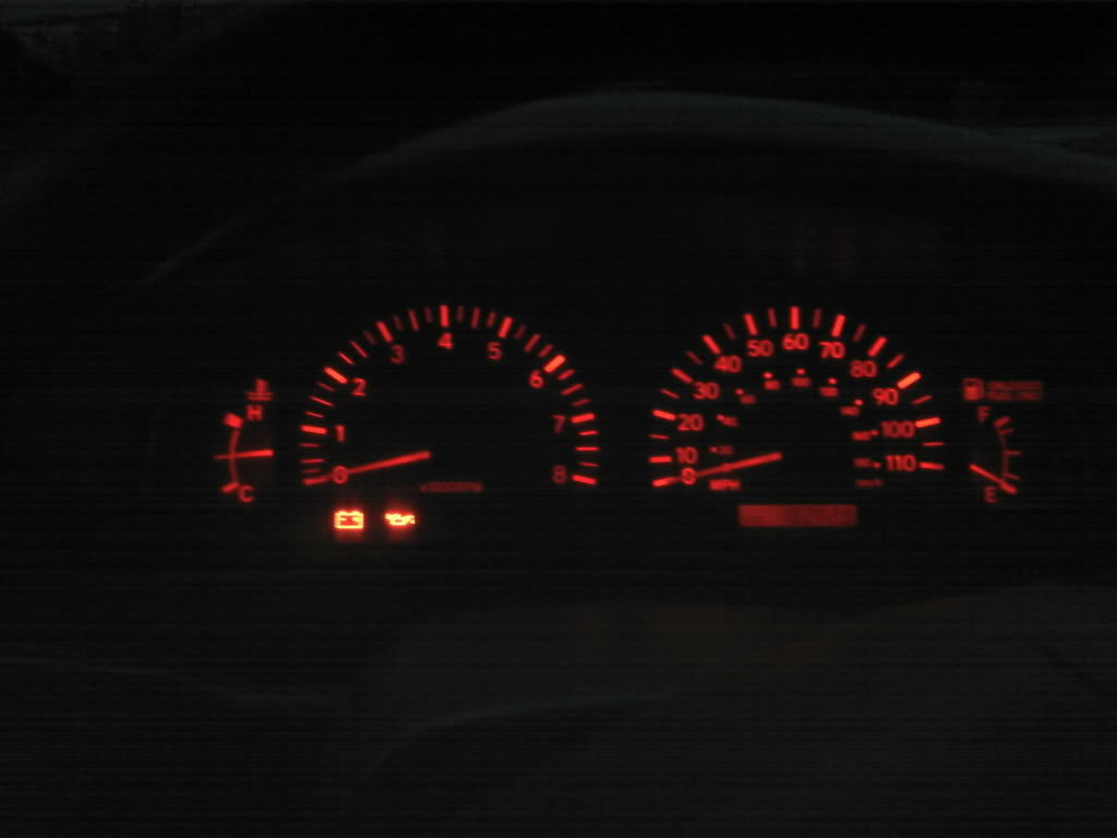

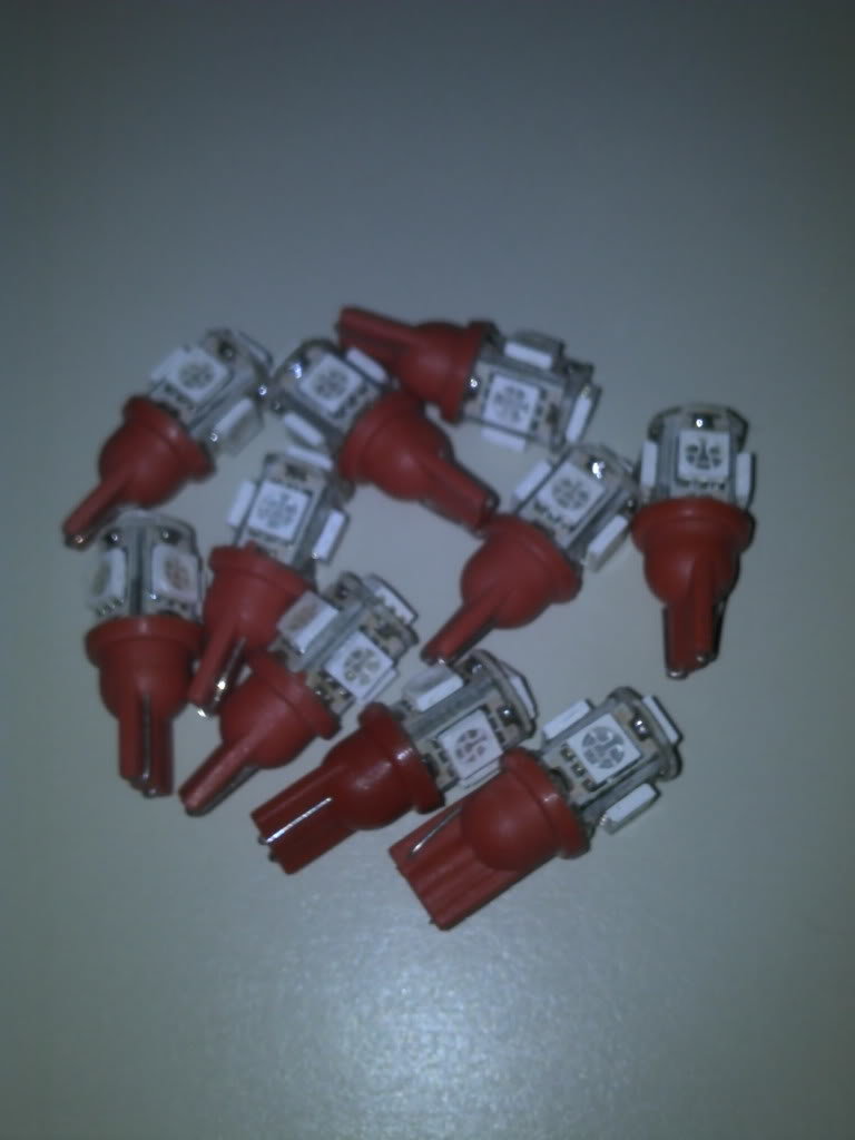

    Are those "194" leds? I Bought a set of 8 of those but mine are blue that I wanted to put into my dash but I haven't had time to take apart my dash yet and I also don't want to rip it all apart if the bulbs are the wrong size because I saw a picture of someones dash online and they weren't 194s they were much smaller one bulb leds. Do you have any pictures of your dash cluster when it was out ? (my trucks an 03 sr5 tacoma by the way) thanks!

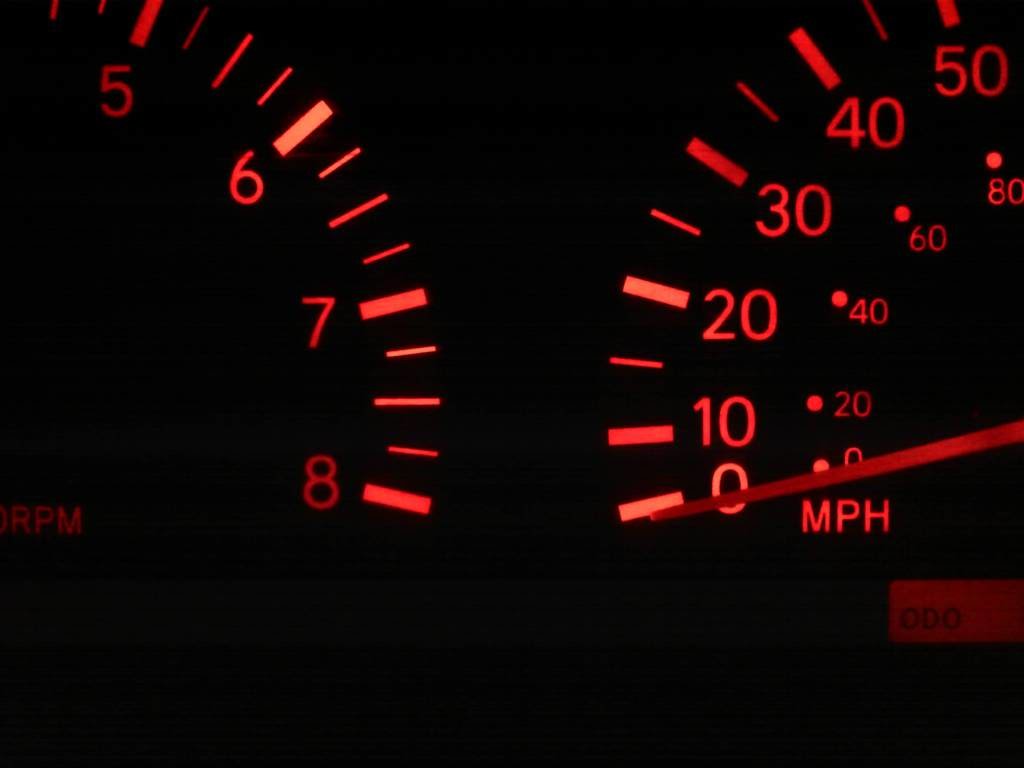

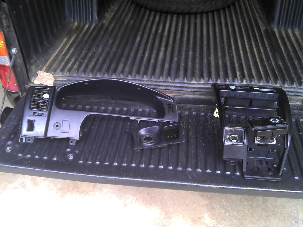

    I don't have one of the cluster out, so I found one! My buddy travis9287 has an 03 and it also used 194s there should be 6 194 bulbs, 4 illuminate the cluster, 2 for the blinker indicators and then the rest are a 74 type bulb. The A/C climate controls are tricky you may have to do some custom work in their! Most people modify T1.5x bulbs for it.
    Heres a link showing what you gotta do for the climate controls.
    http://www.customtacos.com/forum/showthread.php?t=118109

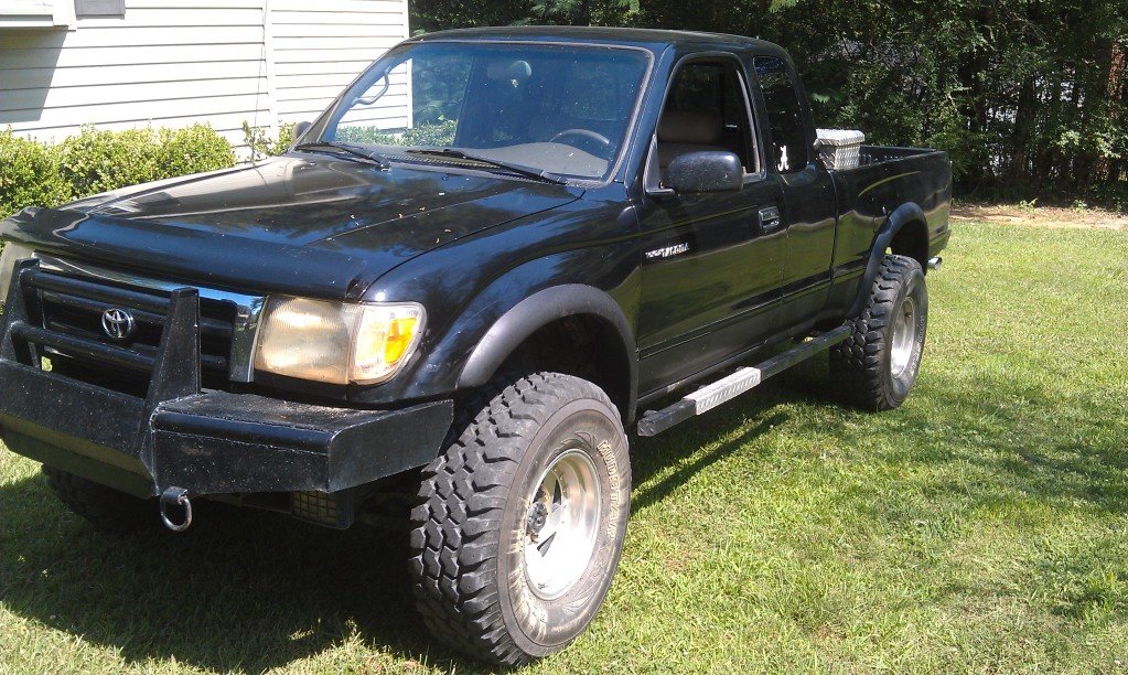

    Finally got the clutch installed about a week ago! Got a Marlin Crawler 1200 and I'm loving it! On the test drive I ran into some bad luck for sure! I got something in the fan and slashed my radiator. I ran it a little hot but got it home and soldered the radiator up and its good to go for now!
    Also another thing I did was black the hood which basically looks like spray on bed liner and did a subtle angry eye look.
