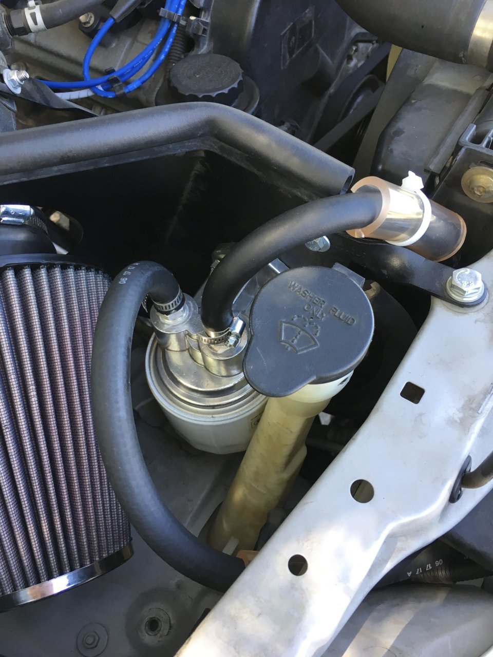

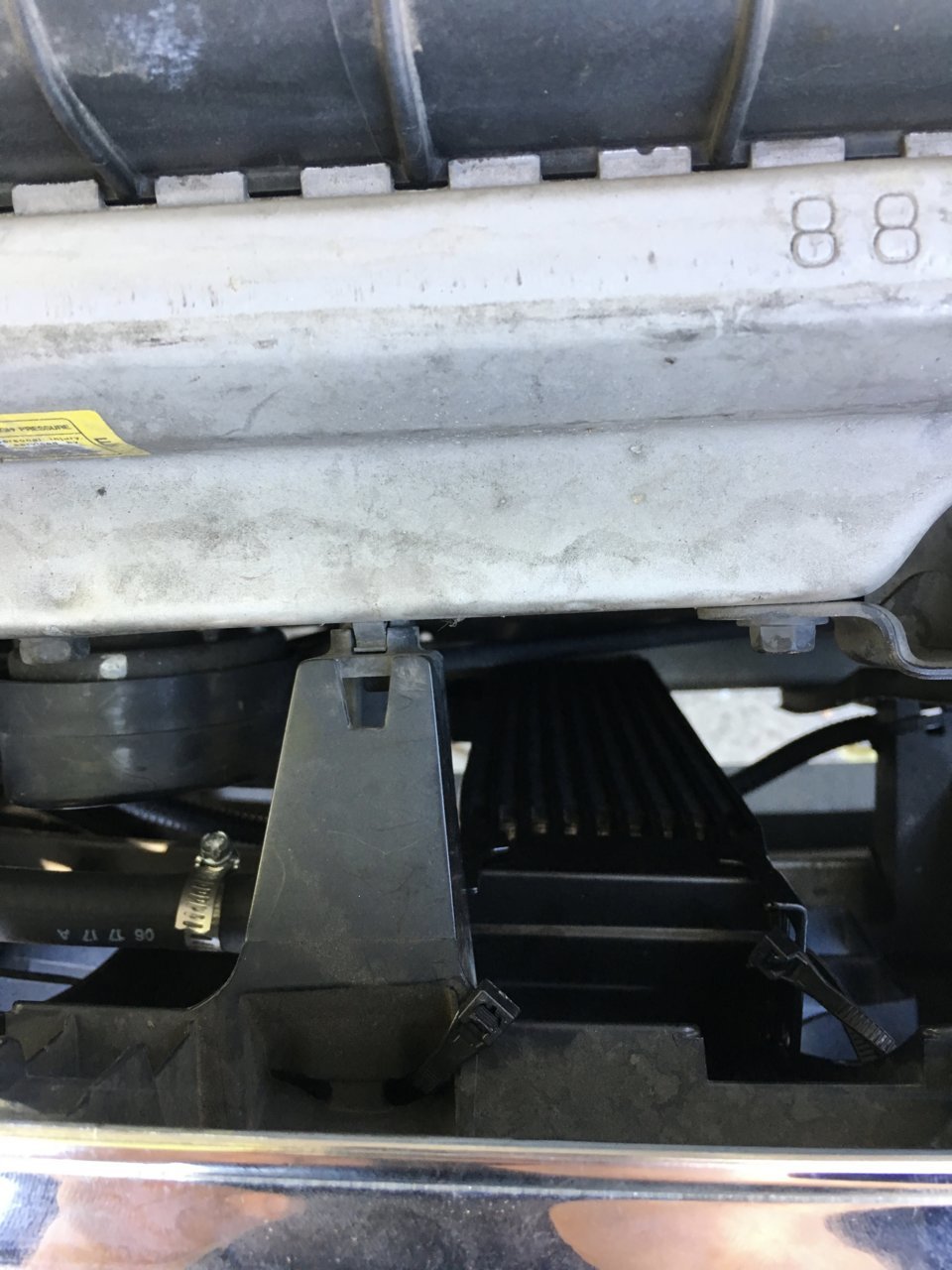

    I discovered this over a year ago and have been happily monitoring ATF temps since. Can confirm it works. What's fun to see is the temp drop quickly once up to highway speeds, tanks to the additional ATF cooler I installed right behind the grille. Also installed a remote ATF filter. ATF flows out from the factory cooler but instead of going right back into the trans, it then goes into my secondary cooler, and once coming out of there goes through the filter I installed before re-entering the trans. Both from Derale Performance. Very happy with their products and customer support.

    Depends on driving style and other factors. On average, if I’m not driving assertively, my ATF is usually around 140-150. Highest I’ve seen it BEFORE adding my additional cooler and filter (plus whatever small overall fluid capacity gain there was) I was temps almost as high as the coolant temps. ~190, which I thought was unacceptable.

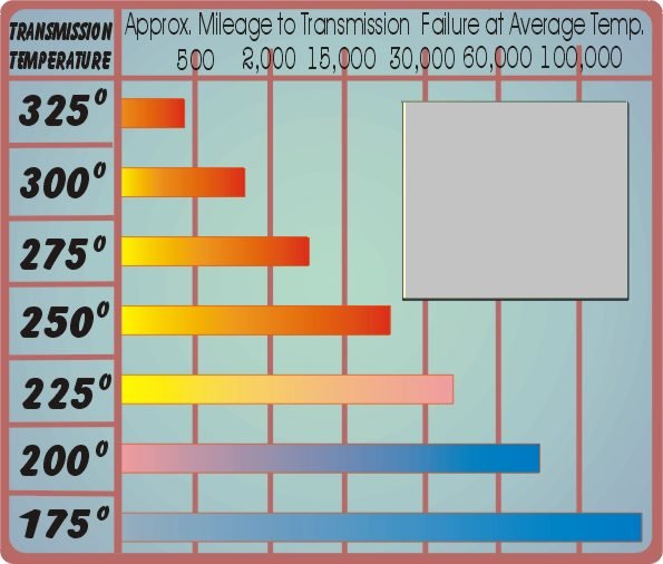

    Those are pretty cool temps. Mine runs anywhere from 140-200, depending on conditions. Highest I've seen it is 222 when I was climbing a mountain pass loaded down with the trans in 2nd. Planning on installing a cooler because 220ish is definitely too high in my book.

    Post #9, I like the filter! Should add it to my aftermarket cooler.
