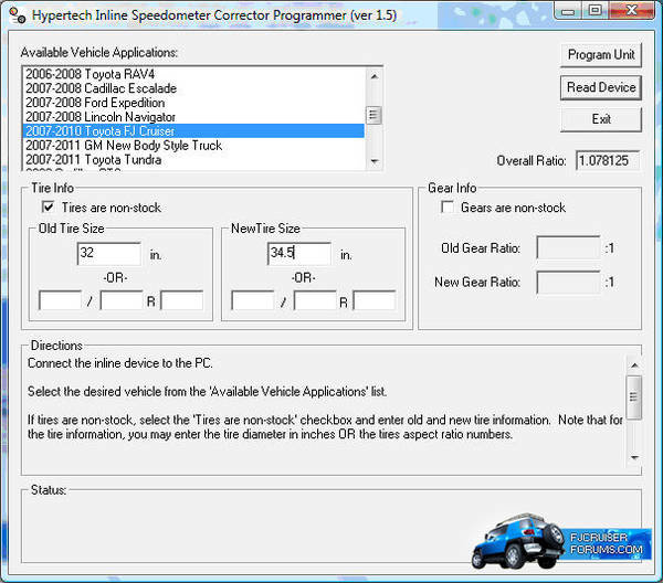

    What is the best way of getting the speed correct?

    That will handle bigger tires and re-gearing.

    Re-gearing? Uh oh... Say what?

    For an FJ, but just an example:
