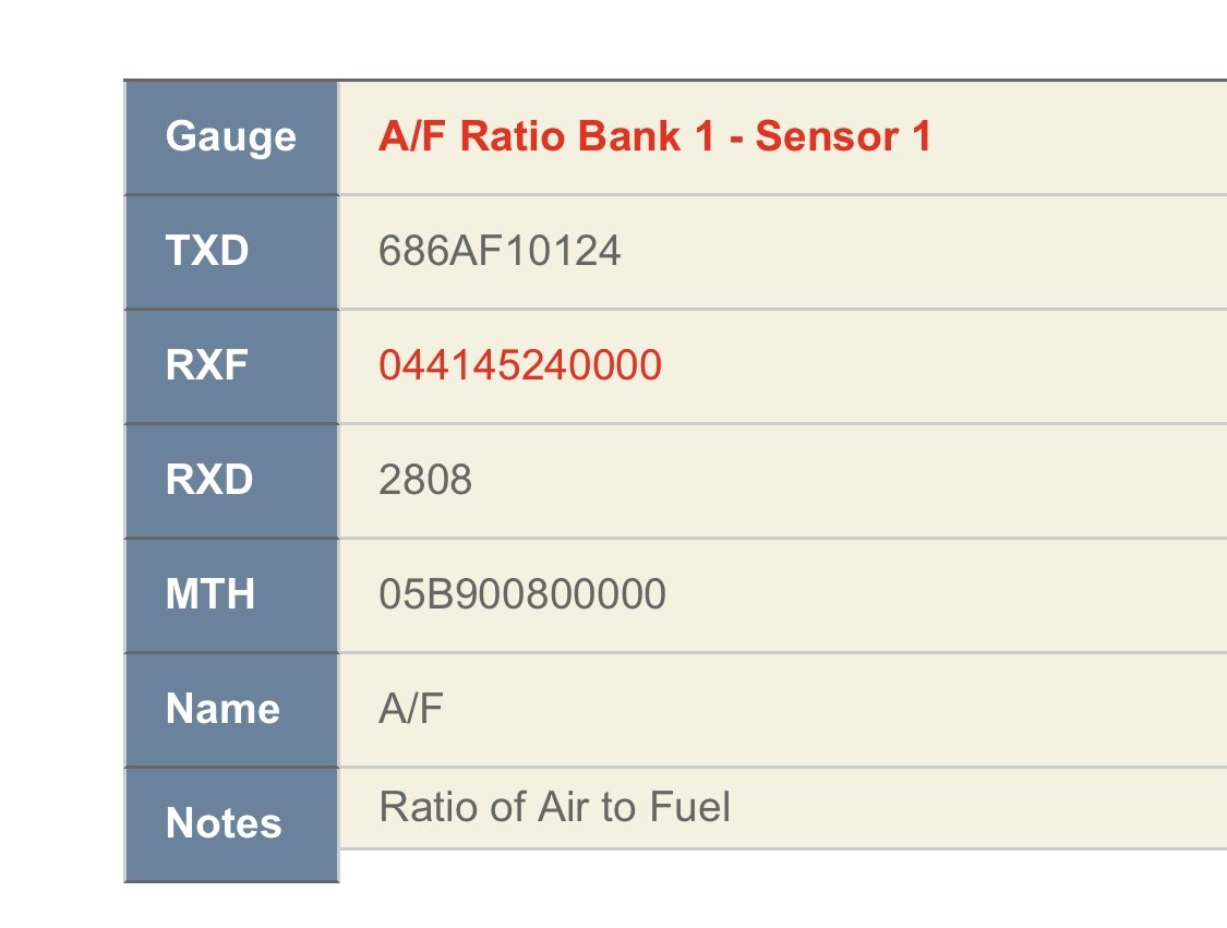

    I’m running a 04 3.4 supercharger. I’ve had my scan gauge 2 for almost as long as I’ve owned the truck. I’ve only had the supercharger for 75k miles. I never really got into the X Gauge settings of this device, but stumbled across a video on YouTube this weekend. I decided to look a little further into it and played around with it this afternoon. I’ve got an A/F ratio pid now, without installing a wideband O2! Just blew my mind, I didn’t know it was capable of it. I was wondering what other pids you guys have got to work with the X Gauge commands of the scan gauge?
    I’m running the ISO protocol and this is the command I entered to get air fuel ratio.28E732E8-9608-4C82-9E9F-B273FED04DB5.jpg

    These are the ones I have for my 01 w/ scan gauge II:
    Short term fuel trim:
    TXD: 686AF10106
    RFX: 044105060000
    RXD: 2808
    MTH: 00C80100FF9C
    NAM: ST%
    Long term fuel trim:
    TXD: 686AF10107
    RFX: 044105070000
    RXD: 2808
    MTH: 00C80100FF9C
    NAM: LT%
    Trans temp:
    TXD: 686AF101B4
    RXF: 044105B40000
    RXD: 2808
    MTH: 00090005FFD8
    NAM: TFT

    wesb1023
    wesb1023 [OP] Well-Known Member
    Apr 8, 2011
    #54586
    649
    Westley
    Eastern NC
    04 Double Cab
