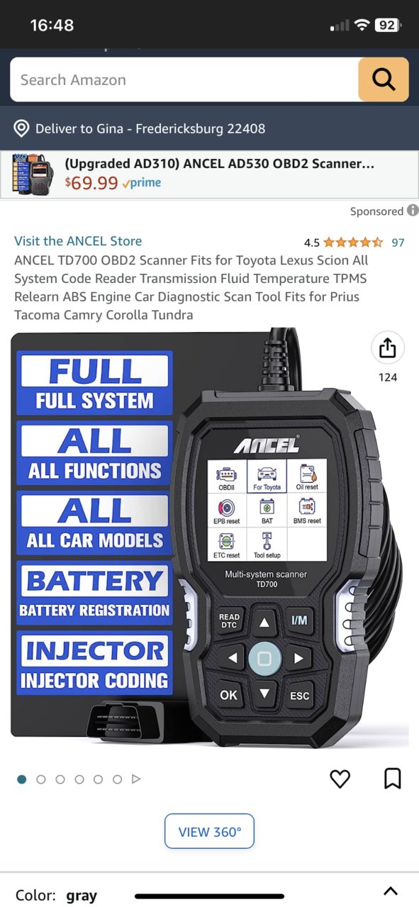

    So here is one I came across that reads trans temp AND does the TPMS relearn…just a few over $100 but close… I think I’m going to try it out…

    So... did it work? Out of the box? Did you have to program anything?

    I can confirm the Ancel TD700, mentioned above, can read ATF temps. It reads my 07 Tacoma, and also our 18 Lexus RX350. I got this code scanner to release the rear calipers in the Lexus in order to service the brake pads. It works great for that. The scanner supports Toyota/Lexus models up to 2021.
    I have second code reader, Foxwell NT520PRO, that also reads ATF temps. This model has been discontinued and replaced by NT510 which the vendor says can also read ATF temps. The 520PRO has coverage up to 2016 model years, but it reads ATF temps on the 18 RX350.
