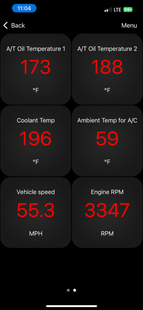

    Can confirm the OBDLink+ can read the A/T temperature. I used it to monitor temps while towing a heavy 6x12 UHaul across half the country back in November, worked great.
    This is just a sample screenshot but A/T Oil Temperature 1 is what I believe is the pan temp. I put A/T Oil Temperature 2 on my display just to see if there is a difference and yes there is in the real world. I am guessing it is the torque converter temp but don't take my word for it just observations.

    Excellent, thanks. I’m planning a drain and fill for the first time so this will be super helpful. Have had the OBDlink for a while now and figured I’d research if they have this functionality before resorting to the alternative. So, idle the truck until the Temp1 reading gets to around 100-110F?
