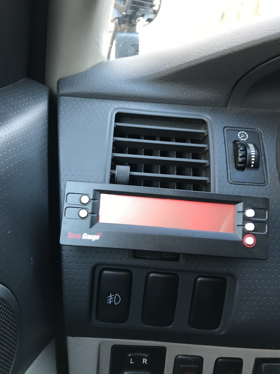

    OP here’s where I have mine mounted. I tried a couple places and this is my favorite. Ran the cord through the AC vent. You have limited adjustability of the vent, but it hasn’t been an issue for me yet.
