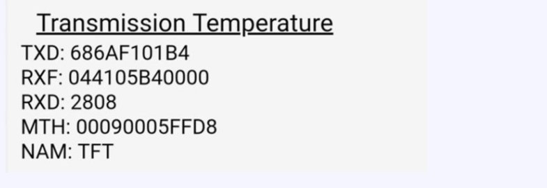

    I found some codes that I kept while doing all this research, shows as an X-Code which ScanGauge should be able to read.
    Trans Temp
    TXD: 68 6A F1 01 B4
    RXF: 04 41 05 B4 00 00
    RXD: 28 08
    MTH: 00 09 00 05 FF D8
    This one seems to be the one users say works the most for the 01-04 Tacomas but as I do not have a scangauge yet cannot confirm this working or not. I am still trying to see if I can find a scangauge anywhere for cheaper than retail.

    This is the code I used. As mentioned, it has to be a v2 ScanGauge.

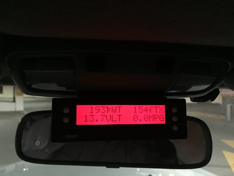

    Well looks like it works, got my SG yesterday and put the x-code as above and I have auto trans temps now. When I do some towing now at least I know if I am cooking the trans before the light on the dash comes on. Top right on the SG is the trans temp and it seems to like to run around 150 depending on weather I am on the highway or running around town.

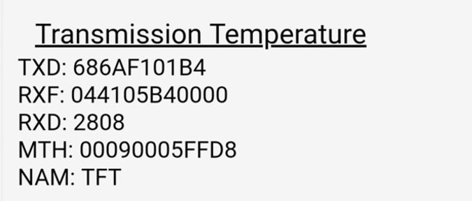

    Just to clarify we are using these codes correct and ill double check my codes when I get home I had thought I double checked them but I could be wrong thanks

    Yes. The codes I use. Works on 99 Tacoma and LX470.
