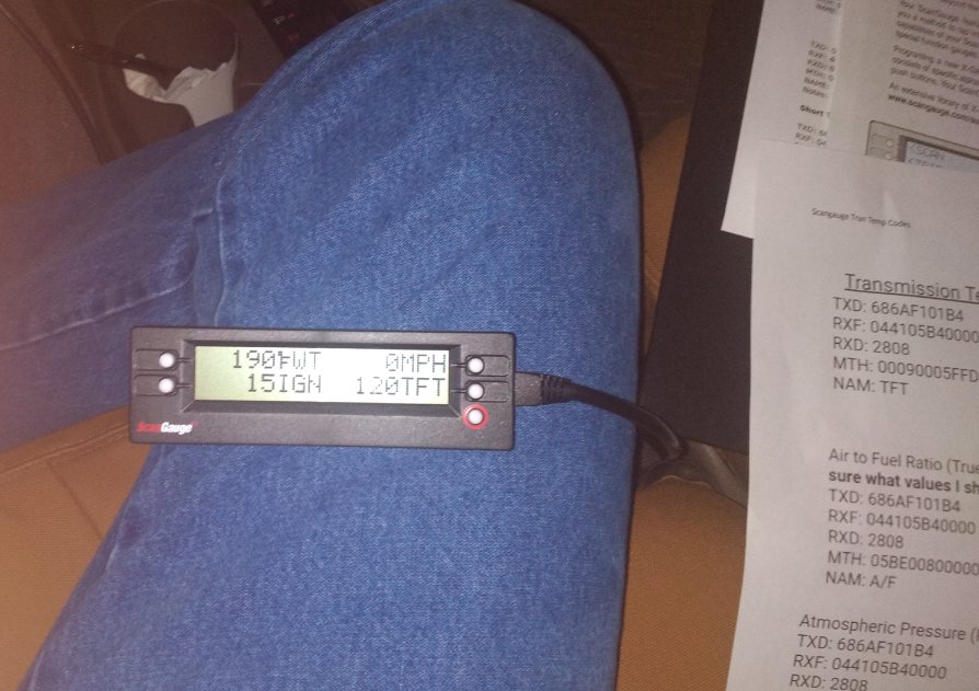

    Just used this on my "Scangauge II Ultra" for the 2003 Taco.
