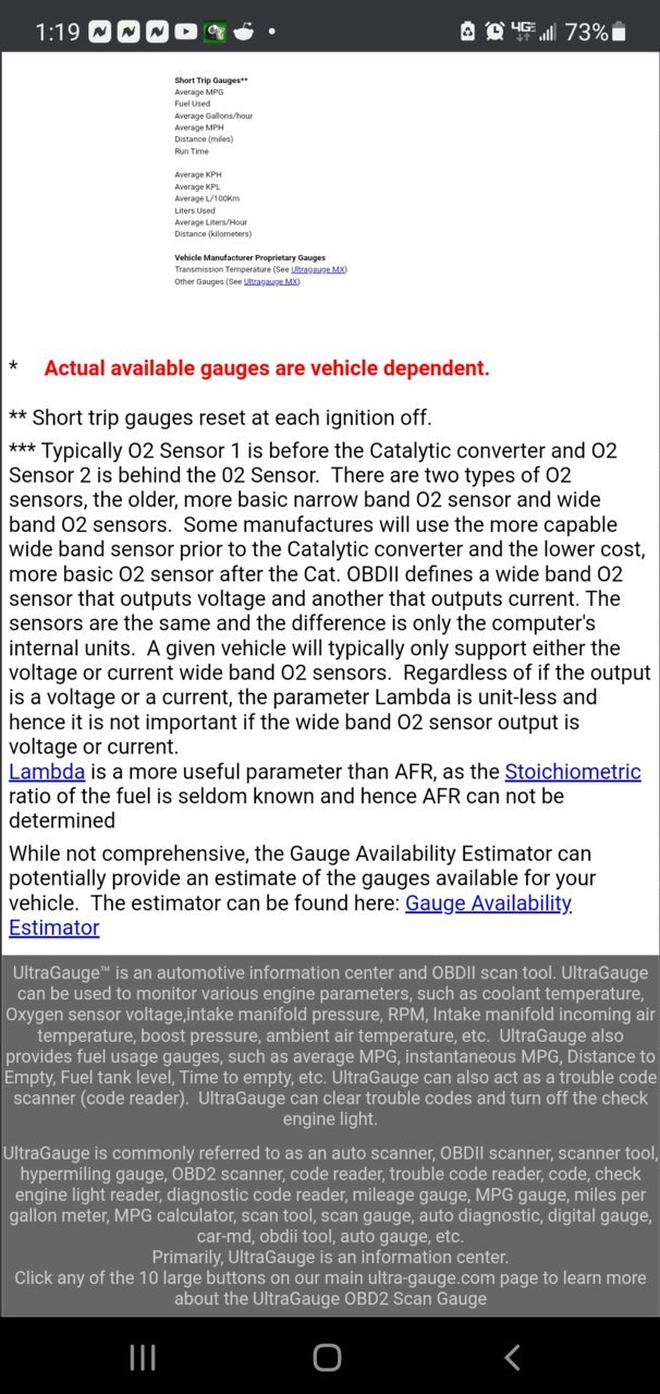

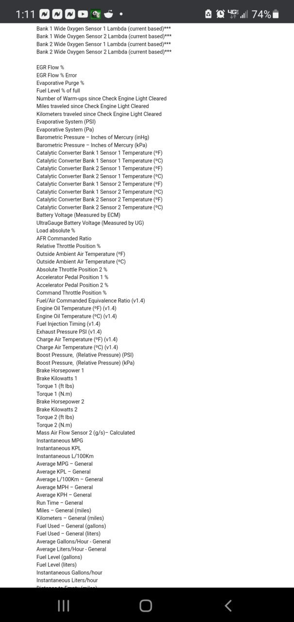

    So do any of these readers read afr? I’m trying to watch them closely because I’m running the trd supercharger with the URD upgrade kit

    @James_tburg it looks like it does I took a screen shot of guages now im wondering if it reads engine oil pressure couldn't find it on there page Screenshot_20210618-131146_Chrome.jpg

    @chirkin ok cool, I ended up buying an aem aft gauge and an ultra gauge, I just need to install a banjo bolt to include fuel pressure because I don’t think my truck came with a sensor for it

    @James_tburg that's good to know about the oil pressure because I was gonna buy one hopeing it did oil pressure since I'm getting a rebuilt motor put in and dropping so much money I figured it would be worth it.
