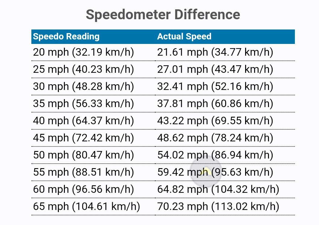

    I have a question about calibrating the speedo on my scangauge. Stock wheel was 265/70/16,I wanting to go to 255/85/16. Am I able to use just the tire calculator speedo difference? Screenshot_20200229-161322.jpg

    It’s not work with Scangauge. Use Speedohealer, then Scangauge will get the same reading.
