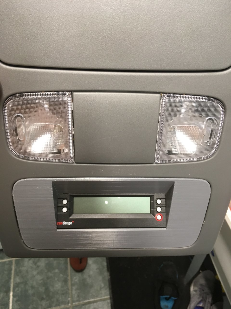

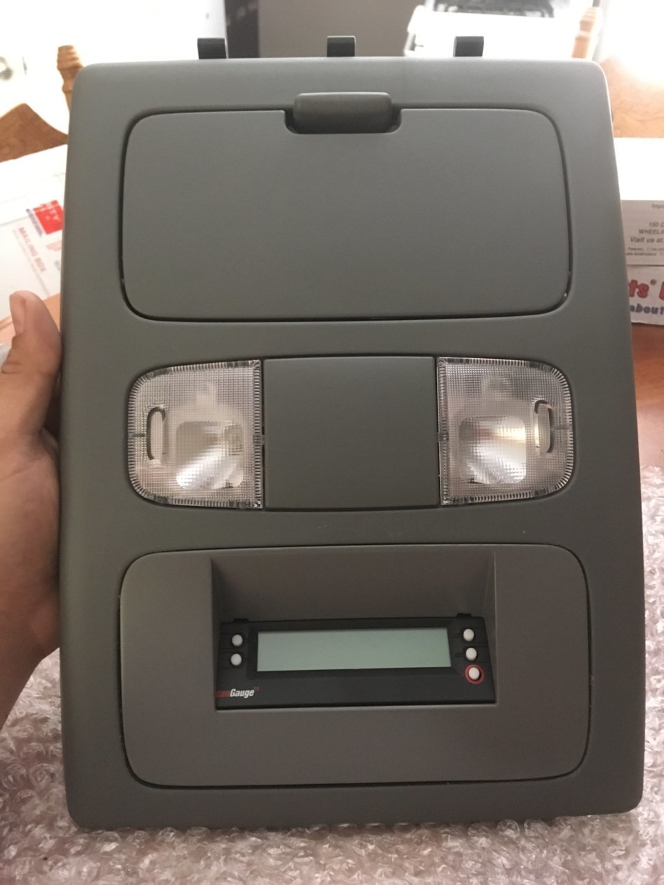

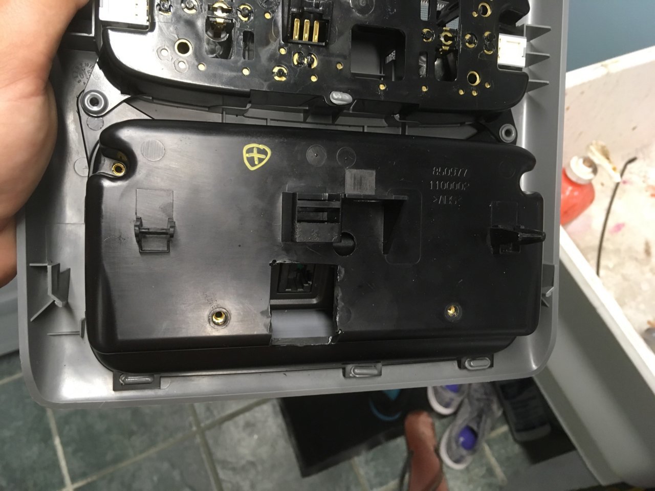

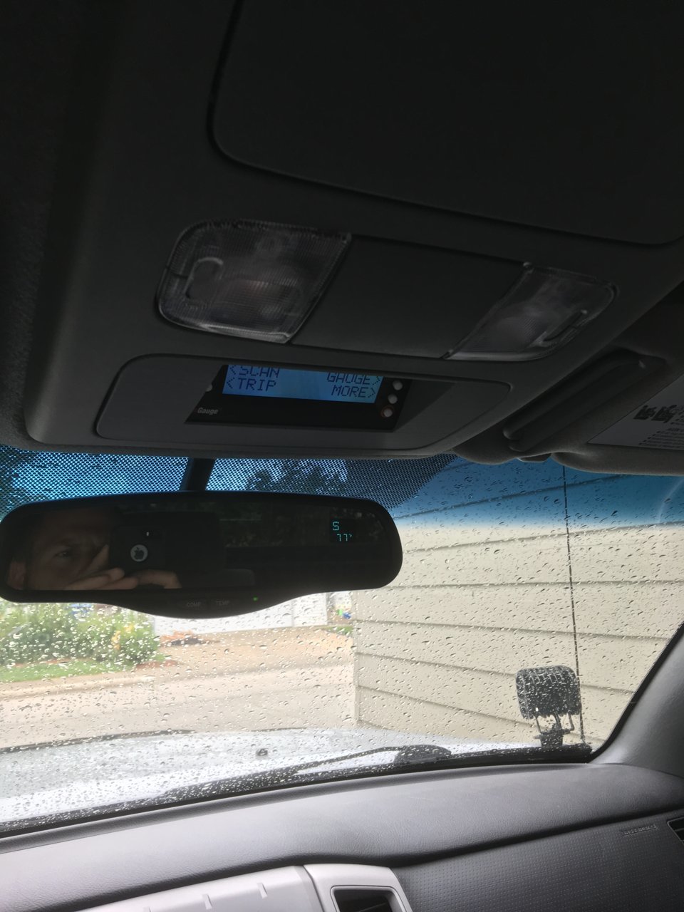

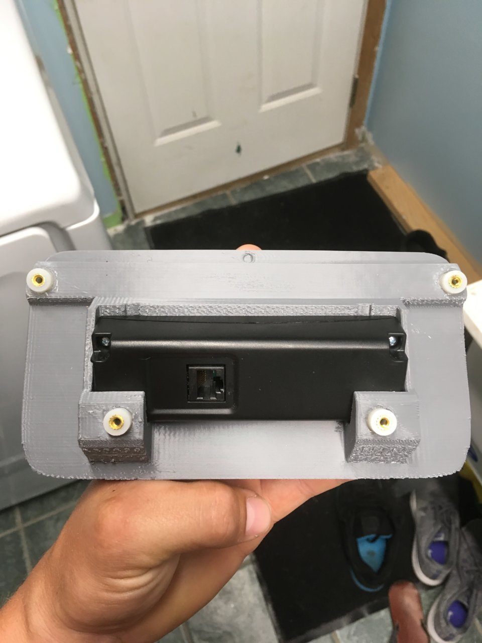

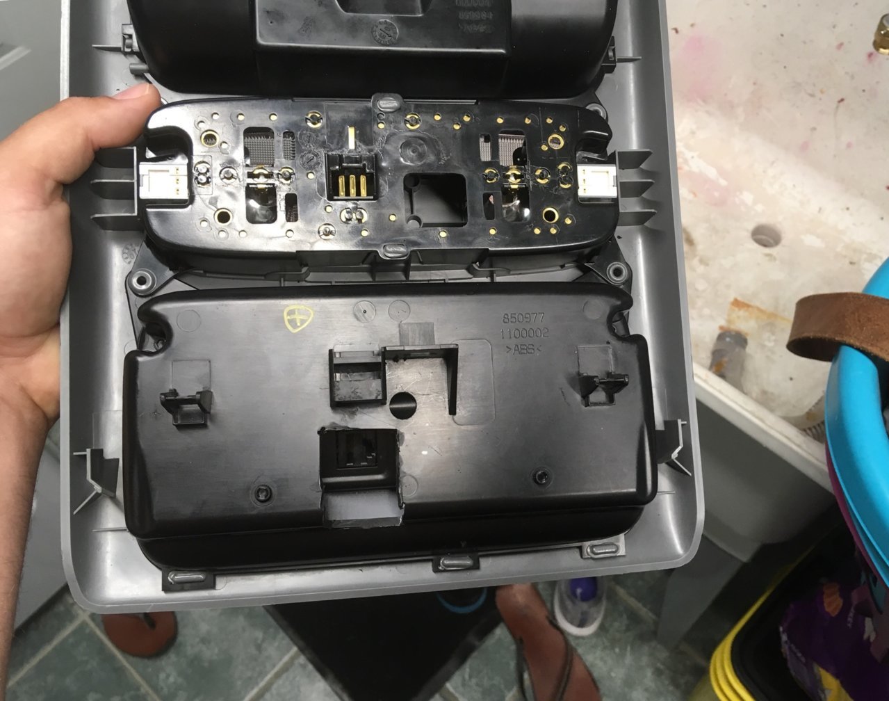

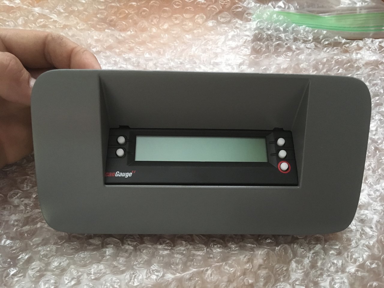

    I was looking for a oem looking scangauge mount. I was really surprised I couldn’t find one on here especially with as many people that make their own stuff on here. I was looking on eBay, I came across a guy that made one for his land cruiser. I messaged him to get measurements or see if he could make me one. He was really cool and had no problem making one for me. I just had to send him my overhead council so he could see what he could do. He said it took him twice as long as on his land cruiser because of how tight of space it was. It came out great though as you can see. I wanted to give him a shout out cuz it was a absolute pleasure to work with him and I figured a lot of you would like this a lot I was updated the whole way through.

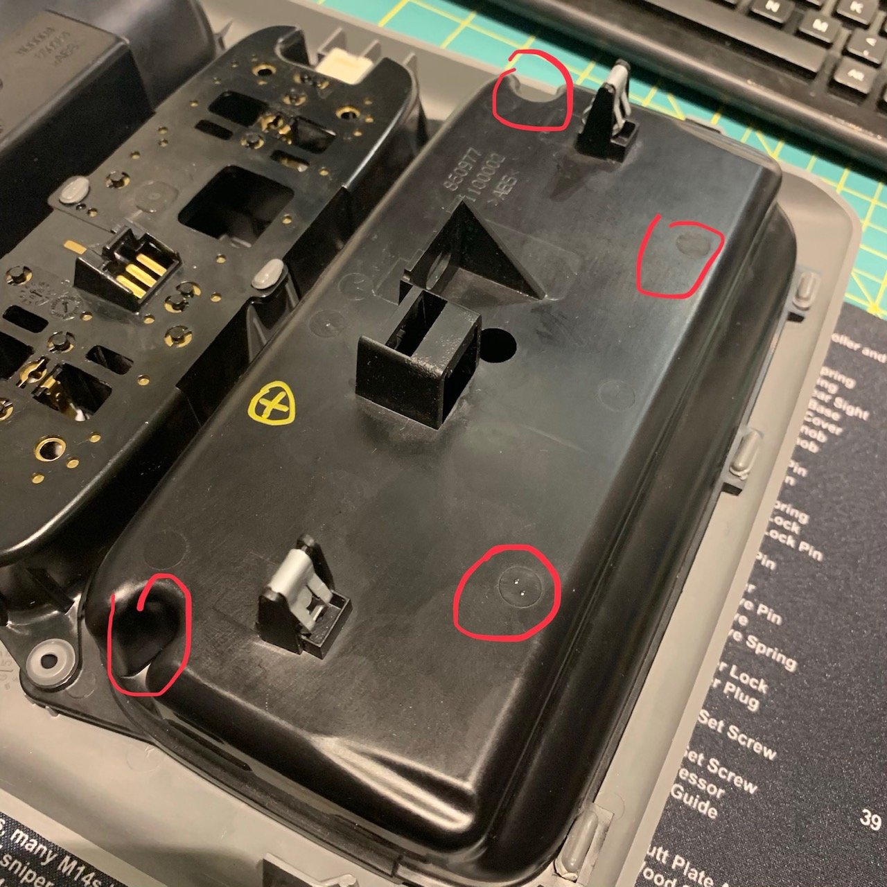

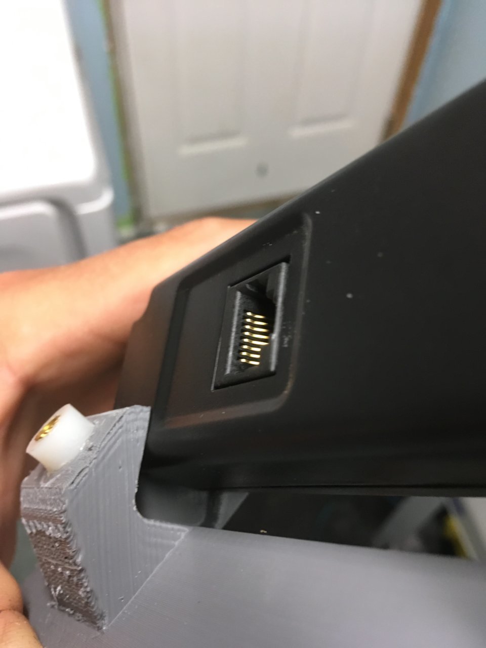

    The way the mount is mounted is with 4 thumb screws. You will have to drill 4 holes and remove the tabs from the sunglasses holder hinge. You will also need to cut a hole in the council for the scanguage plug. The scanguage slides into the mount itself and is very secure.
    The only thing idk is if the 12-15 are the same. So if someone can confirm this that would be nice.

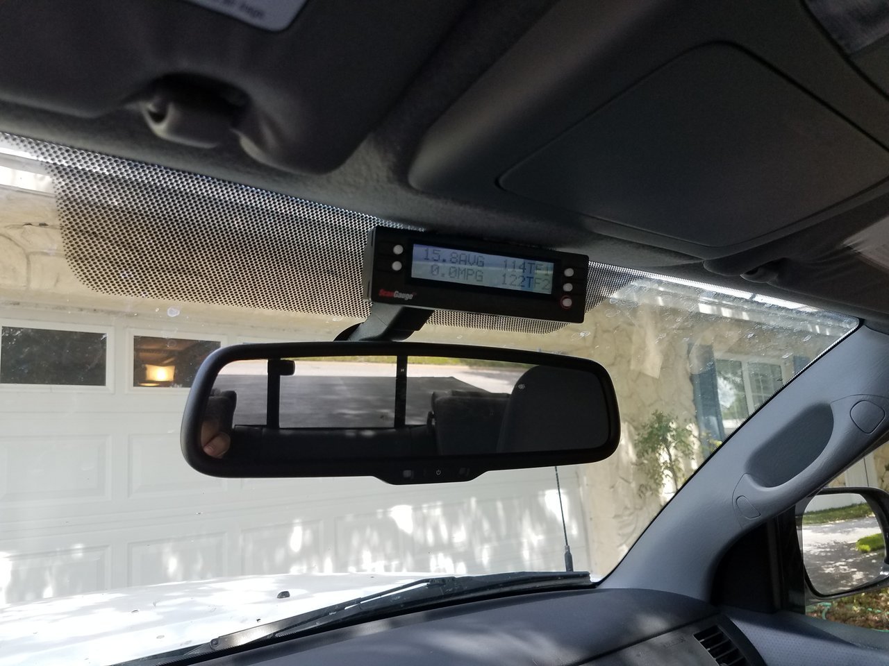

    Very nice!
    Make me feel inadequate with my $1 of velcro install.
    Although it doesn't look all that bad, does it?
    It really is slick. But not sure my 5 lug deserves it. :anonymous:

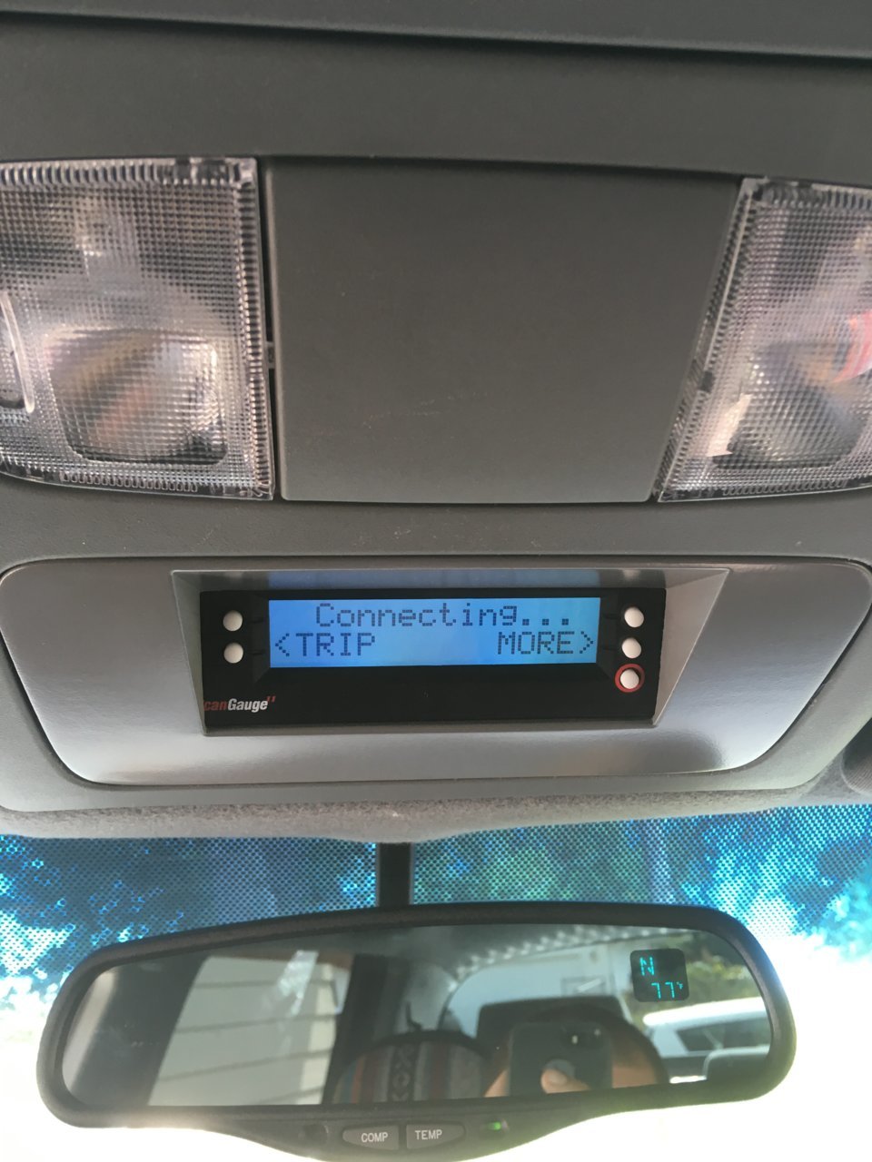

    I finally finished sanding, put puddy on and painting. It came out really nice.E66B204F-6112-411C-9A94-4540F1593388.jpg3C0123C0-5A69-452F-9096-18A5A39507CE.jpg10C297DB-8E23-44DB-8A4F-B2E3FA900281.jpg
