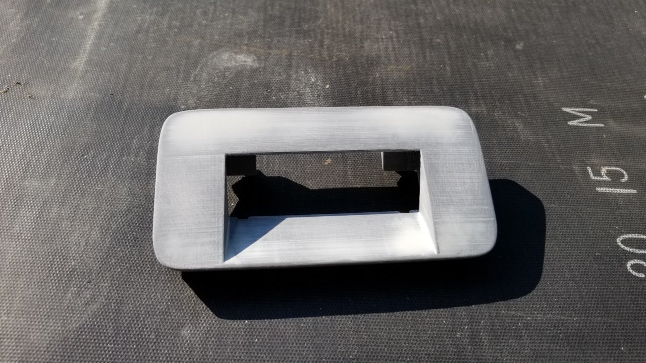

    Got any pointers on the sanding and finishing part? I was going to use the Bondo Putty I had, certain grit you finish with or anything?

    It was really simple. I way over tonight about it. I used spot putty. Its really easy to work with and it sands fast and easy. You can put multiple layers in as you want. Primer fills in a lot of holes. I did like 6 coats and sanded alot. I only used 100 grit and 300 for the final coats.IMG_20190906_020344.jpg

    Perfect, same bondo putty I have. Thanks man! Yours turned out great!

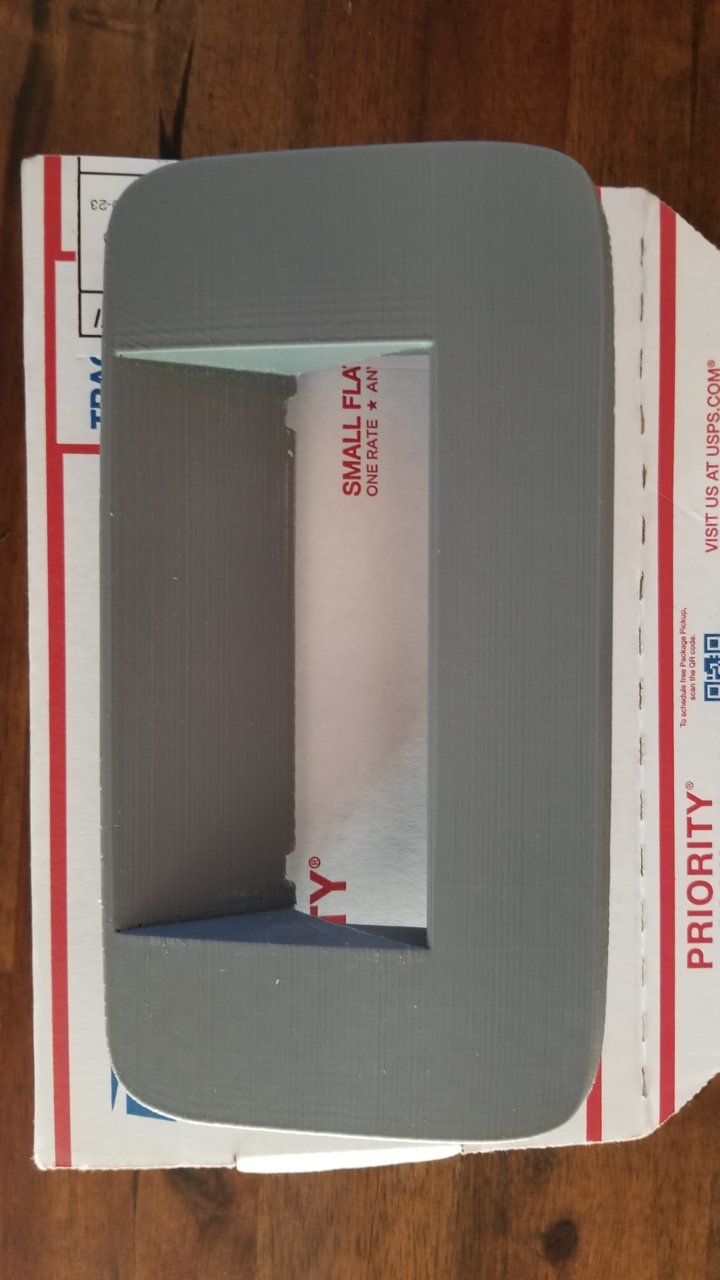

    Well the overhead consoles are NOT the same. Apparently it slightly changes when you have the Audio/Entertainment package with the microphone in the console.
    Toyota decided for whatever reason to make the console just slightly different. As you can see where the new thumb screws go in on yours, part of the console has indented spots for the screws closer to the middle. I do not have those 2 spots on either side.
    That being said I am hoping to figure out a solution as it still fits just needs to be secured differently.20190906_100932.jpg 20190906_100926.jpg

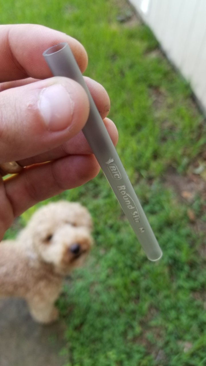

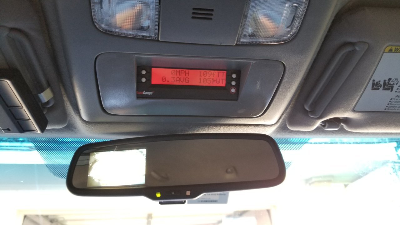

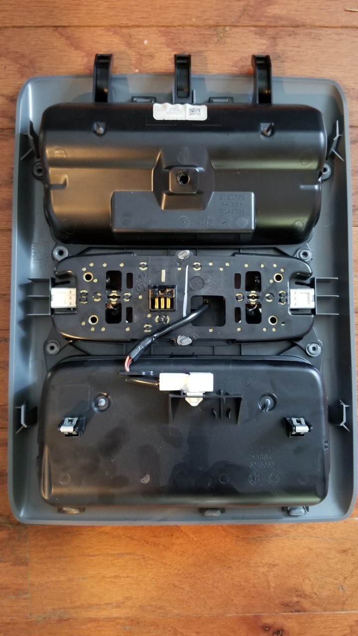

    I finished my install, took a little longer than expected. The threading on the 3D printed piece, for the thumb screws, is the same threading for electrician screws, the ones you use to screw outlets into boxes. They sell a little various size kit at Home Depot.
    So what I did is cut a BIC Pen tube down to (2) 7/8" long pieces and used them as backing/support for the longer screws to reach the 3D printed piece. I still used the supplied thumb screws for the front of the piece where it fits normally into the pocket...Worked great, wouldnt say it was an ideal install but I dig it. I suck at finishing/sanding so I might give that a shot again when I feel like taking it a part. Good luck!
