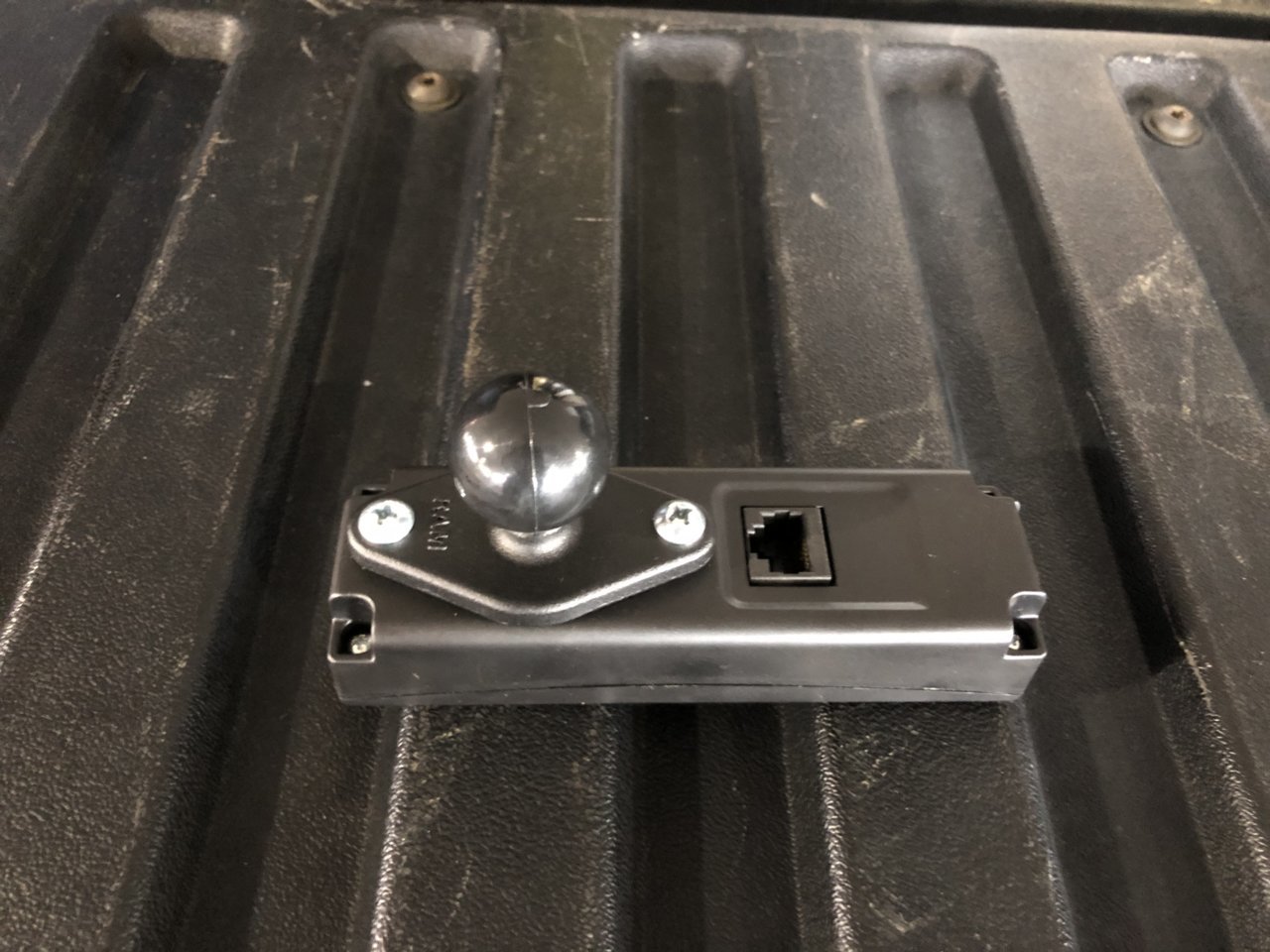

  7. Feb 3, 2020 at 5:06 PM
    #67
    j4kc87
    j4kc87 New Member
    Dec 14, 2019
    #313289
    3
    Ohio
    2008 TRD Sport

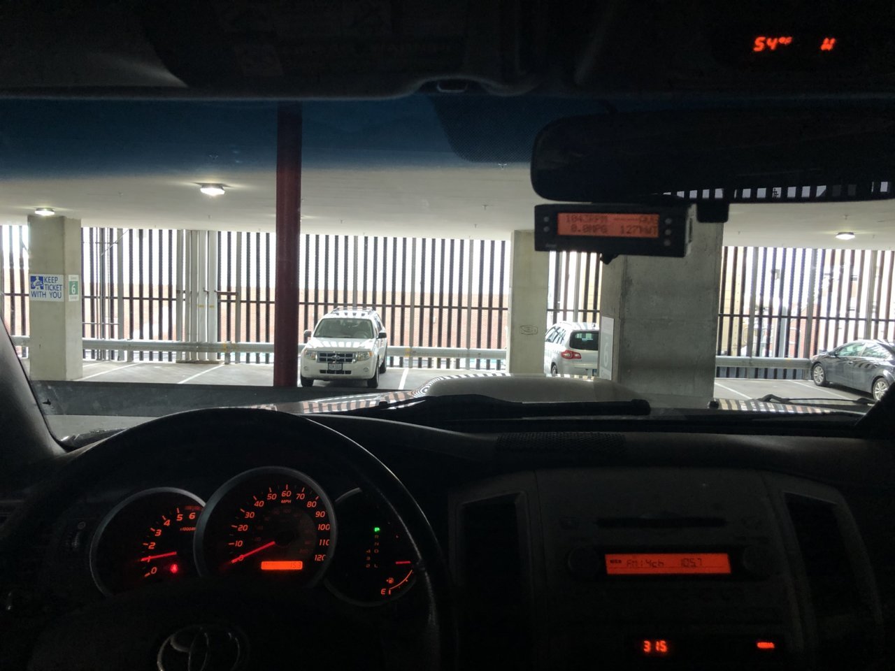

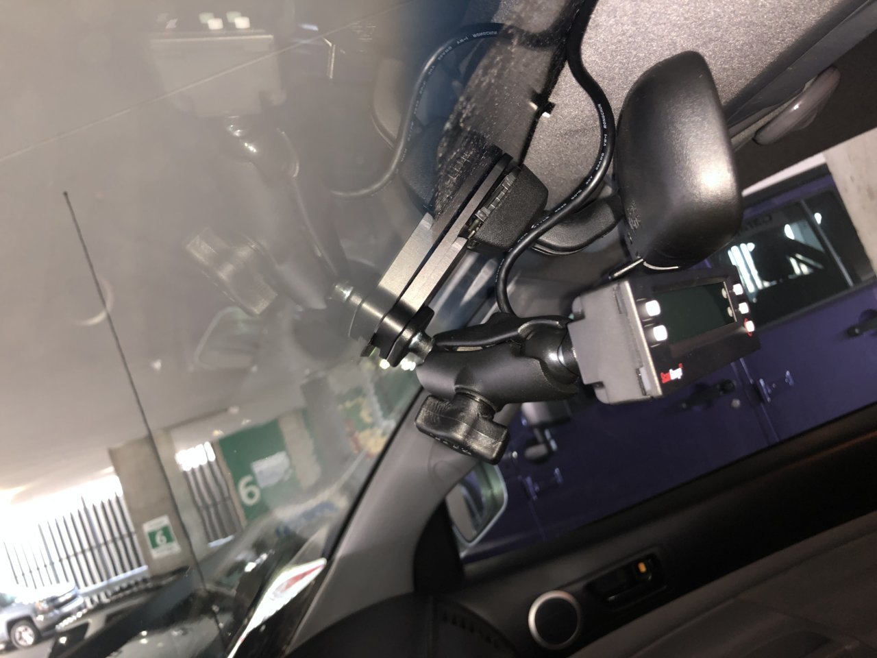

    Did this today with birddawg mirror riser and ram mounts. A621DA0A-3049-47AA-AF10-14679461008D.jpg14BA6F3A-3909-428B-A96F-2625291E164E.jpg

    No. Scan gauge small, mirror big...
    I do like how clean the scan/ultra gauge looks mounted in the overhead console. What I like about this is that I can grab it off the mount and plug it into another car easily. Plus, as a gauge cluster I prefer it closer to my field of view

    OME Dakar Medium duty rear leafs Total Choas UCAs Elka 2.5” Extended Travel CO and Rear Shocks w/ RR and DC FN FX Pro 17” Silver Rims Nitto Ridge Grapplers 285/70R17
    so just screw the ram mount to it? Small knuckle to the ram ball on the bird dawg riser?
  11. Feb 6, 2020 at 5:08 AM
    #71
    j4kc87
    j4kc87 New Member
    Dec 14, 2019
    #313289
    3
    Ohio
    2008 TRD Sport

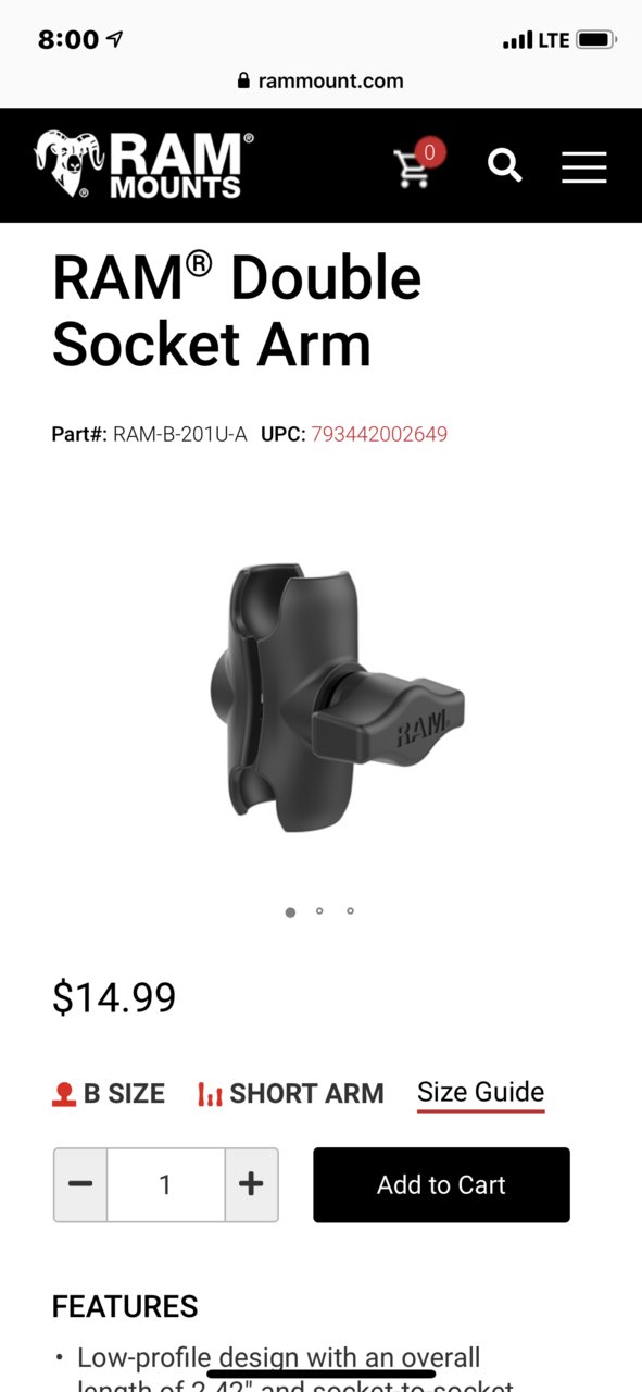

    I was originally going to just drill holes and through bolt to a nut but I stopped at 5/32" drill bit and realized if I didn’t make the hole too big a screw might tap into the plastic back.
    Take the back cover off, set the base where you want it (just barely enough room between the wall and the cable port) and mark your holes. drill your pilot hole and graduate up to 11/64 (i think, stop at 5/32 and check to see if a screw will start to thread itself) A 3/8“ long 10-32 machine screw should thread nicely into the plastic, go slow and straight. With the ram mount diamond base mounted to the Scangauge, the 3/8" long screws are the perfect length.
    If you didn’t buy the riser with a 1“ ball on it, the holes are tapped for a 10-32 screw, 1/2" long and they won’t make contact with your windshield. I used ram mount diamond base size B (1“) ball and the size B short arm.

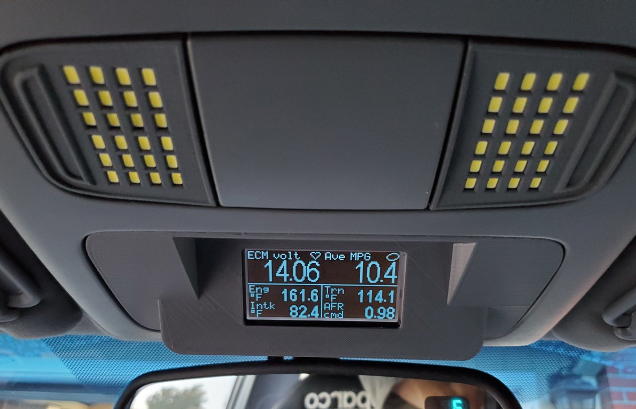

  15. Jul 14, 2020 at 9:33 PM
    #75
    will.i.was
    will.i.was Well-Known Member
    May 6, 2018
    #252688
    1,705
    Will
    Houston, Texas
    SC 2.5

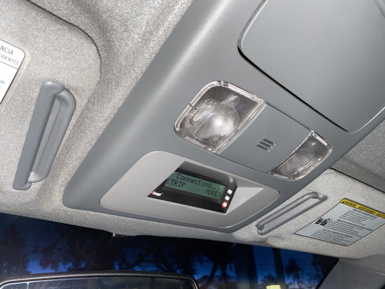

    Here was my recent solution. Will sand it down and repaint to match interior color. Love the functionality and use of space. I'm surprised I went this long without a scangauge 2!

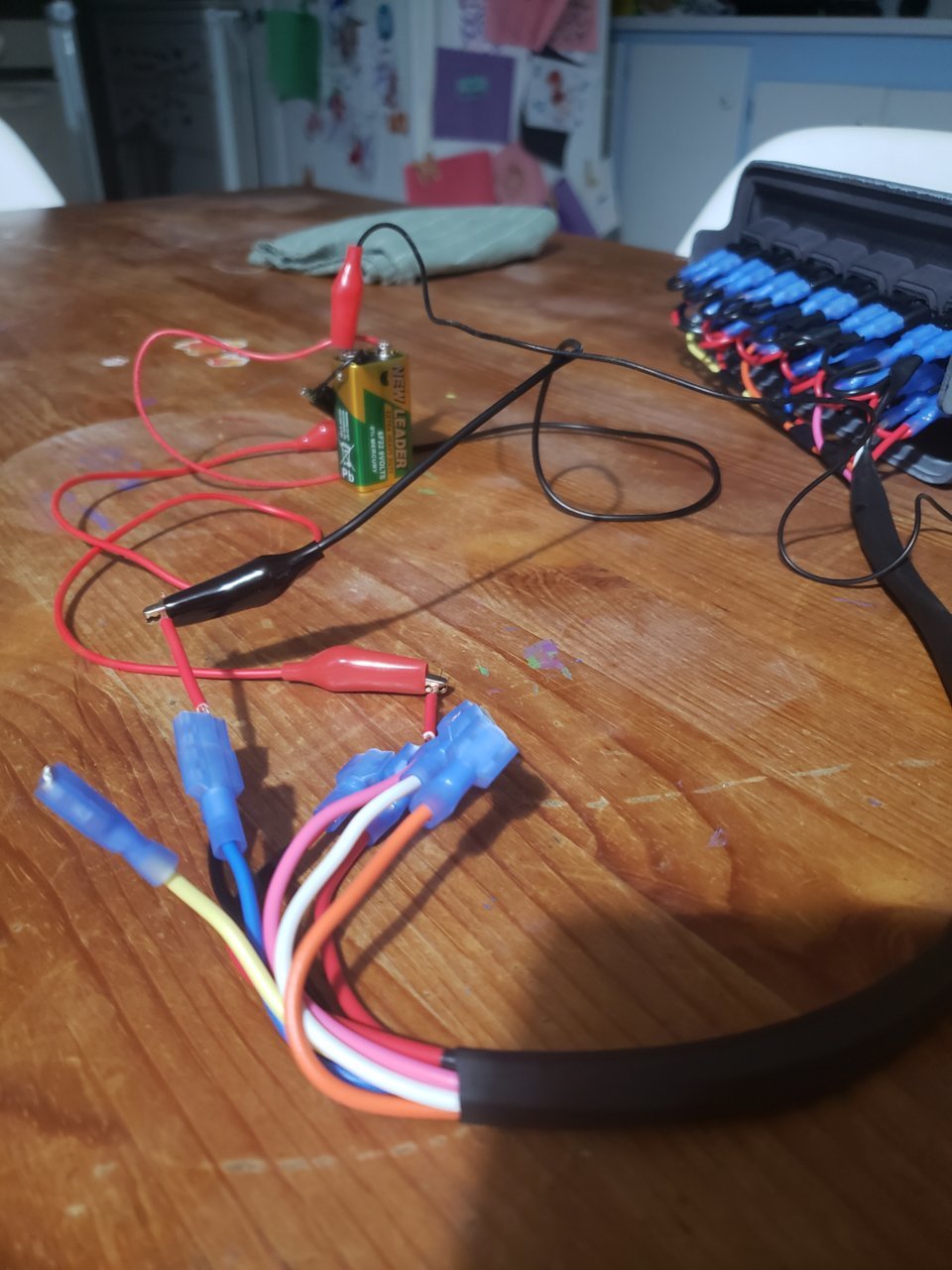

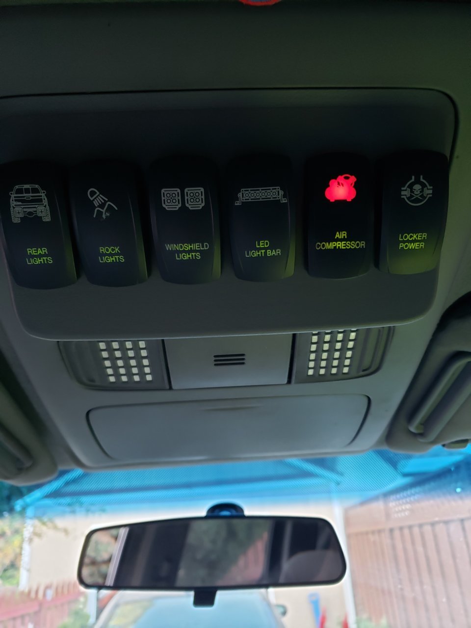

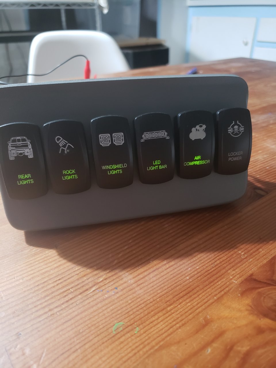

    #78
    Taco-Obsessed
    Dec 23, 2018
    #276756
    7,448
    Thanks, it's a Meso panel. I got it all daisy chained and clean in the back. I wired it so my compressor switch must be engaged throwing power to the compressor for the locker switch to get any power. I think adding the scangauge in the other holder would look damn good and also functional and out of the way. 20200425_225315.jpg 20200425_225434.jpg 20200425_225351.jpg
