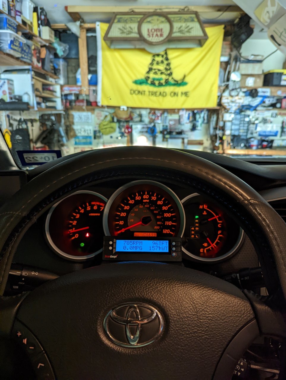

    Put mine on in front of the instrument cluster to not see the tpms light anymore

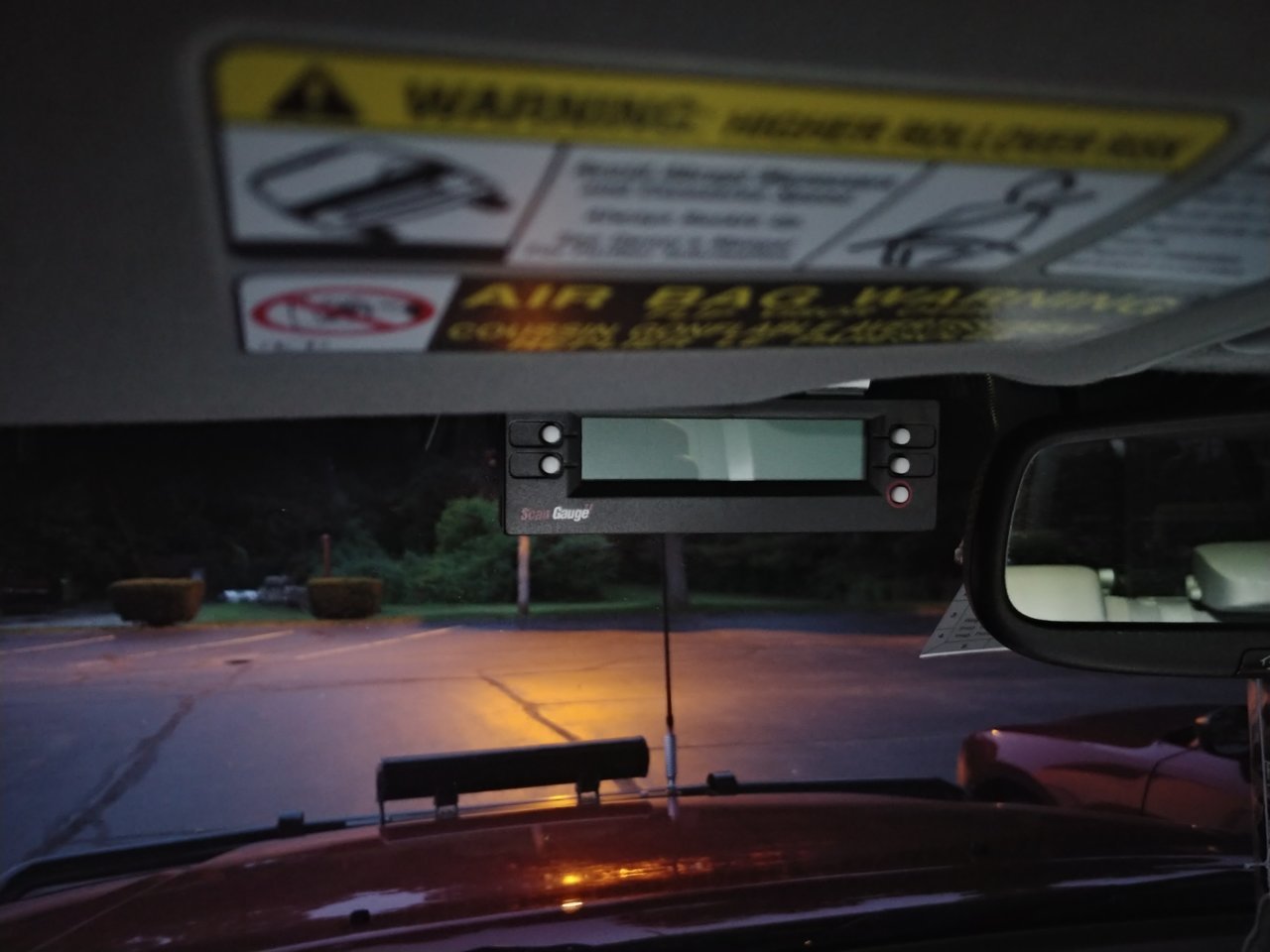

    On mine I bought a cheap tape measure and took the belt clip off it. Take the scan gauge apart and drill a hole in it and put nut and bolt to hold the clip. You can pull the headliner down a bit to slide the clip into and run the wire along the front and down the A Pilar. Take the cover off and you can get the wire down under the dash and it’s just long enough to plug in right there.

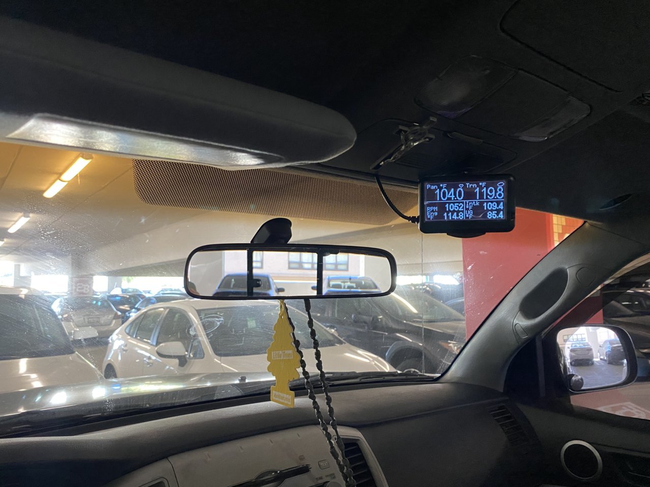

    I have an UG, but it's mounted at the very top left of the front windshield.
    edit: Added the picture. The wire goes down the A-pillar underneath the plastic. I have an OBD splitter so that I can have the UG plugged in and still have access to the OBD port. I'd assume you can do the same thing with the SG.

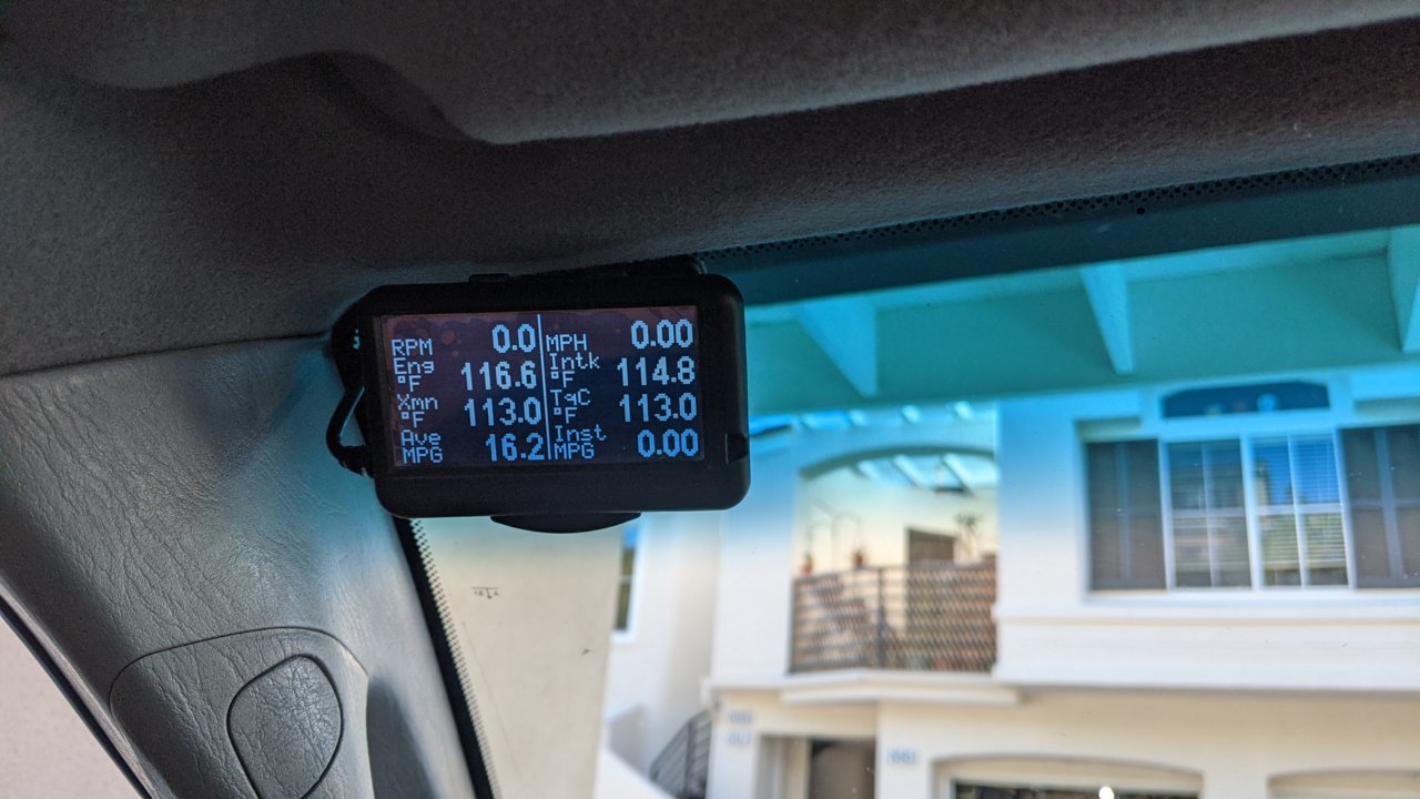

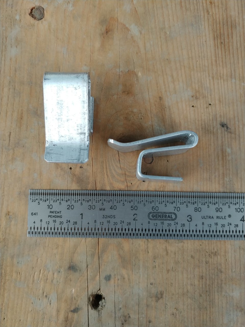

    Same. I made some homemade clips out of thin 1" aluminum strip and mounted to the headliner left of the mirror. If you have a mirror riser you cant go above the mirror.
    Same here.
    Roughly how it looks from the drivers seat, nice and tucked up out of the way. Been running solid for 3+ years there

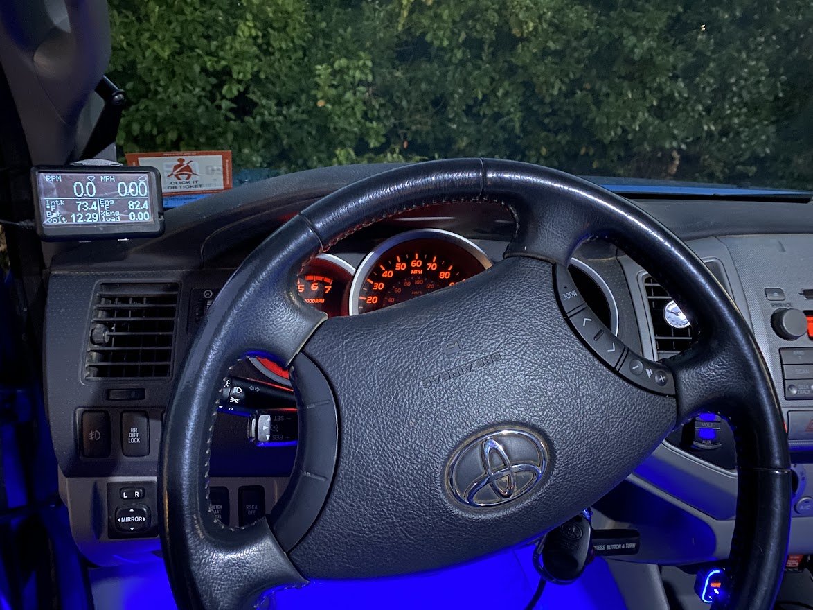

    Opted to avoid the windshield so I can use my sunshade. I don’t have a garage remote and figured this was a nice spot
