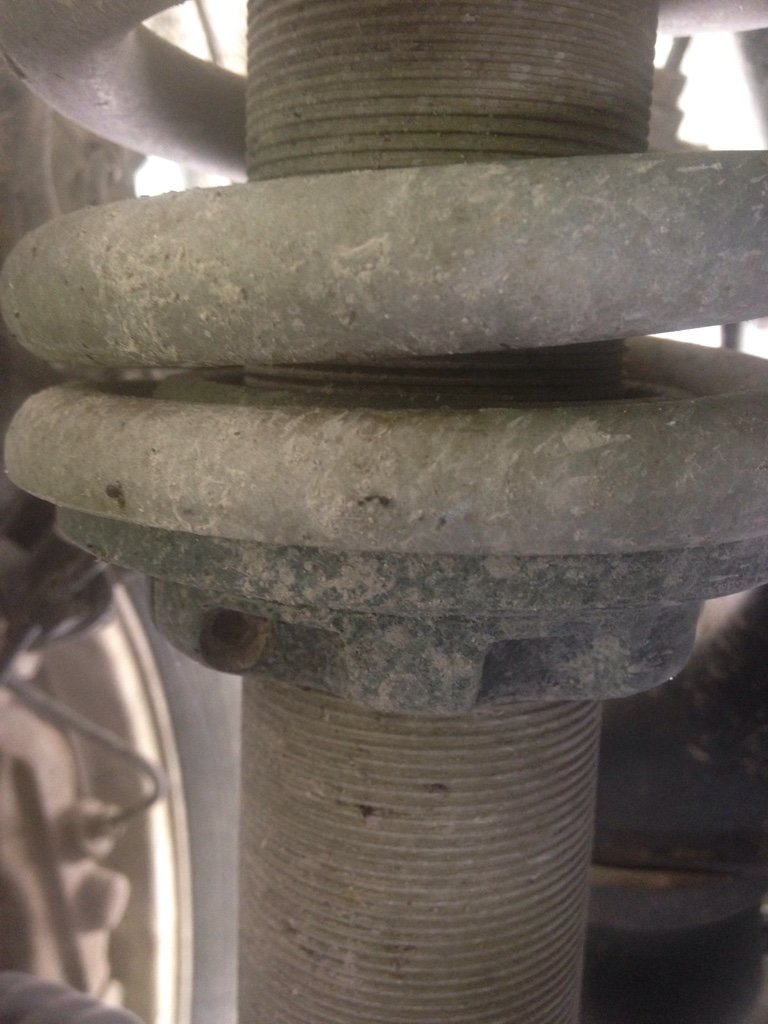

    I need to adjust or get bigger coils. I'll prob adjust for the time being

    Lol speed bump clunk. I gun it at speed bumps and feel nothing.
    Anyone have a spanner wrench I might can use? I know there different sizes but maybe it'll fit

    It looks like it has an Allan wrench head on it though

    I messaged Cham on Facebook and I know he's adjusted his. I'm afraid on these you have to take the weight off the coils

    I'm gonna try that lol might make it easier. I'm wondering If I can somehow compress the spring then loosen the collar and turn it by hand

    Nope one point on the collar. Let me put my contacts in and I'll go out and take pics

    jack up the front end, spray some pb blasters (or whatever similar) on the collar, then adjust away.

    What about the spring putting weight on the collar? It'll be hard to adjust up right?

    it's easier than doing it w/ the wheels on the ground...lol. i've seen many COs adjusted that way.
    no spanner w/ OME, old man...

    no COs and nothing ficticious...i'm running those 16" 700# king springs on my walker evans shock bodies.
    definitely need to soak those w/ some lube for a bit. it wont be as easy as spreading butter, but you wont have to disassemble the front end to do it. if it wasnt obvious, removing the tires would be needed.

    But no spanner needed?
