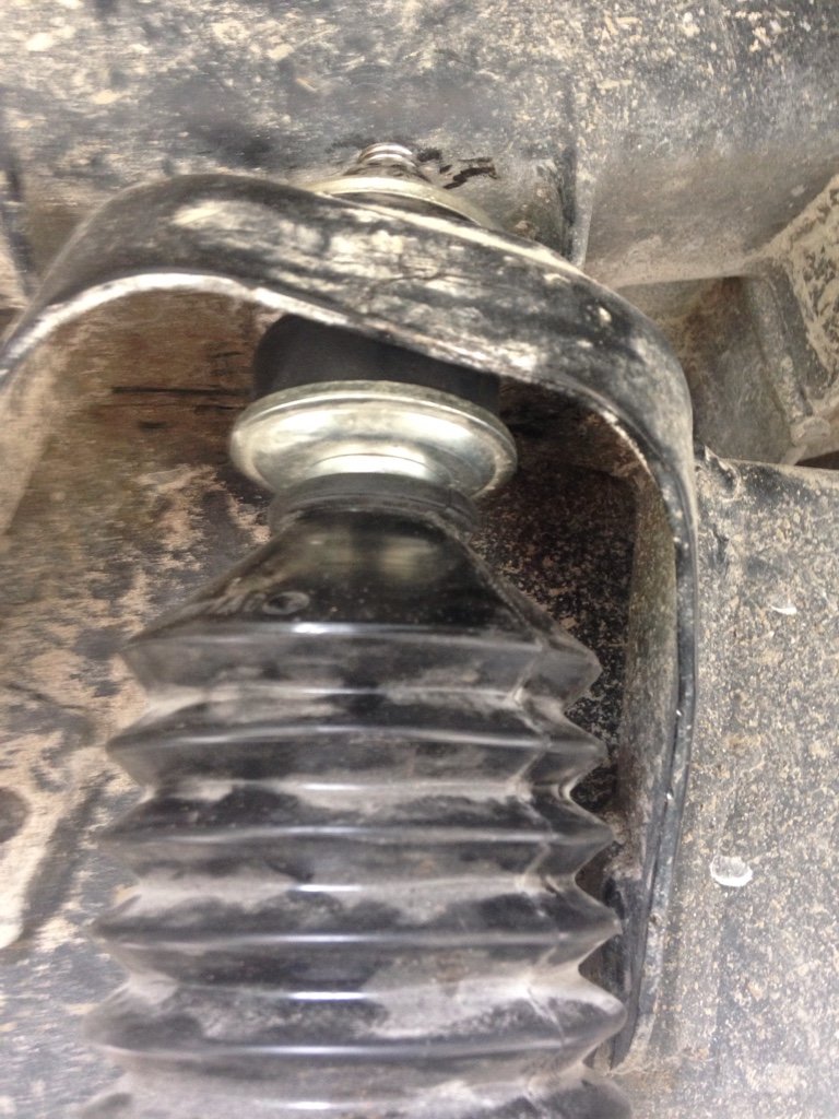

    this is the order I put them on from bottom to top. Washer, bushing, washer, mount, bushing, washer, and nut.lol

    All better lol now I need another zip tie to hold down my boot

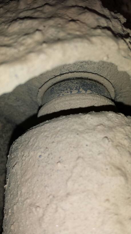

    My OME under all the URE mud. Same configuration as threemile

    Is that a washer between bushing and mount?

    Same as yours , 3washers.
