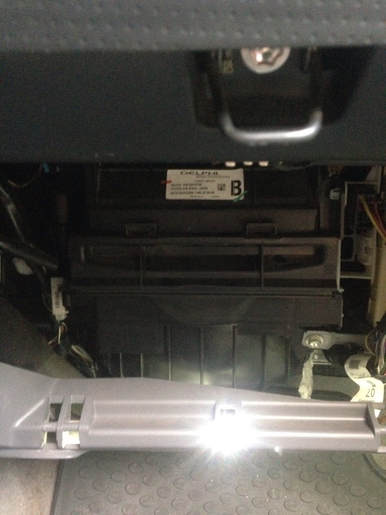

    No the resistor. Pull that. There's a couple terminals on it and that's why everyone's symptom is different because each terminal controls something different. The wire is severely under gauged. First check your air filter and stick your hand in the fan housing to make sure nothing fell in too. Pics of the process inbound

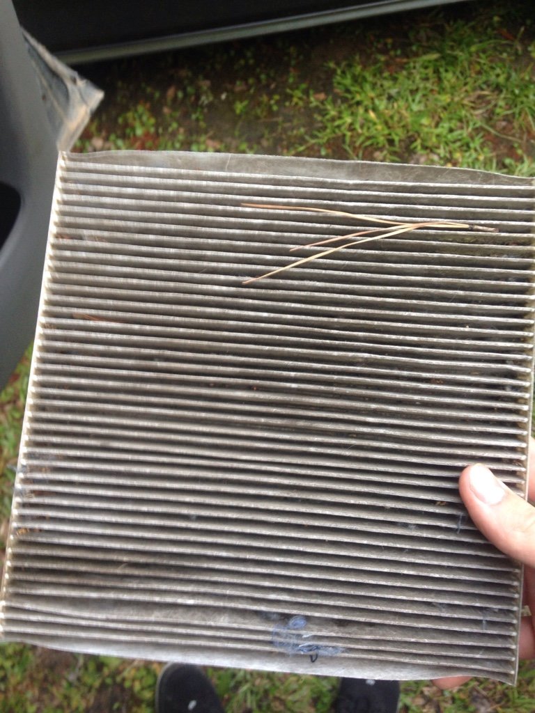

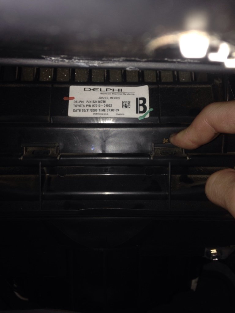

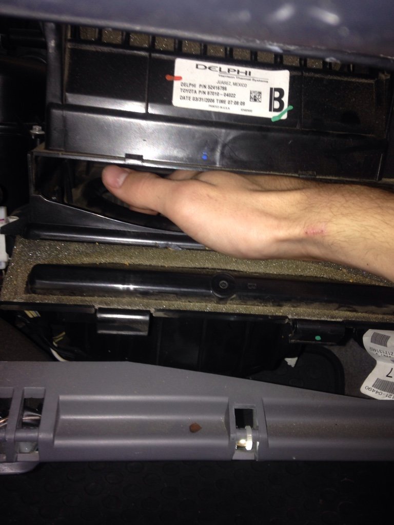

    Take your glove box out
    Pop this thing
    Clean this or replace it
    Put your hand in there and spin the fan and feel for anything. Any excessive load will make that resistor burn up again quicker
    Close that bitch up the same way you got it open. There's arrows on the filter for which way to go.

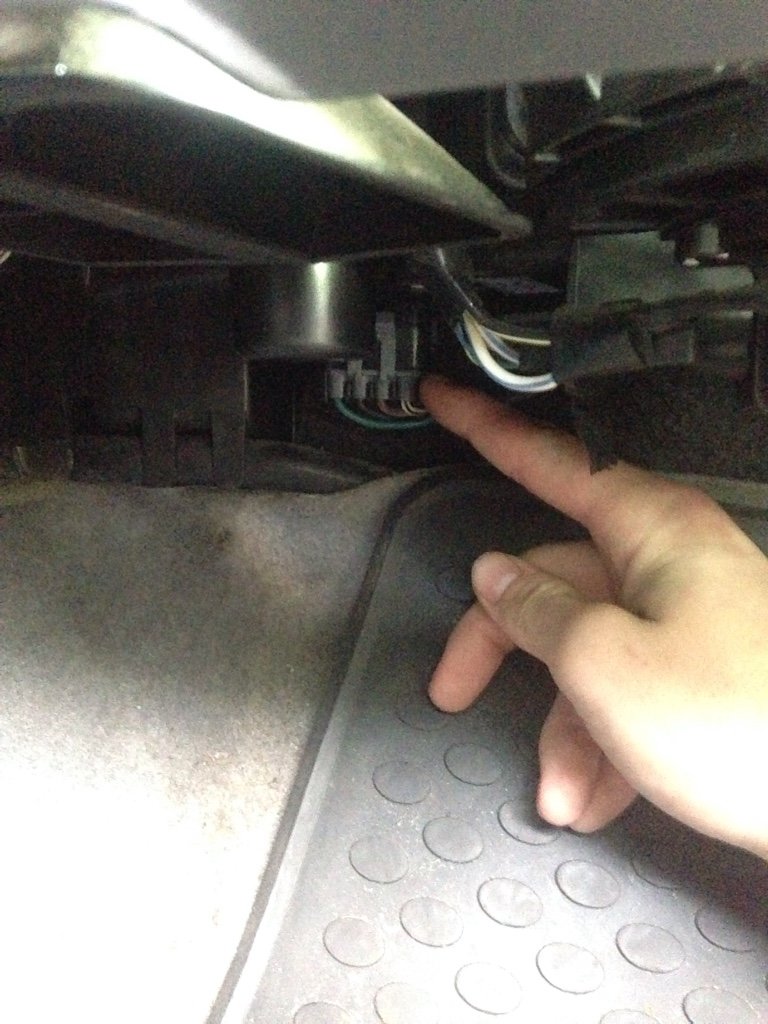

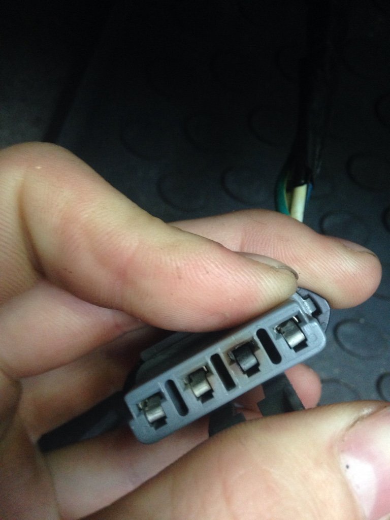

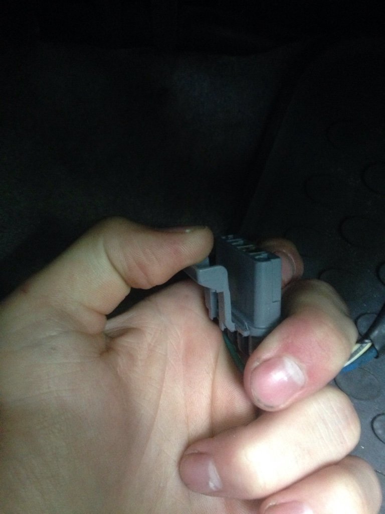

    Now to get to the resistor thing
    You'll have to pull back this clip and pull it out
    Take a pick or something to scrape the inside of each one of those
    Then because your not getting cold enough air got get a recharge kit from advance it orielleys it wouldn't hurt it to be recharged. Takes 5 min
