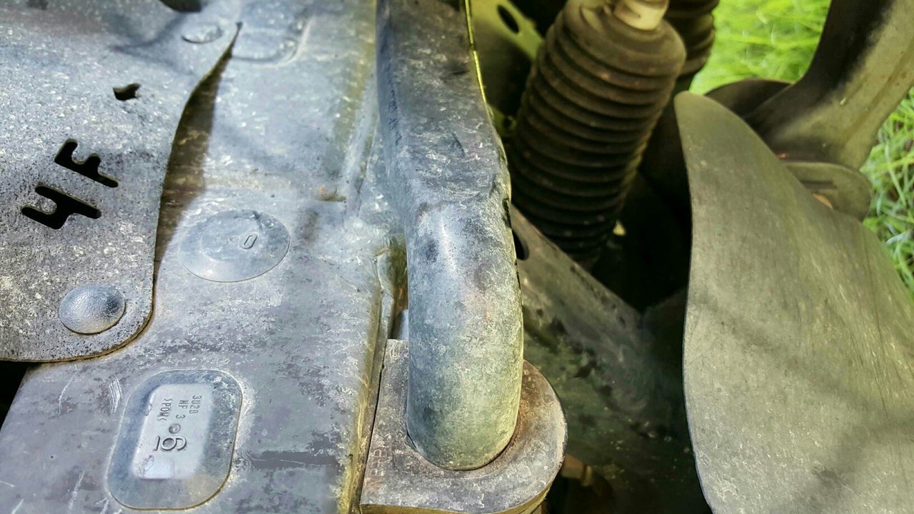

    Take the sway bar off?
  2. Jun 13, 2015 at 7:21 AM

    ‘20 Taco
    Yes

    Oky

    X2

    How come? (So learning can occur)

    More flex and better ride

    So both the silver part and the black bar come off?

    Unbolt it from the spindle and take off your skid and fish it out

    you will def get more body roll. Depending on what coils you have. Most guys remove the sway to get more flex. You get used to it after about a week but honestly with just lifting the truck it will drive a lot different anyway. I took mine off after I was already used to driving it lifted and it felt like I lifted it again and needed to slightly adjust my driving :). However, I have always wondered if it will have much effect in the future when I tow a camper or boat.

    you could do this. Or pull an "Eddy" and cut mine in half with a grinder because we didn't want to spend all the time fishing it through lol.
