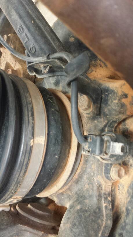

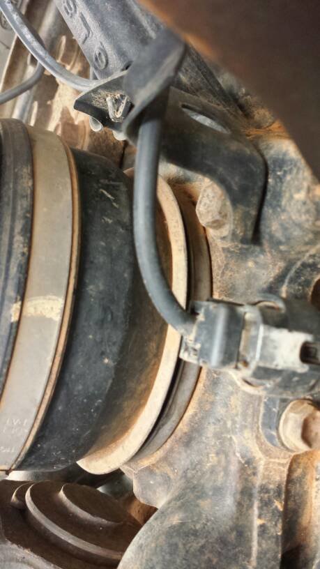

    I got the dealership to install a cv axle for me during my frame replacement, the old one had a torn boot. I picked up a re-man'd from O'Reilly and brought it to them. I've heard a faint moaning/grinding noise a few times over the past couple weeks when I'm reversing in full lock. Not sure if this is related, but shouldn't there be a seal here? (See pic). This is the outer part of the axle where it sits in the hub.20150614_104801.jpg

    The sheet metal flange sticking out if the hub is the seal.

    Ok. I was thinking that there should be another piece that slides on the axle prior to install and fits into that flange once the axle is installed.

    I lied, there is a flange on the axle side too (factory axle).

    Yup. It's missing that seal. They screwd up. I just replaced mine

    Great. Guess I'll be going back to the dealership. Thanks guys

    We found that its cheaper just to buy the cheapest parts store axle you can find and steal the seals off of it. Break it down, snag the boots and throw them in the parts bin for latter. Take the outer off of the CV and throw that in the truck with the truck with the nut. If you break a CV you can leave the inner (cup) portion in the fron diff and pull the rest of it. Put that outer and nut in and you can drive it again without replacing the CV. If you dont have a front locker you'll only be 2WD but it should get you off of the trail and home so you can fix it without having to swap CVs on your back on the side of a trail.

    Cap is right. All the seals and boots are over 140+ buy a CV from the part store for $70 and steal all the parts
