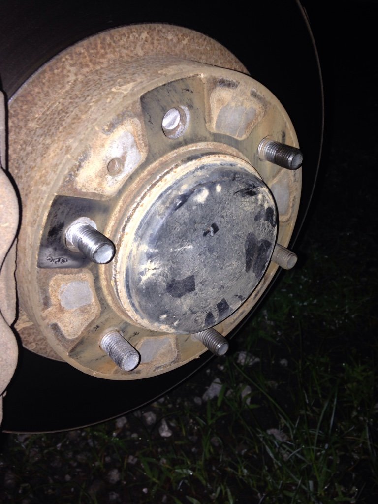

    I'm pulling the tire now to see if they got sheered

    Even if they didn't they probably need to be replaced with longer ones. I'll help you if you need it

    One is sheered and the other 5 are totally fine. Not even a little boogered up. Threads are fine and no marks. Just that one committed suicide and I guess the vibes shook the others off maybe?

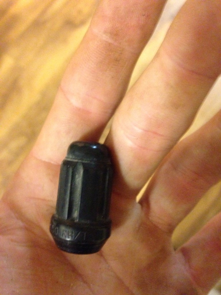

    Did you torque them? Are the lug nuts catching much thread? Factory lugs are shanked and most aftermarket ones are not. You probably have the wrong kind of lug nuts or need longer studs.

    They're shanked I called all around town to make sure of it and they definitley catch enough threads. I'm gonna just replace the one if I can and if it happens again do ARP studs I guess. I really can't afford all new longer studs right noe

    Post a picture of one of the lugnuts

    I did a quick googling and they arnt shanked. They're something else I can't remember what it's called right now but I made extra sure that's what it was

    Those are conical, not shanked. You either need new lugnuts or new studs

    I'm gonna get a new stud and nuts to get me by and replace when I can

    :spy:Boogyman, are your rims alloy?
    cause those lugs are for steel rims!:notsure:

    Are aftermarket steel and alloy wheels that much difference

    As far as I know, the shanked lugs fit the alloy wheels, the coned lugs are for steel!:notsure:
