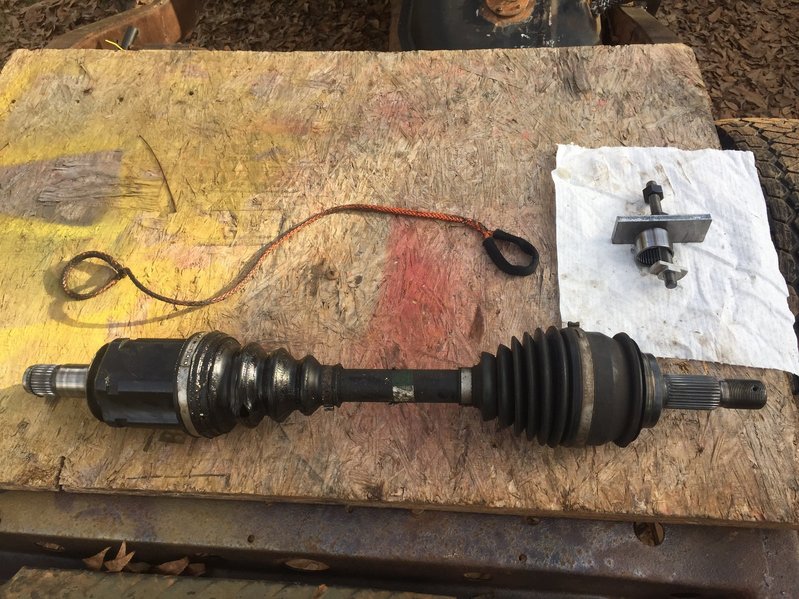

    Yeah it really wasn't hard at all. Once all the other stuff was out of the way, it only took about 5 minutes to get it out and 5 minutes to put the new one in.
    I took off the wheel
    Caliper
    Rotor
    Removed the bolts from the spindle to lower control arm
    Tied that all up out of the way pulled the cv
    And that was it.

    It is the rope in the picture. Pops right out.
