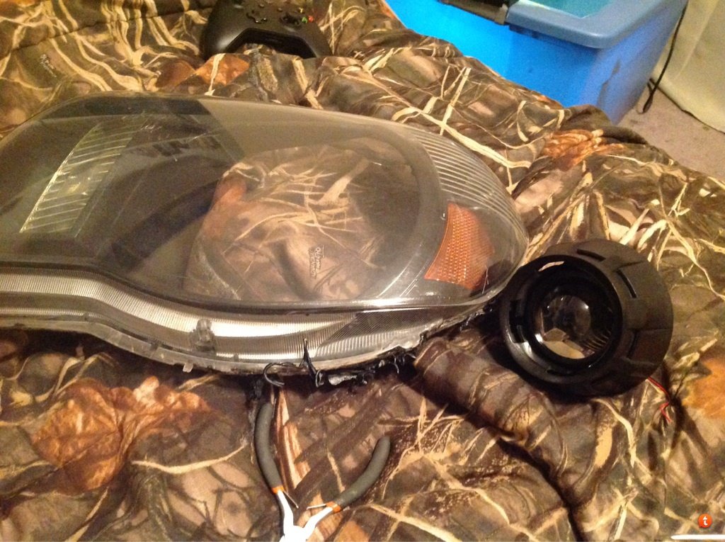

    How do I adjust these when I mount them

    i would HIGHLY Advise that you make sure that they are Horizontally aligned before sealing them as you can only adjust them vertically at that point. Mount them without the lens and wire them up to the truck to make sure they are straight... Ask me how many times i've opened mine to know. I always retrofit my headlights in the morning so it's too bright to actually see the line so i end up guessing.. :(

    There definitely horizontally straight

    if so then go ahead and slap em together then

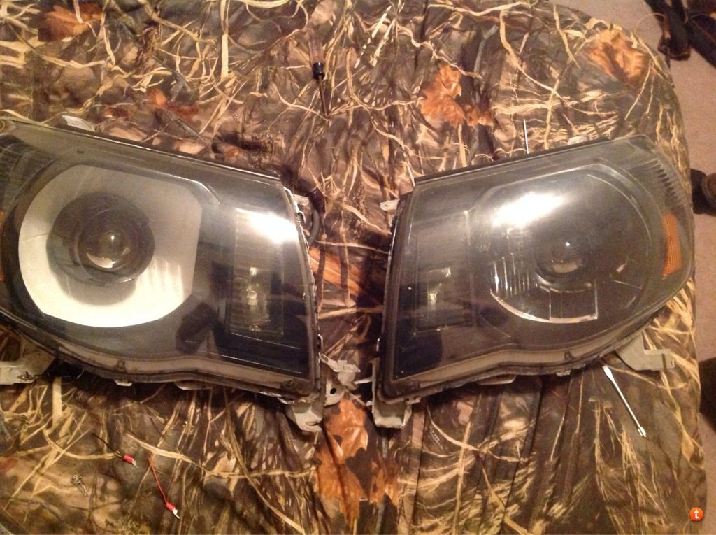

    So much better! Especially on my black truck lolyparehyr_2fb89623598d477898923436e260b211c902a12d.jpg

    shoulda left them white lol.

    They looked like eyeballs and it was kinda creepy

    lol yea i saw

    should have made them red. :rasta:

    You just use the stock adjustment knobs and you don't need a screwdriver to do it. The knob on the bottom is your up and down and the top knob is left to right. Park the truck 25 ft from a wall and dial them in. I forget the ideal height of the bottom of the beam but you can look it up on HID planet I think. I had them white cause I had the white truck and nobody else had it.

    I got them aligned last night at 1am. I used my neighbors house across the street to see where I need to adjust lol I doubt they were happy. The white looked sick on your truck and I tried to get used to it but everyone at work said something about it so it had to change lol.
