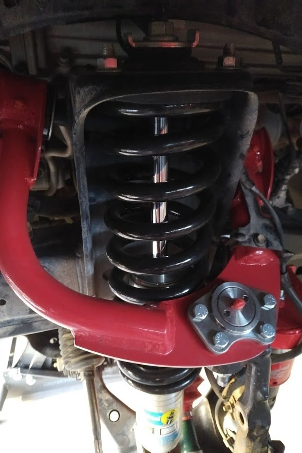

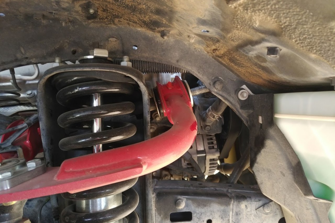

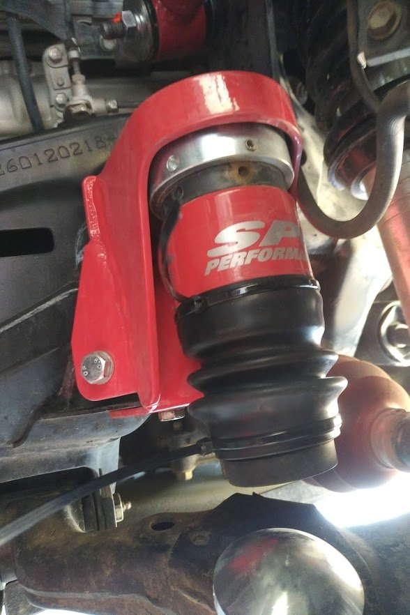

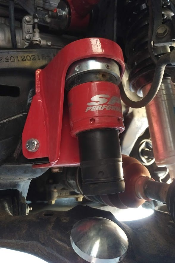

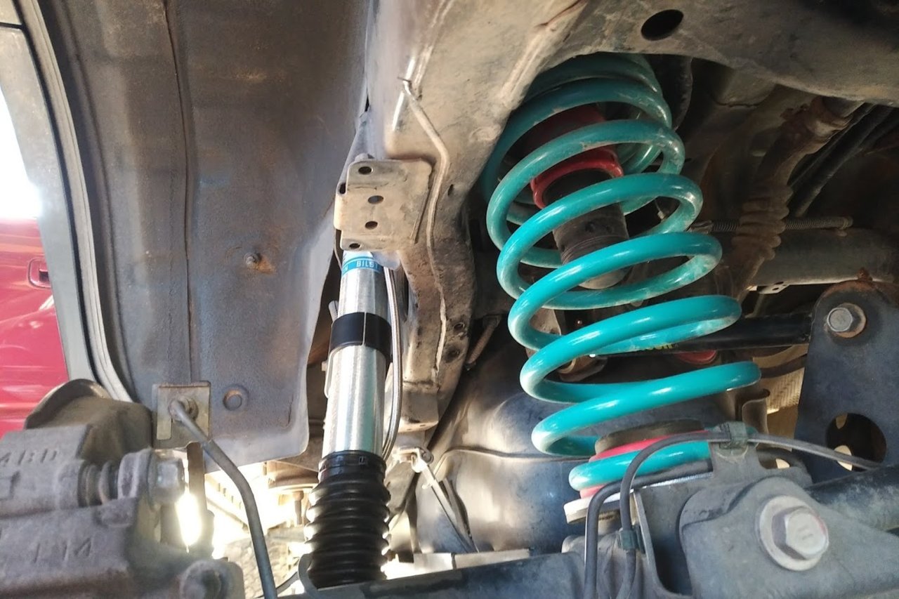

    And then, after 4 days of invading @05tacomabro house, I came back... only cause @02YotaGuy was already there though! :p

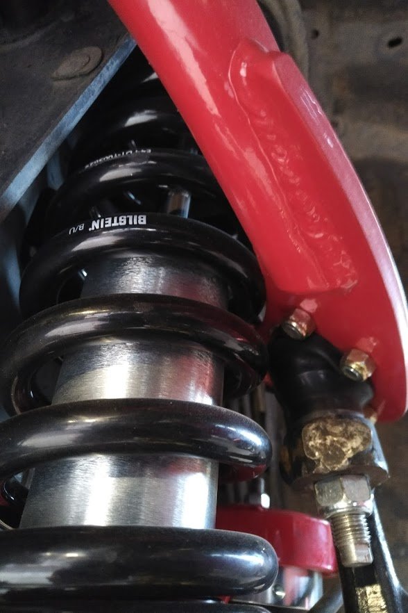

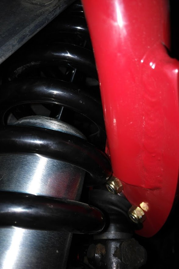

    We put a small (1/4"? idk) spacer on the front driver side to fix a bad 3/4" driver lean I had. the rear could probably still use the last SSO 1/4 spacer to really level it out but I don't want to have to deal with that giant ass Dobinson spring on the driver side for a while. it's just 10 lb of shit in a 5lb bag back there with spring compressors and gas tank and what not. The passenger side can droop enough that you don't need compressors but the upper link bottoms out on the gas tank on driver side limiting that droop. Sigh. whatever.
    We also had to rotate the whole coilover assembly 120* at the top hat bolts because the JBA arms and bilsteins both have so much droop that the UCA was hitting the coil.
    veosL8ItbIzG-JFDNrcaJGvshNK7R0oFJRLCOt8B_ef1c3c1d92a41f2b6e077e5149eac791fa6b6175.jpg
    rADH8BUH_ZFoL-ivRUFs5pON2HxbFTfMTMR4QNpM_48e553e886405ad87e93bfeb629551d2cd536b4d.jpg
    For better or for worse, now the UCA lays down ontop of one of the coils. I think thats better than rubbing the OD of a coil.
    gtCdAapijBhbgAEdyns8ZpoGscAPVWtmUd4kNIXV_e844ea839db81db46f0f8a43cd71e35781bd87df.jpg
    Yeah. Droop for dayz.

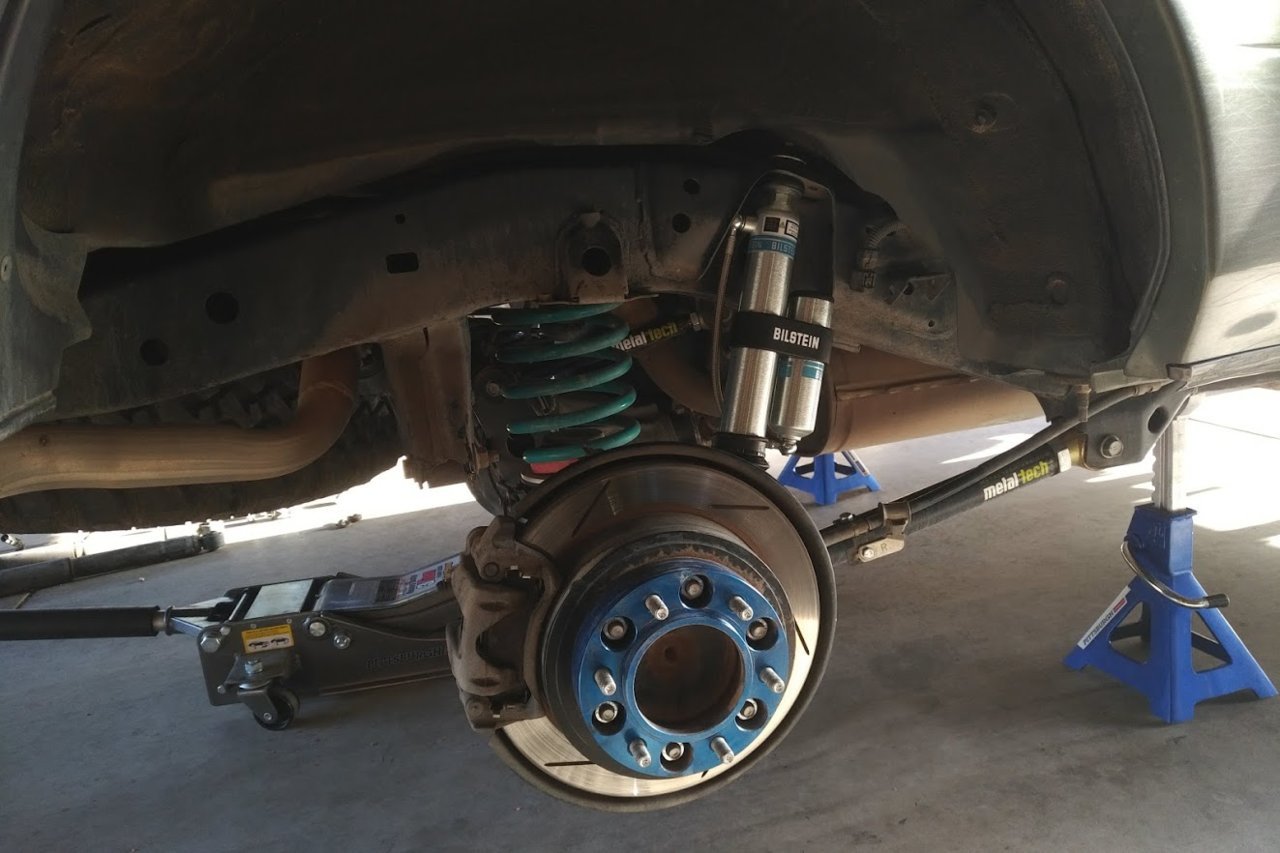

    I also tossed on my 5160's in the rear that finally showed up. the Dobinson progressive springs and 5160s are sooooooo much better than the factory airsprings and shocks.
    bgDsJ5MnuuNk7iepi53d5hdLyYKdmR2anrevGYE5_26217bb2883d12dd0ec4b75d59e8cb508816f065.jpg
    peekaboo, I see youuuuu Mr. air bump :)

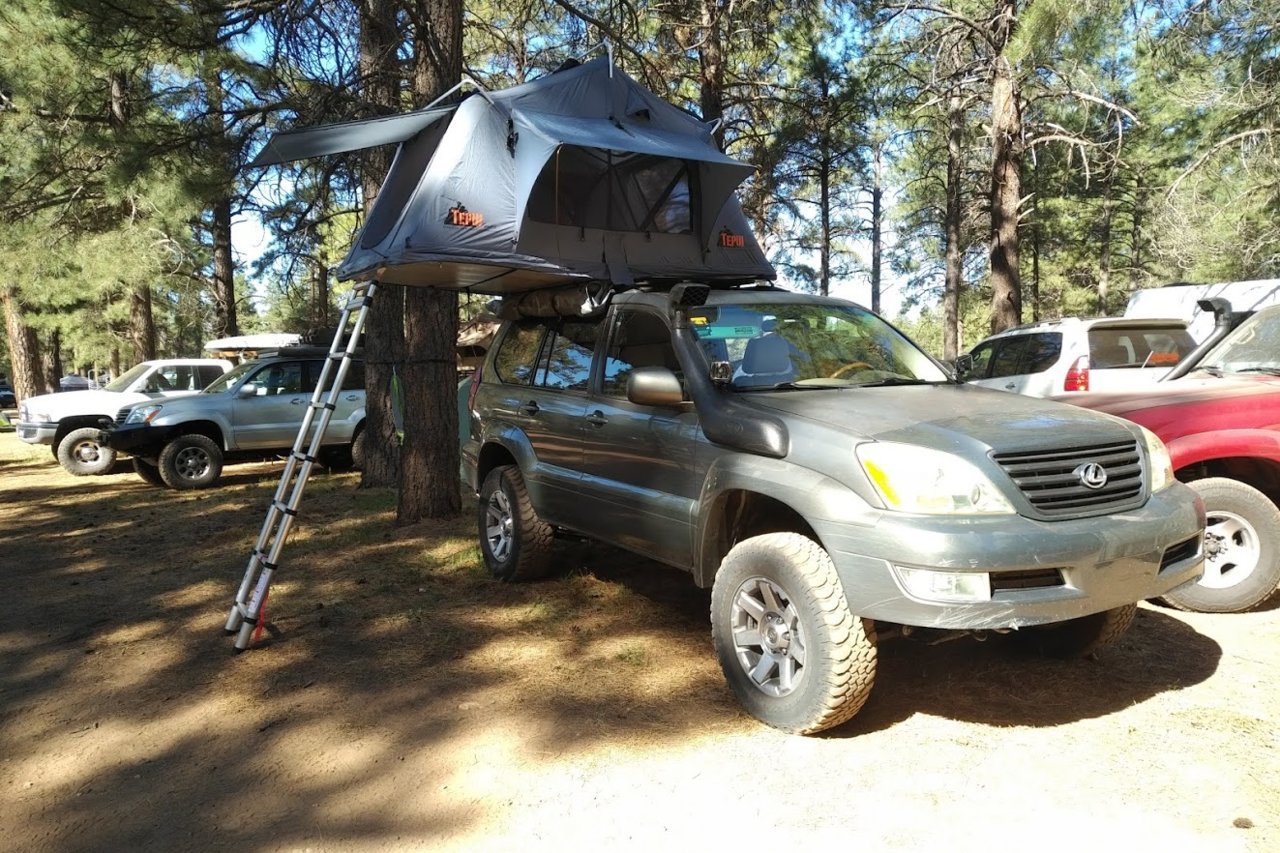

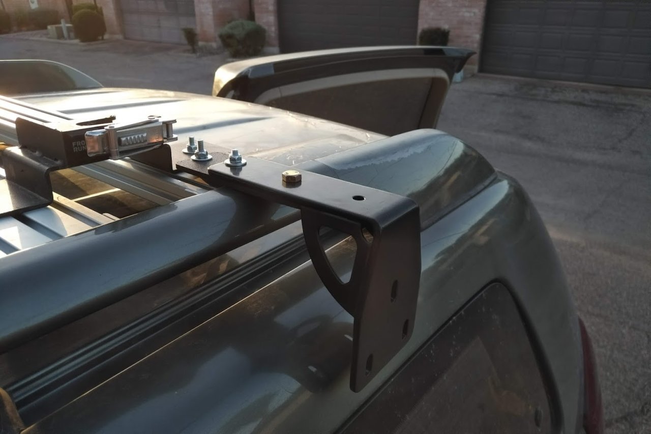

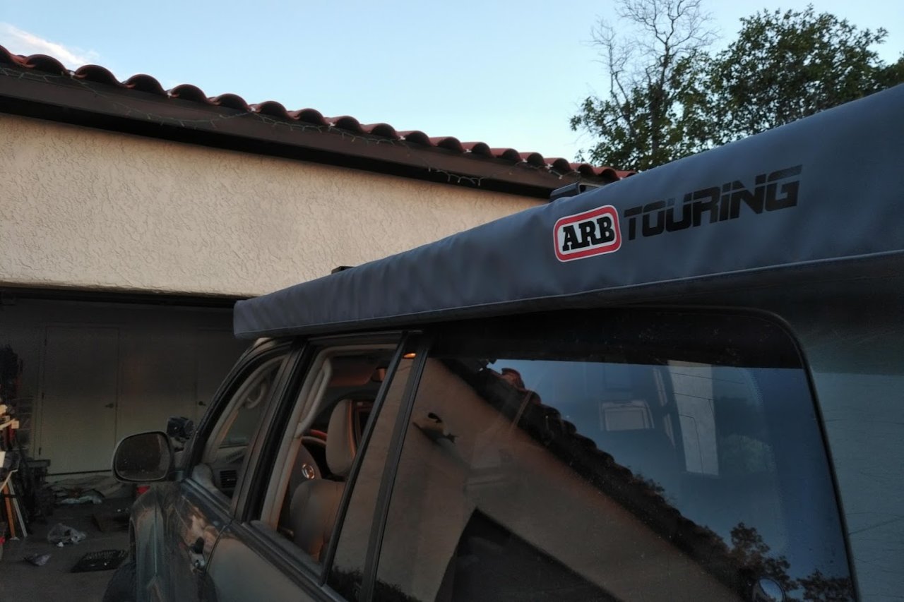

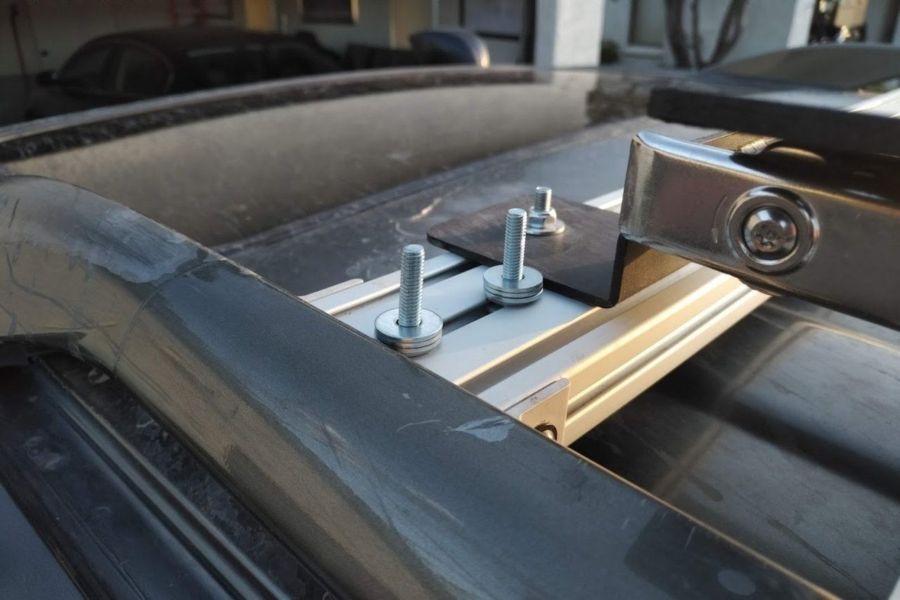

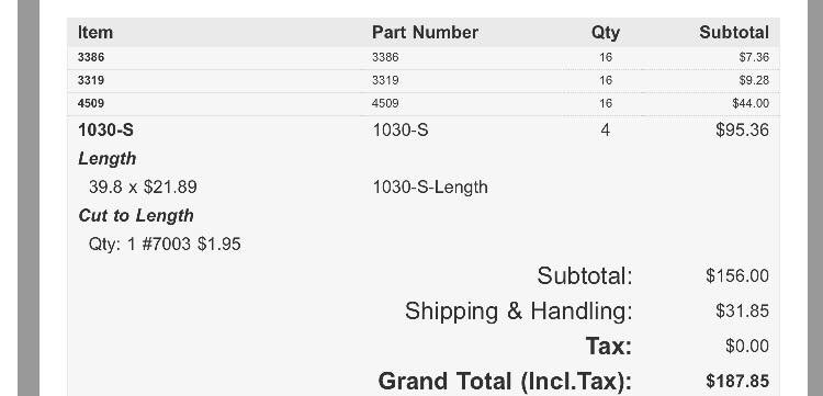

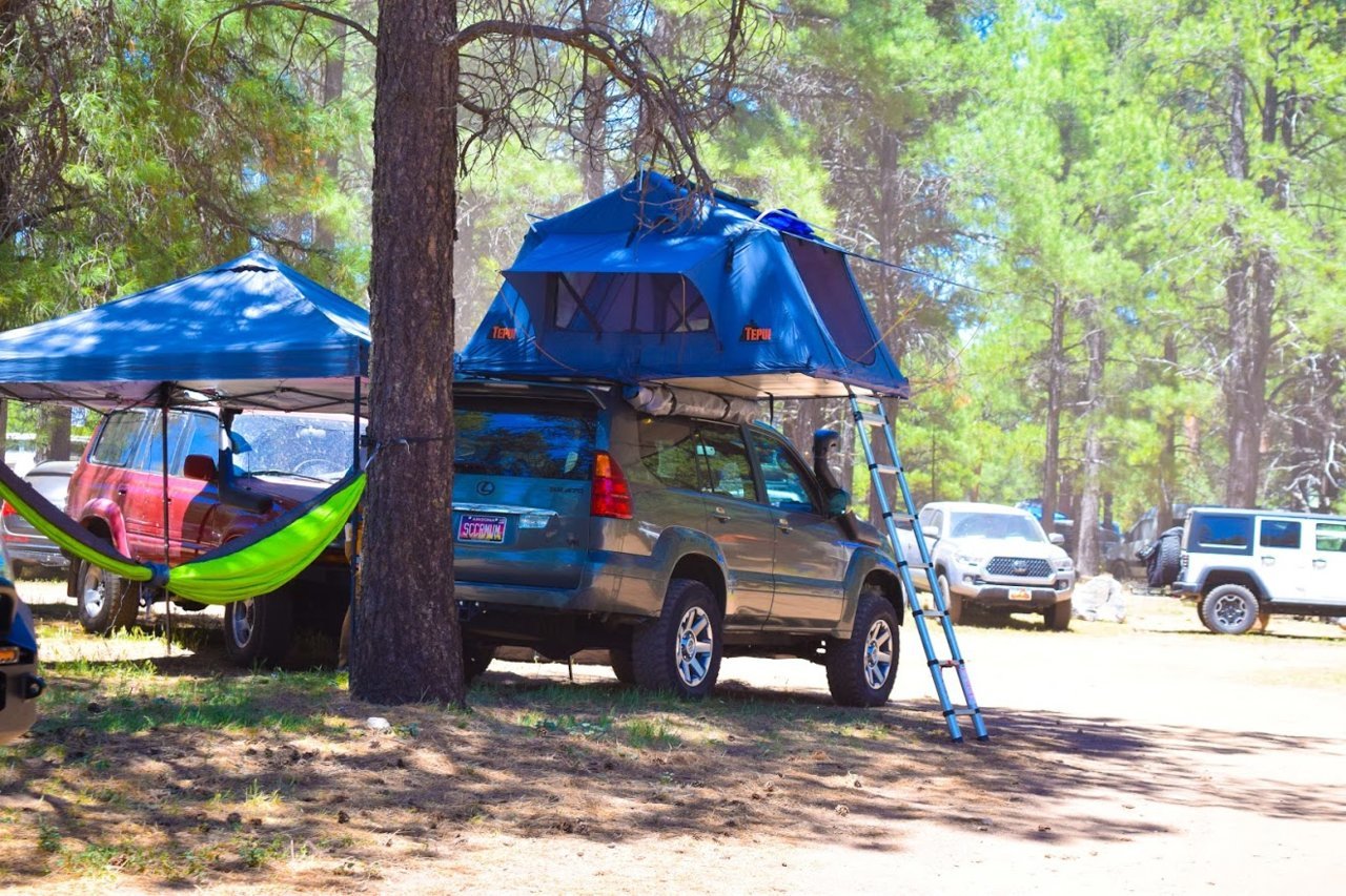

    So no pics really up close but I installed 1030 t-slot cross bars on my stock roof rails and then mounted Front runner Quick release mount mounts. I have to take the tent off after every use to fit in the garage. HOA will tow me if I park outside regularly.
    I will never, ever wish upon my worst enemy the task of mounting an RTT to a stock roof rack on an SUV. HOLY BALLS. my hands couldn't physically fit under the side rails to get to those damn nuts on the clamps for the tent. my girlfriend had to do them for me. It was literally about 90 mins to put the tent on and probably 60 mins to take it off. I did it ONCE for Overland Expo. I immediatly walked inside when finished and bought the front runner QR mounts.
    here's the tent on the stock cross bars and tent mounted directly to rack:
    rboE6FMw-5FWblKhIh6s-nGVQYjZibuiiOSNLz0T_228fad415b6f4cb4cd090c8973a341de6224c3fd.jpg
    About the QR mounts: They are equally or even more painful to mount the first time. It's a kick in the dick to get the spacing correct foreward to aft such that they have enough tension on the latches that they function properly and the tent is mounted tightly. Once that is finally set, though, taking the tent on and off is a breeze. the tent sits kind of high for my liking but oh well. pics later.

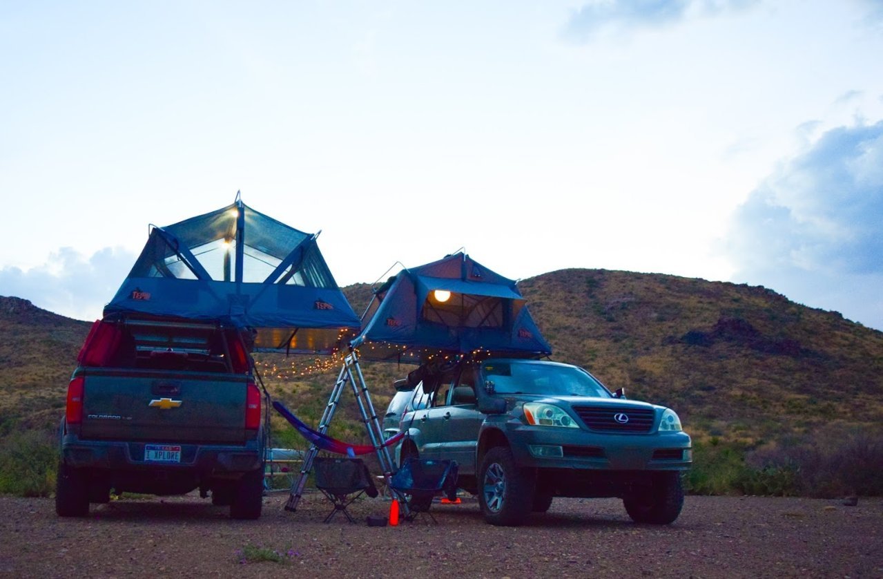

    Here's a way better pic of the Expo camp site. I love driving hours to go sleep in a tent and still hear other people breathing that I don't know.

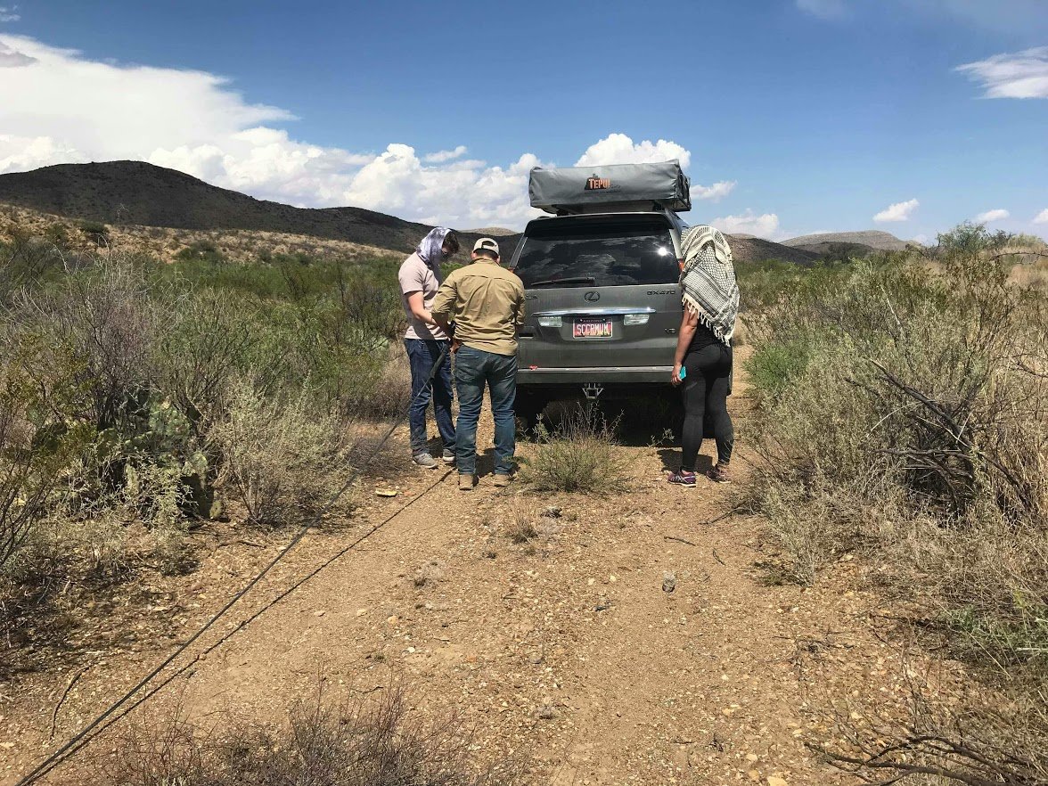

    Fast forward to the next weekend (memorial day) and we went out to Big Bend Ranch State Park in Texas with my same friend Chase (from San antonio).
    We left thursday at 830pm cause sarah had a meeting until 8pm. we drove through the night mostly and got to BBRSP just before my buddy at like 10:00 Friday morning. We went and ran McGuirks Tank loop on the east side in the Solitario district. It took about 30 mins for Chase to get stuck. The ARB Summit bar for Colorados really gives em an underbite. He did a wonderful job at digging himself in. I don't understand him nor others who take the risk just to see if they can make it unclock/2WD ect. Once you get stuck, that stuff isn't going to help nearly as much lol. He was unlocked 2WD initially, then dug himself in with 4WD and both lockers :rolleyes:

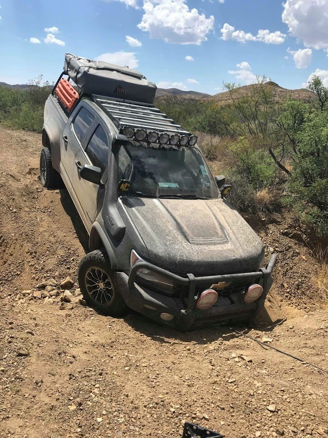

    Doors were dug in so we did a Nascar switch to see if I could drive it out first
    n19aiG2aTDMrOGs4OST6pFePLfYjiEbRBnrsl3X7_b76a344fe52bdd5a2ea1e3183c3d8e56765696a1.jpg
    Then came the winch. No good recovery points on his truck that weren't burried for static strap recovery with my truck.
    j_GSUunP9Ew8BnCSrV8tQs39DLClcbGOPk5Yly-T_55486785d5e572540dfb45d591741f447afd3150.jpg

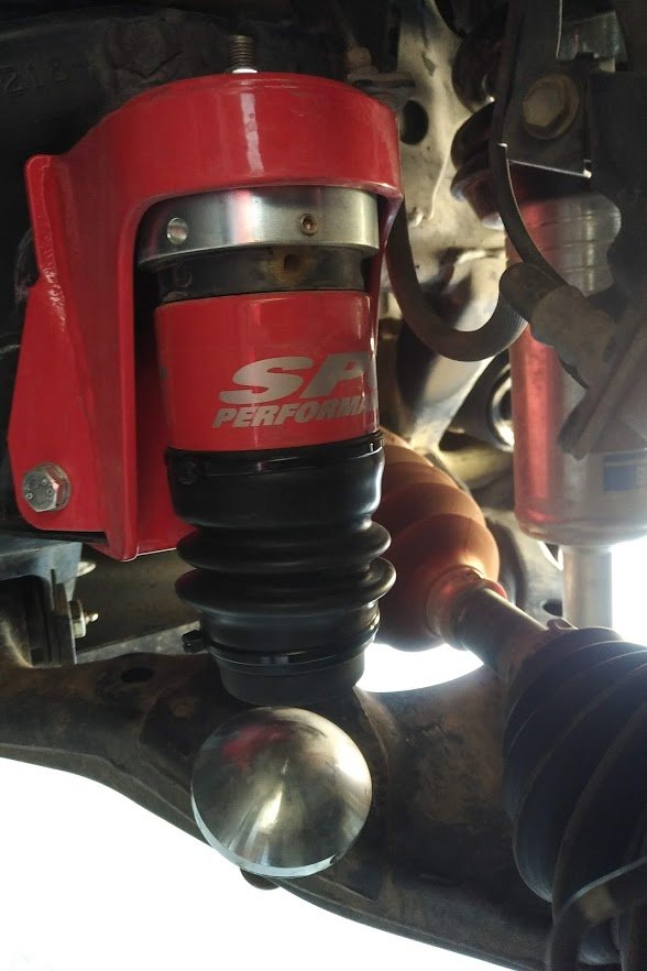

    Just Yesterday I did some quick work and finally put on some Dust boots on my front SPC Jounces. Bryan, former owner of Light Racing, told me these jounce packages met GM durability testing for 80k miles no upkeep when they were spec'd for Border Patrol 2500 trucks like 10 years ago. I see why. What other Hydro bump has optional dust boots? (even if their cost is borderline extortion at $37 each).
    RyDYgqm9-Z7YUW_RXpoDXHruumQW-wd4DJ3Tr5js_be41ddd4b4449c53aacfe41555e6a1dd90fd6bdf.jpg
    CUUZilPCBiHkpWjzPfiNeIiL6DPpLtXQYJvhIh3D_c69c04fa0b6bb298580e0190b46b518d6bae9550.jpg
    10VtHwMEy4l5G7E_wMGvObmKhjvO05xkkXEkOPDS_c765c6765a92c08d5b92735b3a92c41050a88c5e.jpg

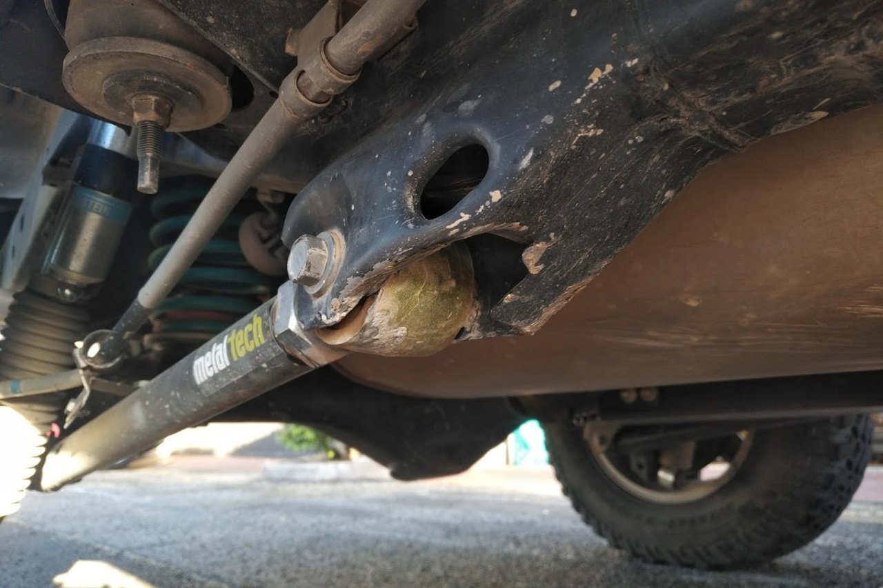

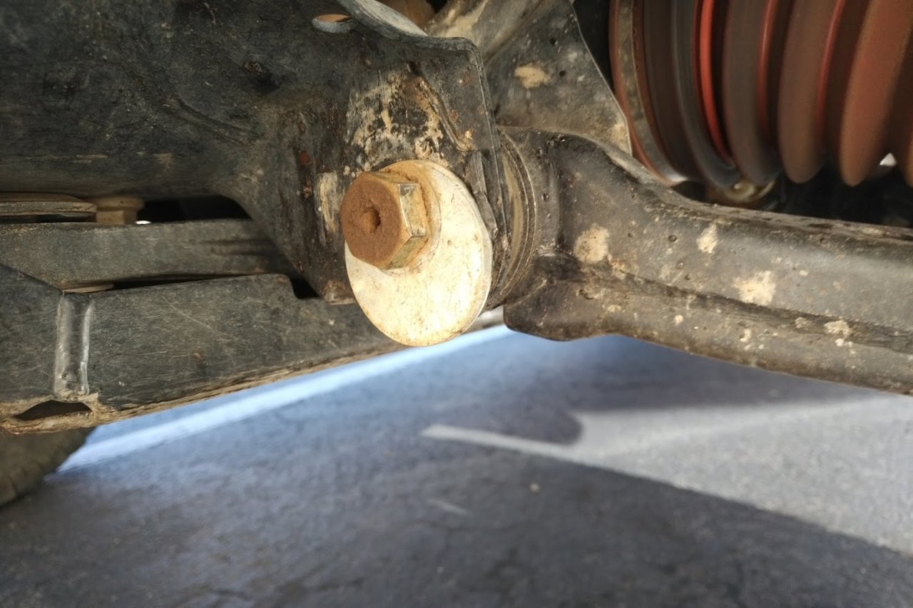

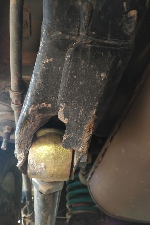

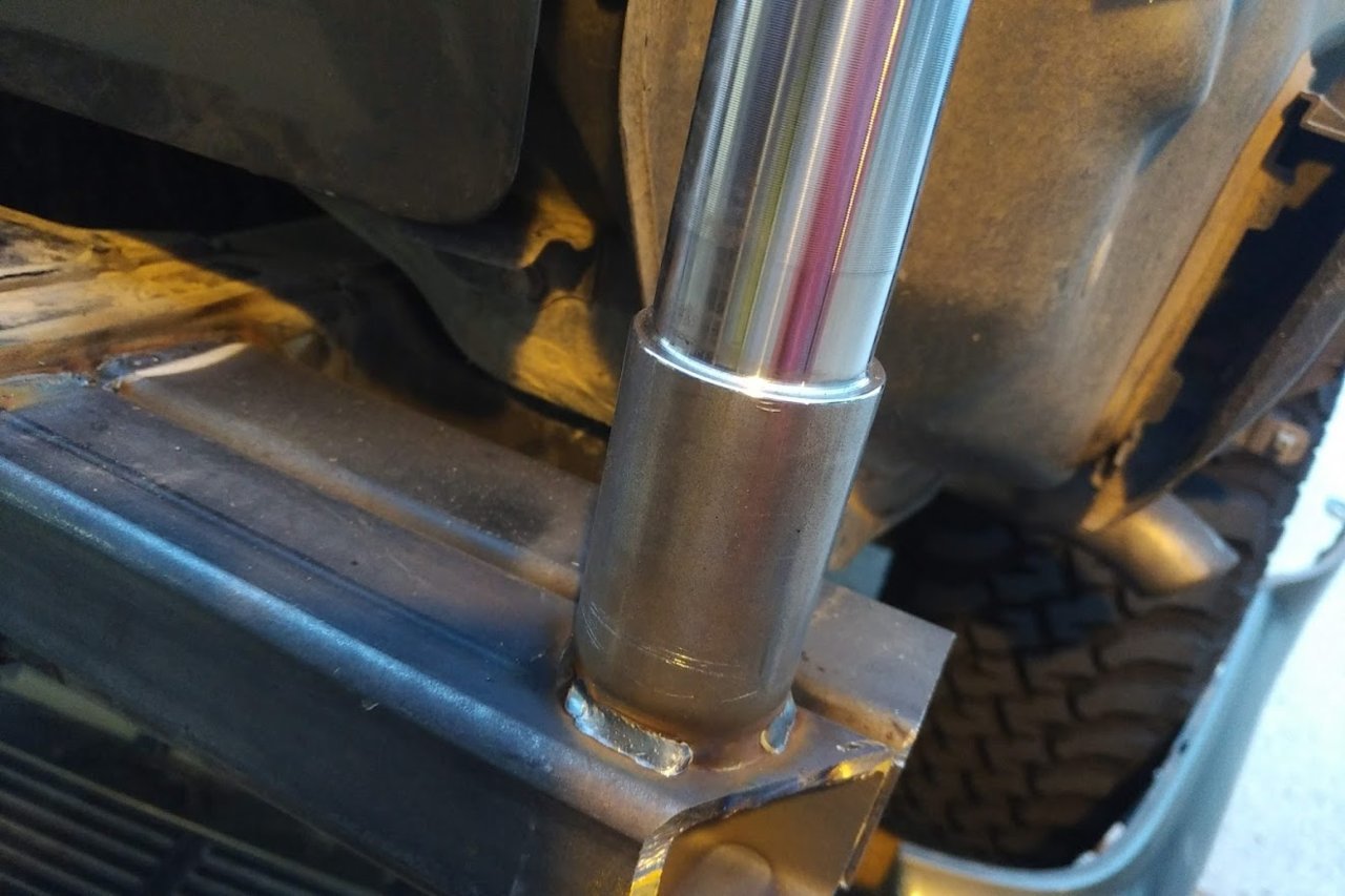

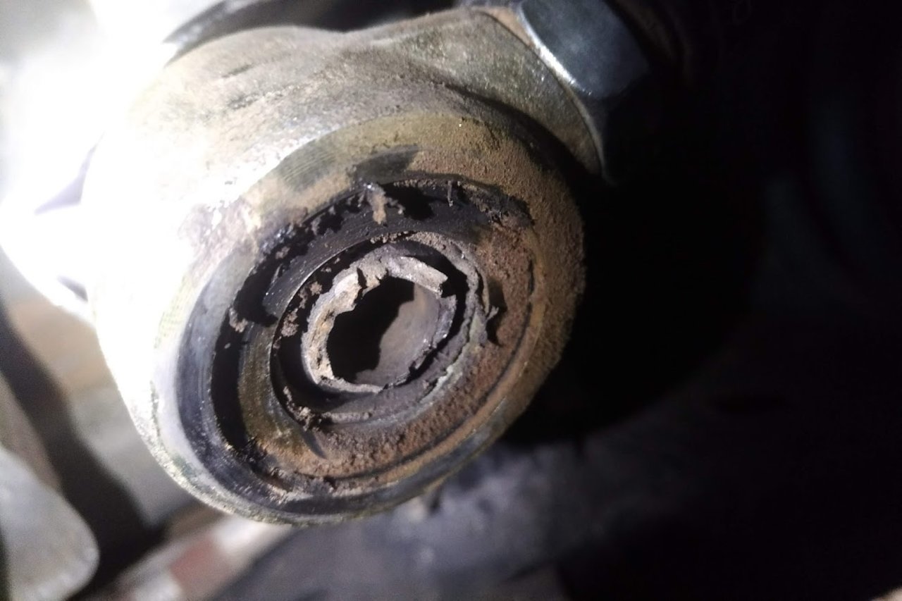

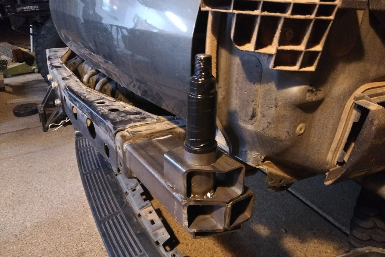

    Oh and on that Powerline trail coming back from Expo, I laid my truck down onto a massive boulder backing down from a failed wash climb the first time. I made it, but my passenger side link mount got crunched. Planning on probably having Ballistic Fab here in tucson weld on some of their HD link mounts onto the frame. Eventually.
    px-GkU5DhWzS0t0cpmM6sFM3qtedGdJ4fx_3yj5C_18200df56e5a1788e792bf6d6a508baa5248b5a3.jpg
    I8HQO5Vzr39JV9lh3W0xCG8dMusNQE8gDeSd6RwA_3d198a61504ae4c03c6d59385a802d45d457d364.jpg
    Notice the fold above the link bolt. Sigh.

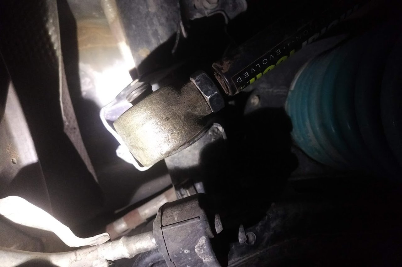

    Oh Oh Oh, also, one of the firestones here did an alignment for my lifetime alignment and the tech must have been green. They aligned it with the cam bolts upside down and left them too lose so they bent my cam tabs. Ballistic Fab here in Tucson laid a quick bead on them to reinforce them for the cheaps. Really need to get myself a welder considering I can Mig and Tig...
    o-BMDHIrx2baSX2kJZkD7yA9tmR1fMteUp-4lCPV_dd2b96c7ca75763b5982b96e97a30425455306b8.jpg
    Then after that got buttoned up, I kept trying to track down a rattle in the rear. Finally found it. Jonny Joints aren't suppose to look like this after 2 months!
    jHM9Ejt3MDWWPKsvV9l2krD6Li0l0fzInFxUzY4C_b4a132008865e832fe7493f0c045d0bd5193fdb6.jpg
    UdoKMZ1_6vRCDq8rodHn8Rrums5kiTUOxErdIAQm_02dec660f6f911495bf752a7f419c02dc0fe69bd.jpg
    MetalTech4x4 sent me a new Jonny joint for free as a warranty coverage, along with a MT4x4 glass and a "Check your nuts" patch! they said they've seen this happen before when the bolts loosen and cause the joint to load wierdly since its loose in the mount. I had already replaced every single link bolt with nylock nuts after loosing lower link bolts twice. If you have a 120 chassis and upgrade/change/replace the links, USE NYLOCK NUTS. I told MT4x4 they should include nylock hardware with their links so people don't reuse the stock stuff. They said they've thought about it but are worried about the extra $5-10 bucks added cost making them uncompetitive in the market. My suggestion, worst case, is to eat that cost. Buying the hardware in bulk from Mcmaster won't be that much cost to eat in your margin.
    (Thanks @05tacomabro and @Brindybot for bringing me a nut the second time when it was on trail!)

    2INInzE2RLG_QoNIyNzTi-KOUUZLAy7G2cQ_sYMW_b72685fd328bfe6a498037ef9ffc3d85b29b2354.jpg
    where we left it after worknight #1:
    t9UZIBgAQtoYDMe-nohSfwNKWK4MGVfMfEIuWqKL_8dc28e1e81c1bb5e97b9a46a9384dce2ae4f46cf.jpg

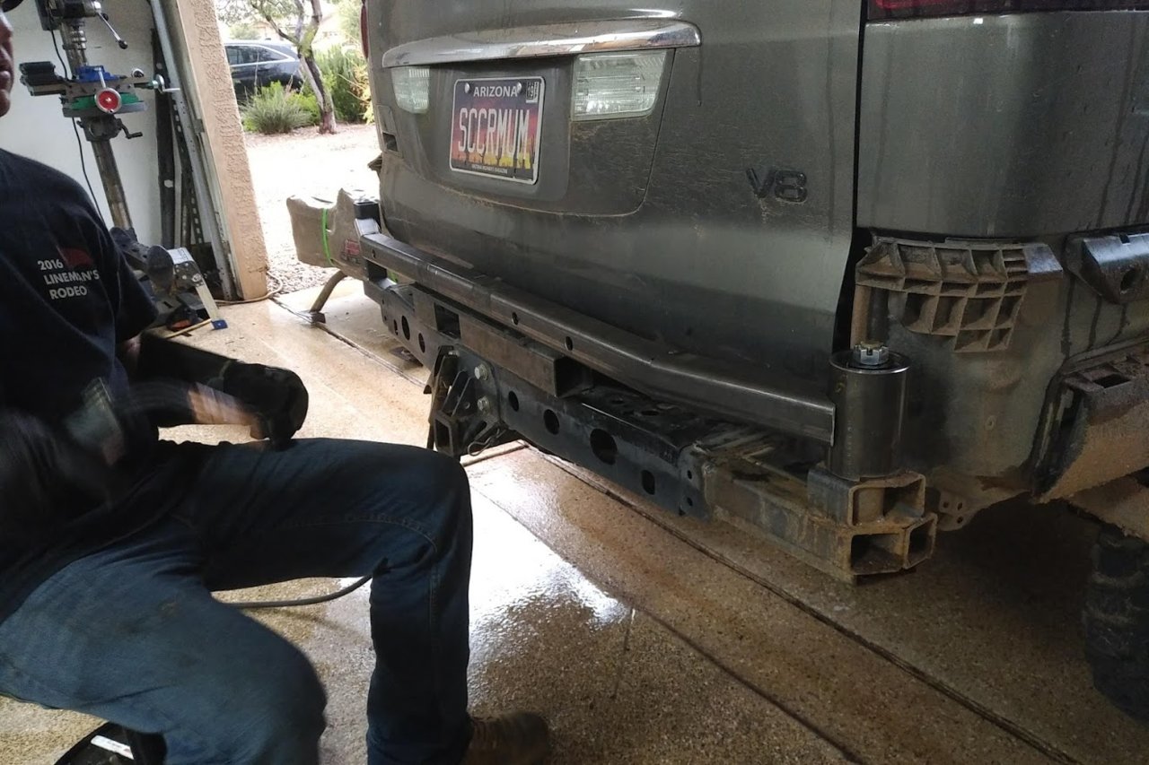

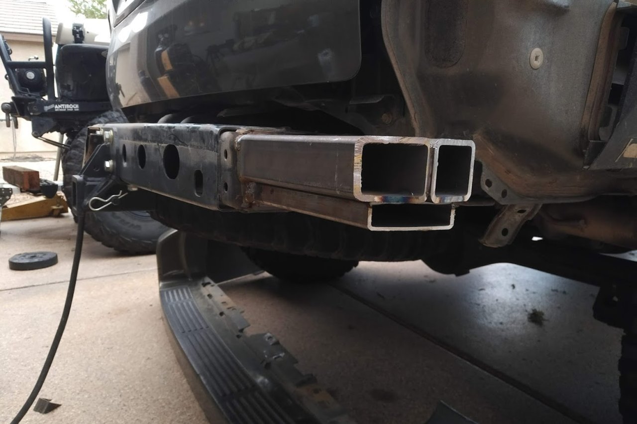

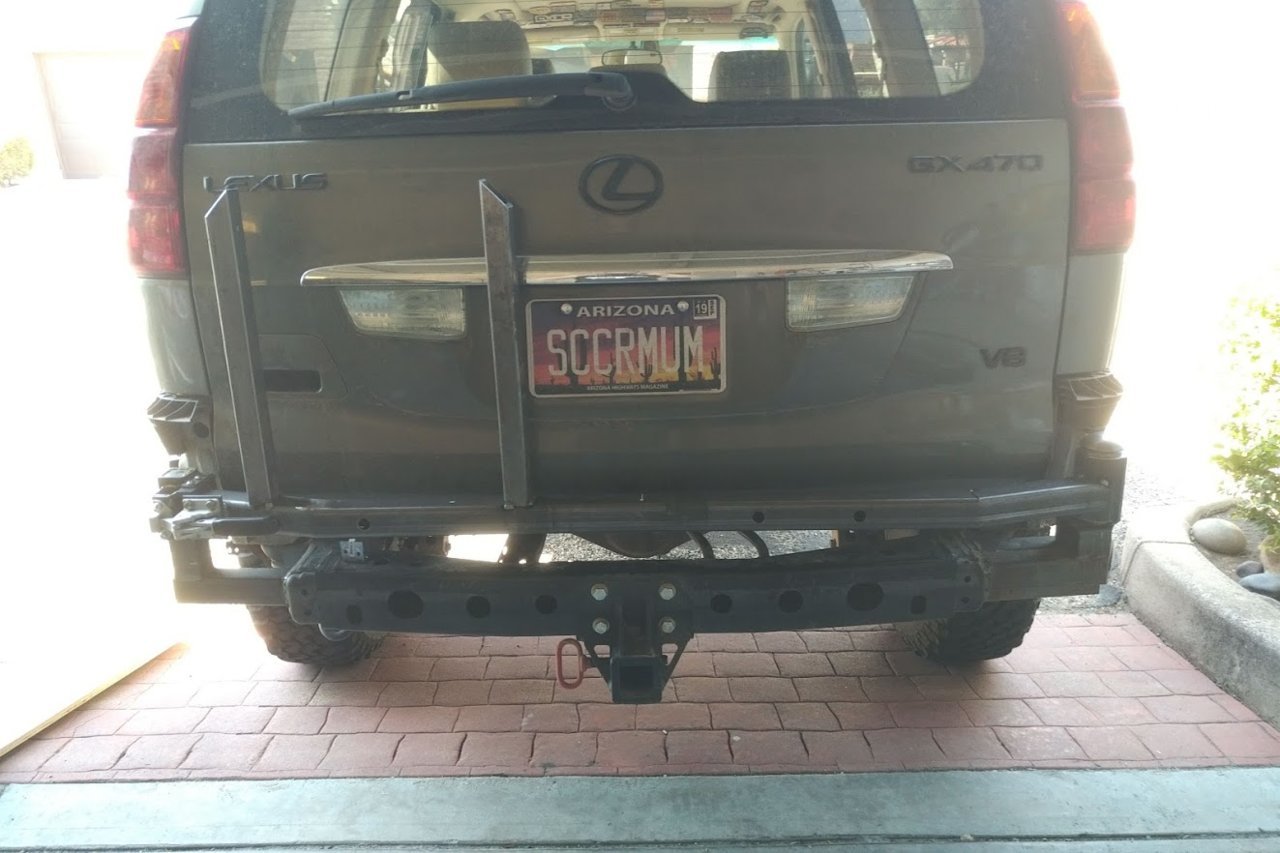

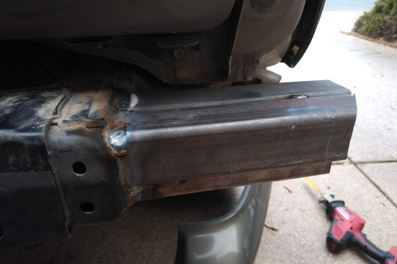

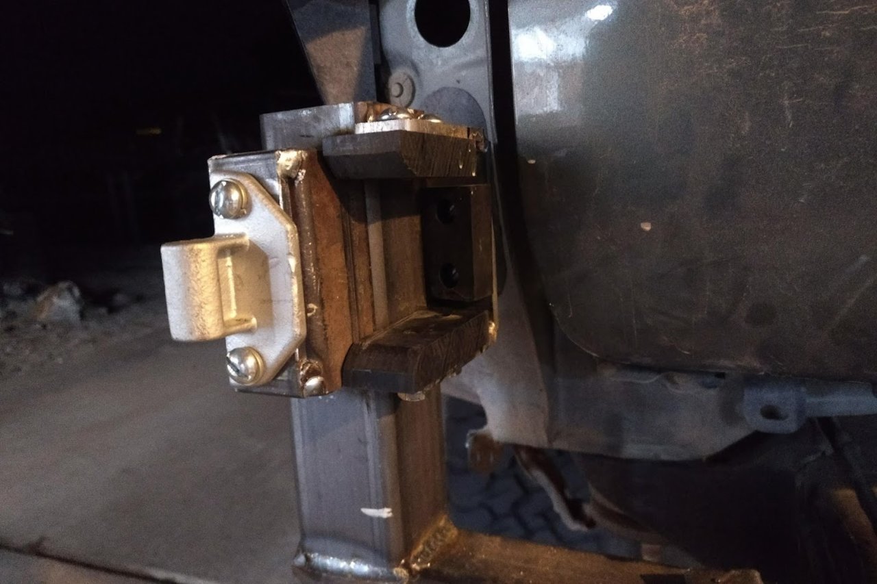

    Night two we (he) cut and bent the swing arm to follow the curve of the hatch and tacked it onto the spindle sleeve for mocking up, as well as started the receiving side.
    SruIDd1ospxHEM4YZ3ZXGt0i3l9J7YH_QSKxp_b__52c32ef754c90cf6ce552465c722e9f6f5482145.jpg

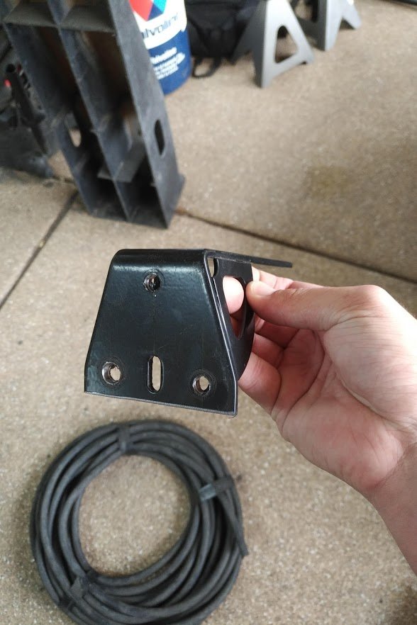

    Day 3, started getting the recieving end finished with rubber bumper, latch, and delrin feeder slides top and bottom to fully seat and cradle the arm:
    aoSaQsISvrghcv93dUBXG9zecmF1u_XO6YP76x_m_1cdc2d33259be35cdf0fbf3fba95173c325c7135.jpg
    NGloqsmj2_bbDHF5K645KlrxFIdqllZt3_OsL0wm_a067ea84ad0e29e8665327168918ac3f193872c5.jpg
    sKpwsXChRtYjoE119giWOpUieZ9OKHqJLwUuHzE6_3349a0862f027ebdfa90b1a70f96dda8e4fecade.jpg

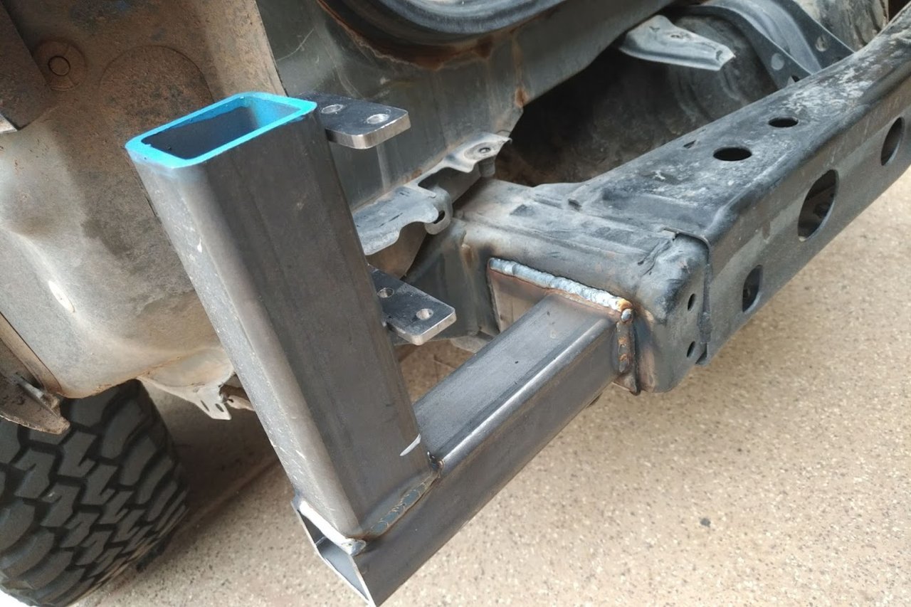

    Also started the mounting frame for my dual Jerry can holder. The Driver side bar for the jerry can will also have a plate on it to mount my 5lb propane tank for the stove.
    0PHJH-hgMehlrbQOCSmHq_cAzupgnn9Ylge1LxCg_3e6f37d4ab8c70f97e58da71f6021d84b00b9dc7.jpg

    Also Got the awning mounted, finally. I lost my CAD license so I had my buddy whip up the CAD for extention plates to have Ballistic Fab cut on their laser CNC cutter. the ARB brackets were not long enough to clear the roof rack side rails. I need the ARB corner brackets to face down because I won't fit in the garage otherwise and HOA will tow if parked outside. so wow. Much communist.
    so ballistic cut them, I painted them, assembled everything, and found the awning hung about 1 inch too low and impeded door function.
    Washer stack on the carriage bolts to level the surface with the side rails:
    9-u7r0RmABDiim4csrSPpa1YaTG74Aqksh14vbDr_02d4b278b477f601f2a5ed0e88e7b1587c85a2ba.jpg
    The middle M6 bolt overlaps the ARB bracket and the custom extention bracket:
    yHnHNi2tznnz58Zm7BpqOjgM3ZmdXwHx1CArjVmN_0b48aa741ae564fa571d2c3b3476d252755158a4.jpg
    Because of the bit of sag, The doors wouldnt open and close without holding up the awning slack. I'm holding up the slack here:
    wN0LK-YjLRkOA2HU_a2BpZ5rIugkf6MMKjGDBVvz_eccacfa3a07c11b1bc6a8cfaf47cdde3de631680.jpg
    so I marked the ARB brackets for new awning holes 1" higher than the original slots allowed. Then chopped the bottom half of them off since it was uneeded.
    RekcpulSHtqFGxGv9TEbWxw-2qkTxnwcFEn8Oc-__268891da220ae04accc987106b10a133bca5366f.jpg
    Got it all mounted up at Andrews while he did productive work on the swing out:
    yJTfvW6iMQBBLqtZDynO0oKnTuQ8OktZ_Qk39SNN_ad751a5a3b7e6c6b44392e09a7820adeed082094.jpg
    I kinda regret not going 8ft awning but I was worried since 1/3-1/2 of the awning would have cantilevered forward with no support since my stock rack stops behind the sunroof. now with the 6.5 my driver door isn't fully covered so it's not as ideal for rain coverage. Sun coverage is still very much there ,though

    What did you do for your rack crossbars? I have not been able to locate any factory style ones anywhere and I see you have made your own.
  18. Jul 22, 2018 at 10:41 AM
    #58
    NudeLobster
    NudeLobster [OP] Well-Known Member
    Jan 18, 2017
    #207914
    346
    Justin
    Tucson, AZ
    2006 Lexus GX470
    31290699_10156092338730751_1170916992375_928776b3e7a295da4b4bb814f5f7e97d8ebe0b50.jpg
    Cut to 39.75" or remeasure your own, 39.8" was a bit tight! I recommend 5 cross bars if you're going to mount anything but an RTT to it. For RTT you only need 2. Or, if you want cheaaaap, you can have my stock cross bars!
    llibrm[QUOTED] likes this.
