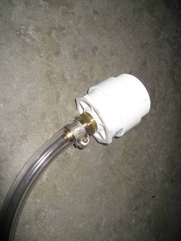

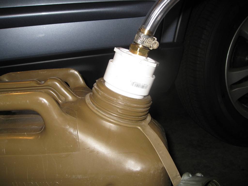

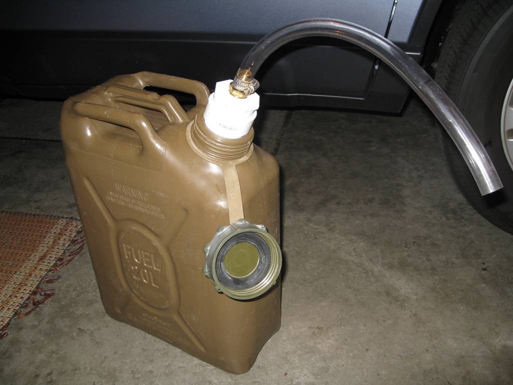

    I came up with this after numerious failed attempts to use the clamp style spouts for the plastic Scepter jerry cans. I also wasnt interested in the ~$30 price tag on the fancy ones Scepter makes. I posted this over on ttora over a year ago, iv been using this thing regularly since. No issues at all.
    [​IMG] [​IMG]

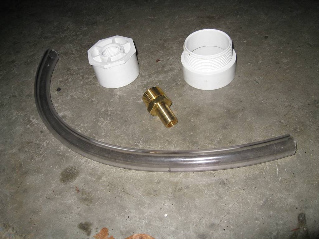

    Took some measurements and headed to Home Depot. Came back with the following parts; 2 PVC couplers, and a brass nipple. I had the hose already along with the hose clamp and epoxy. I went this route so I would have something to grab onto when tightening, and not to cover the little vent hole.
    2" adapter: http://www.homedepot.com/h_d1/N-5yc...Id=10051&catalogId=10053&superSkuId=202905023
    Bushing: http://www.homedepot.com/h_d1/N-5yc...splay?langId=-1&storeId=10051&catalogId=10053
    Brass nipple: http://www.homedepot.com/h_d1/N-5yc...splay?langId=-1&storeId=10051&catalogId=10053
    Hose: 5/8" OD?
    After assembling with fuel resistant epoxy, I assembled the brass fitting and hose.

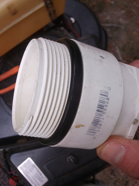

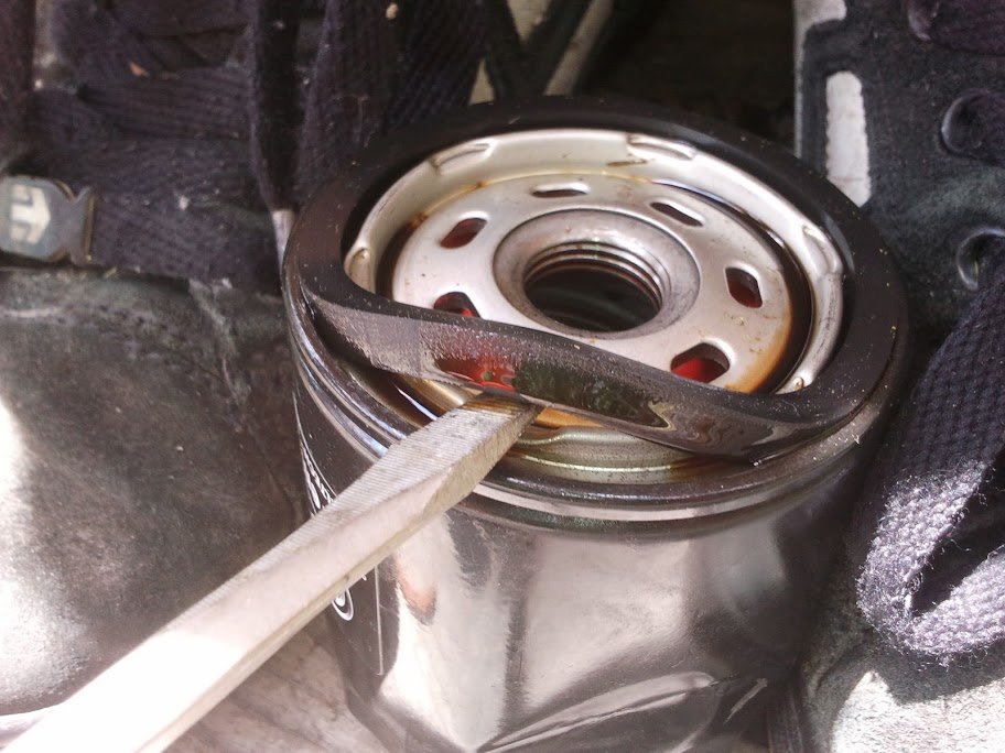

    The spout is still working fine. I added a big o-ring to the threads so I didnt have to screw it in so far. One of my can's it gets really tight. This solved it and keeps it front leaking if you leave it lose.
    o-rings came from an old oil filter.

    The spout doesn't block the air hole so it empty's extremely fast. Its your standard run of the mill pvc threads, I matched it up using some tapered steel pipe.
    The pvc is fuel resistant. Its not in contact long enough anyway to cause problems. Been in use over a year with no probs
