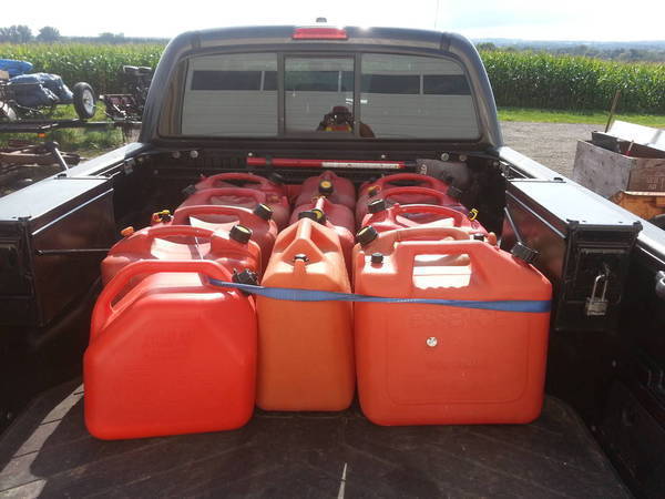

  9. Apr 9, 2014 at 3:32 PM

    lol good point. Unfortunately, I haven't had a chance to use mine all that often, and the time I end up going to get gas its for other people, with cheaper gas tanks.
    I could smell the fumes in the cab :p

    Those all look like Scepters too , just the leaky type of consumer cans :)
