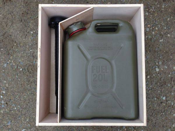

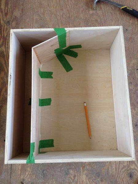

    Made a mock up to check the sizes before commiting it to aluminum

    Test fit
    Seems pretty good but there might be some room for improvement

    Looking good. Would you be making another box for the other cans or a box that could hold 2 or 3 cans?
  12. Apr 19, 2014 at 7:52 PM
    #52
    OZ-T
    OZ-T [OP] I hate my neighbour
    Dec 15, 2009
    #27584
    50,587
    Peter North
    British Columbia
    Not sure yet , that's why I'm experimenting with plywood
  13. Apr 20, 2014 at 5:20 AM
    #53
    tacoma16
    tacoma16 Well-Known Member
    Mar 15, 2011
    #53109
    11,123
    Peter
    Ontario
    Double cab SR5 4x4
    Yeah makes sense before you commit to metal. I'm assuming you would be going aluminum or some kind of stainless?
  14. Apr 20, 2014 at 12:07 PM
    #54
    OZ-T
    Dec 15, 2009
    #27584
    50,587
    Peter North
    British Columbia
    Aluminum

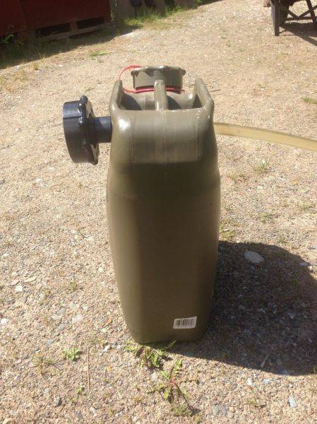

    Just an FYI for anyone else trying to make a mount for the Scepter MFC , it was somewhat warm and sunny here today so I purposely left my 1/2 full MFC out in the sun for a couple hours while I mowed the lawn
    As you can see the can expands slightly , overall thickness when fully expanded measured at approx 7 5/8"
