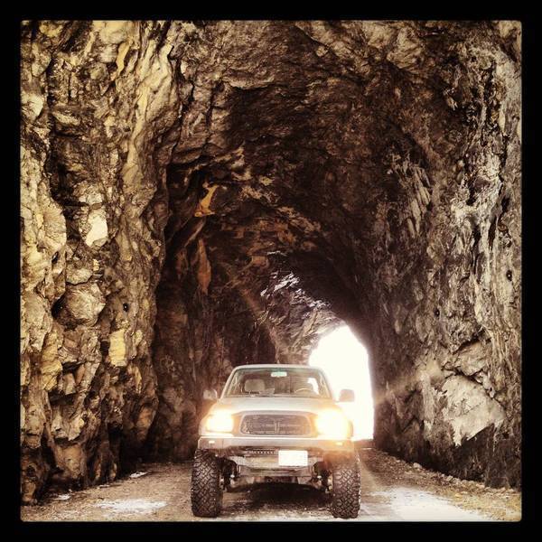

    bed lights, cobra 19 dx cb radio, flow pro muffler
    here's a neat pic from a drive in Penticton
