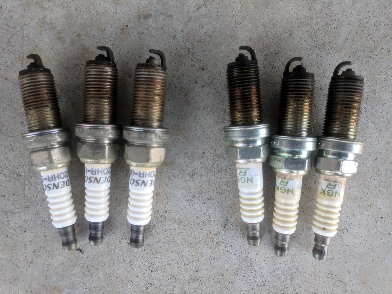

    2005 TRD Off Road w 114,000 mi. I bought it in 2008. Just put on 3" Toy Tech, LR UCA, full rear leaf pack (not add a leaf), and decided to do all the "required maintenance" plugs, air filter, ALL fluids (PS, brake, tranny, transfer, coolant, front/rear differential, etc) new brakes, serpentine belt, rotors, etc.... Also mounted a spare 255/85/16 on stock spare rim under the bed.
    WHAT A DIFFERENCE W THE PLUGS!!!
    I feel like an idiot I thought it was 100,000 not 30,000.
    Thought the truck was gonna jump out from under me!!!!
    DoorDing likes this.

    The fact that it was even running with those gaps in a testament to the solid ignition system. It had to be stumbling at least on WOT. I thought mine were bad a 40k. You should see better MPG too. Still kills me why they came with two different plugs?? Good to be done with all that eh? :thumbsup:
